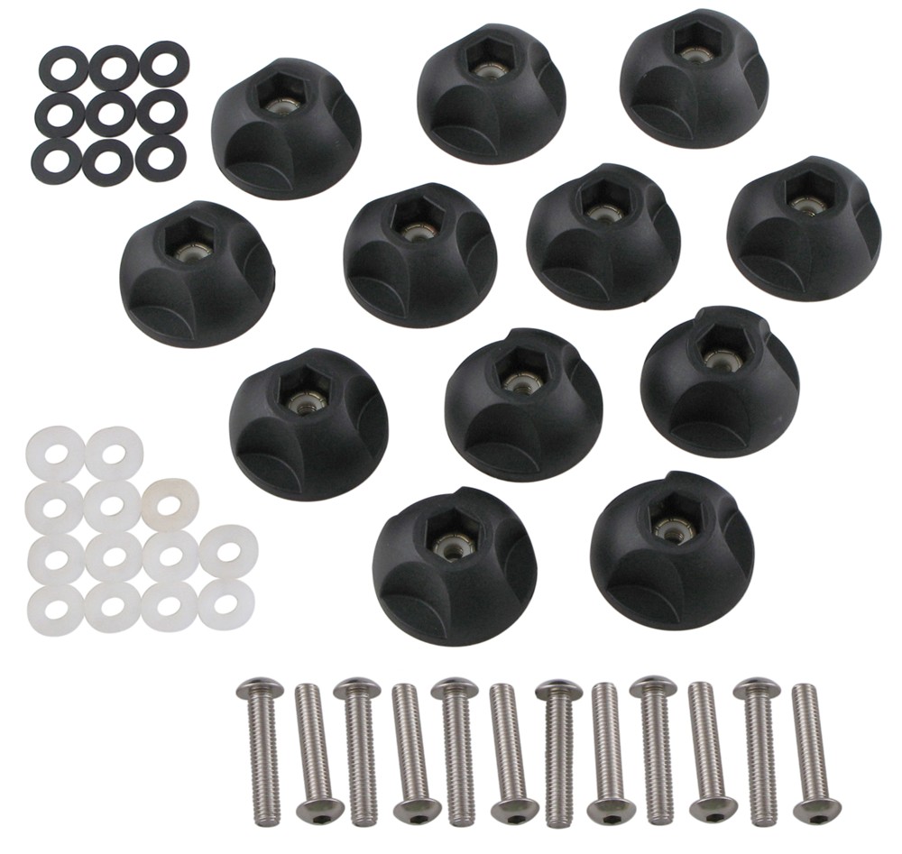

    You can just add them but make sure you get the tracks with capnuts, NOT plusnuts.
    I've had no issues with the weight on top without a reinforced shell. 99.9% @Marty65's shell isn't reinforced either.

    whats the difference between the capnuts and plusnuts?

    Plusnuts only need one layer to be drilled through (think sheetmetal roof) and compress like rivets when tightened down. Capnuts need to be drilled all the way through and held to be tightened. Can't use plusnuts on fiberglass shell...
    PLUSNUTS
    CAPNUTS

    Thanks! That makes sense.
