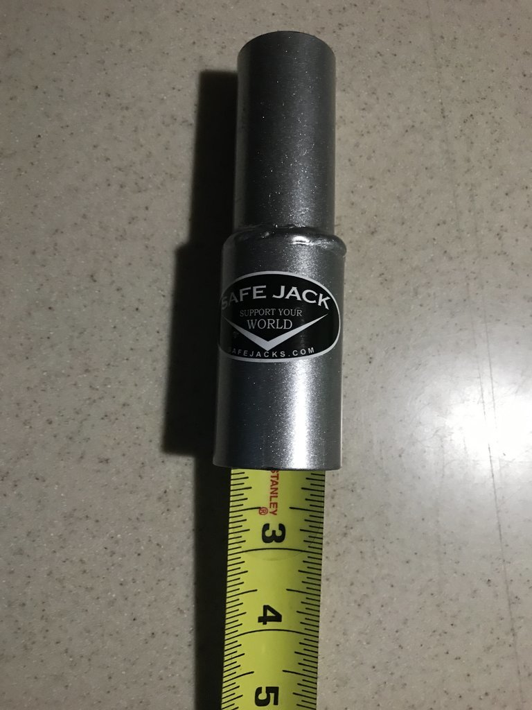

    The ram on these 4Runner jacks (with the top cap deleted) will fit perfectly inside my SafeJack 6 ton jack extension with a 1.25" I.D.
    I'm trying to avoid a hydraulic bottle jack, which may leak. Plus, the mechanical jack can act as a jack stand.
    I'm using your recommended SafeJack Universal 60" Hi-Lift Combo Stabilizer Kit that can also hold a plate for a bottle jack.

    Lloyd can you post a pic of just the exstension please I can't tell what the setup is from the pic

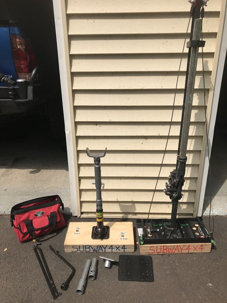

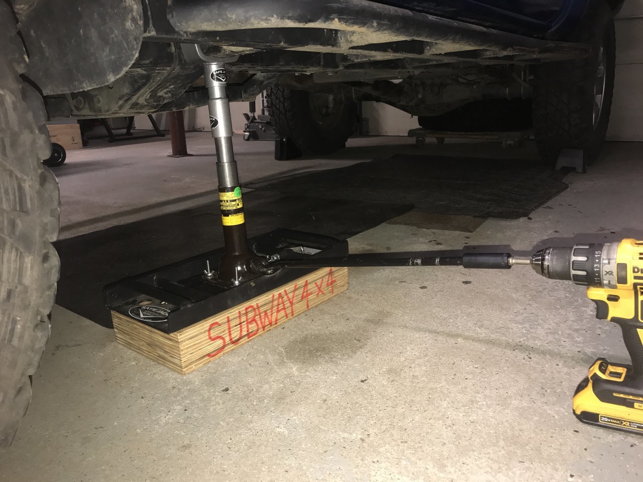

    Here's a pic with the jack/extension bolted directly into a plywood base. I can add/subtract plywood layers depending on additional height needed.

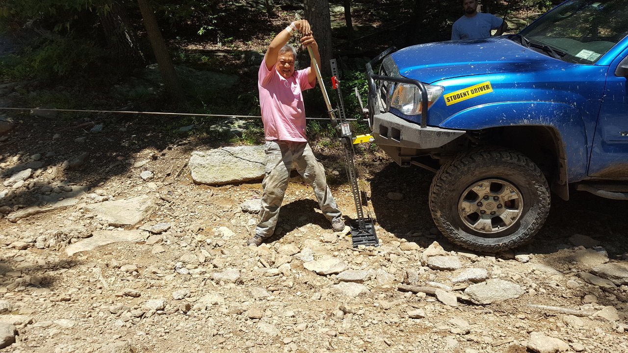

    No real need to get the SafeJack base, unless you use the base as part of the Hi-Lift stabilizing system (I have used this on my last wheeling trip.)

    Why did you take the time to write your screen name on the wood?

    HA, great pic. I looked up a video of the hi-lift stabilizer in action, and that looks like a must have for anyone that has a hi-lift. I know I'll get one when the time comes. Hi-lifts are sketchy enough as it is.

    I'm glad to see they pinned it I had just told EST it needed to be pinned for safety it would be nice if it could be pinned to the jack itself also

    Just trying to make sure my nifty multi-layered plywood base (patent pending) doesn't grow legs and wander off to the Tent-Mahal. LOL
    Actually, the Subway letters index how the plywood layers come back together if separated. The bottom plywood layer has a countersunk hole for the two bolts that hold all together. The top two layers contain the captured tee-nuts that you can bolt the bottle jack directly into.
    Note that even the nuts that hold the plywood layers together is labelled with the socket size (11 mm.) LOL.
    Just speeds up the process in the field. Requires less thinking...
    I'm all about less thinking.
    Also, note the green paint on Hi-Lift stabilizer base, the Hi-Lift Jack Base and the clevis cable pins. Allows quick I.D. for orientation of jack base and install of clevis pins in the field.

    Not really pinned Chris. All force generated is mostly downward, so pinning is not really necessary. The extension has two inches of engagement with the jack ram. The fit is very secure, with almost no play (which is why it was important to me that I get a jack with a 1.25" diameter.)
    With no play, the system will also deal with lateral/side-to-side movement. How much, I can't really say. It does feels pretty safe and secure IMO.
    The pin that you see is the "adjustable extension" accessory, which adjusts 3 steps via holes in the extension and a clevis pin, with a stepped range between 8.5" - 12"
    The extensions on the ground in front of the bottle jack are fixed heights of 3" and 6"
