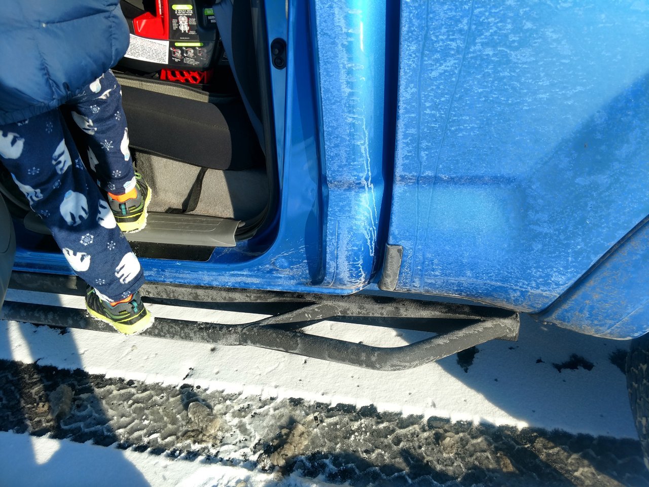

    Agreed. You beat me to the punch. Here's my SOS sliders on DCLB covering the bed section. I'd think a DCSB length would make the kickout too far forward to be fully useful, plus having it for a step in that section is super useful when reaching the roof.

    No, same holes on all DC's. The cab dimensions of an AC is 66.4" and it's 74.4" for a DCSB and DCLB. The bed length matters when you're adding the kick out to the sliders. But his only concern is having the sliders run the length of the cab, which these would. The only drawback is that the kick out portion of the sliders wouldn't run up to the rear wheels on his DCLB.

    Interesting, I thought these would be longer on the DCLB. These are the 96" sliders?

    The bed length matters for the kickout...
    But are you positive on that bolt holes? I haven't researched it to see.. But I am pretty sure the DCLB and DCSB have different frame bolt hole patterns? If you look on most slider companies sites, they offer one slider for the AC and DCSB and a separate slider for the DCLB (This could just be a longer slider... )
    Let me look back through my photos to see if I have any from when I installed my SOS concepts on my DCLB.
    Also worth mentioning is the frame plates that actually mount the slider to the frame - the ones in this CL add are simple right off the legs - the SOS, BAMF, Mobtown, AllPro all have a longer plate that connects a few of the legs together - in my opion this should offer a stronger slider as it ties the slider together to distribute the weight/impact force better accross the whole slider and frame - I also believe you would end up with more bolts holding the slider onto the frame

    Haven't measured specifically, but they are SOS DCLB bolt-ons.

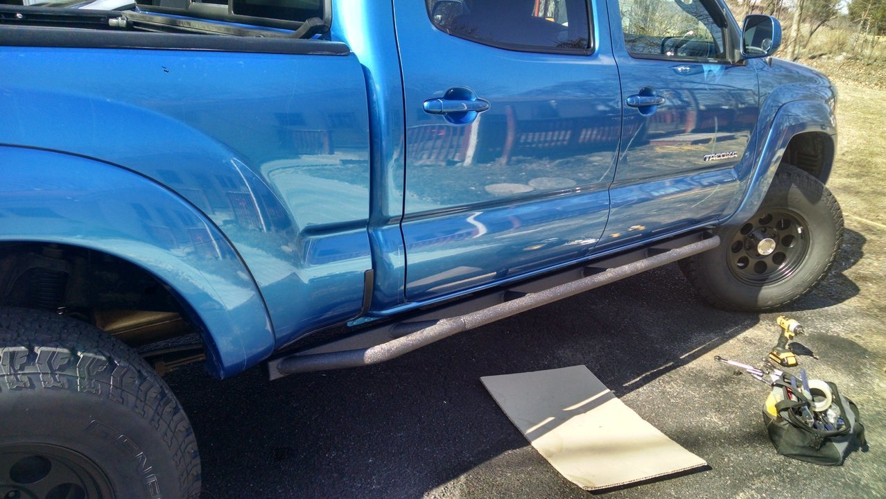

    No measurements and not sure it helps,. But here are mine when I uncrated then.
