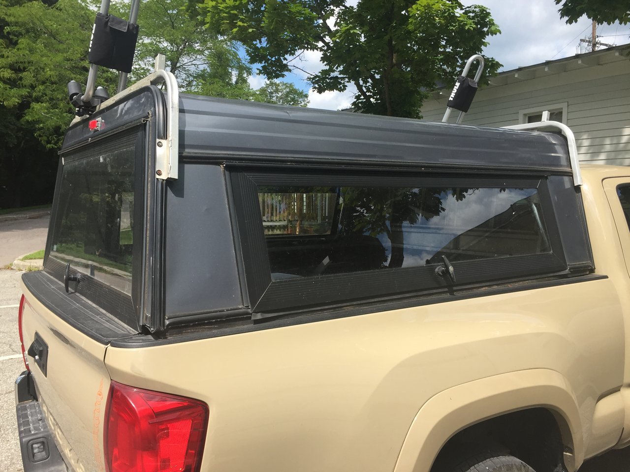

    Not mine. Just one I saw when I was in Stowe Vermont. But you can see the lip on there.

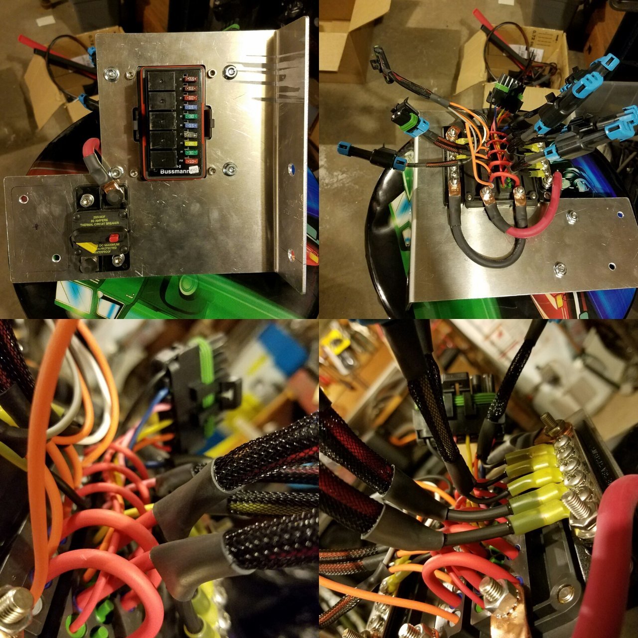

    Well if you need any help let me know. I have two fuse panels in my truck one a sandman special bussman relay pack and then a bluesea in the bed.

    cool stickers and a baseball card With clothes pin, sounds awesome ! wicked
    What mounting plate you use for the sandmanspecial

    Honestly I forget... I had a pelfreybilt but I hated the way it mounted with the bolt holes under the panel so I bought one that had the panel sitting below the fuse block.

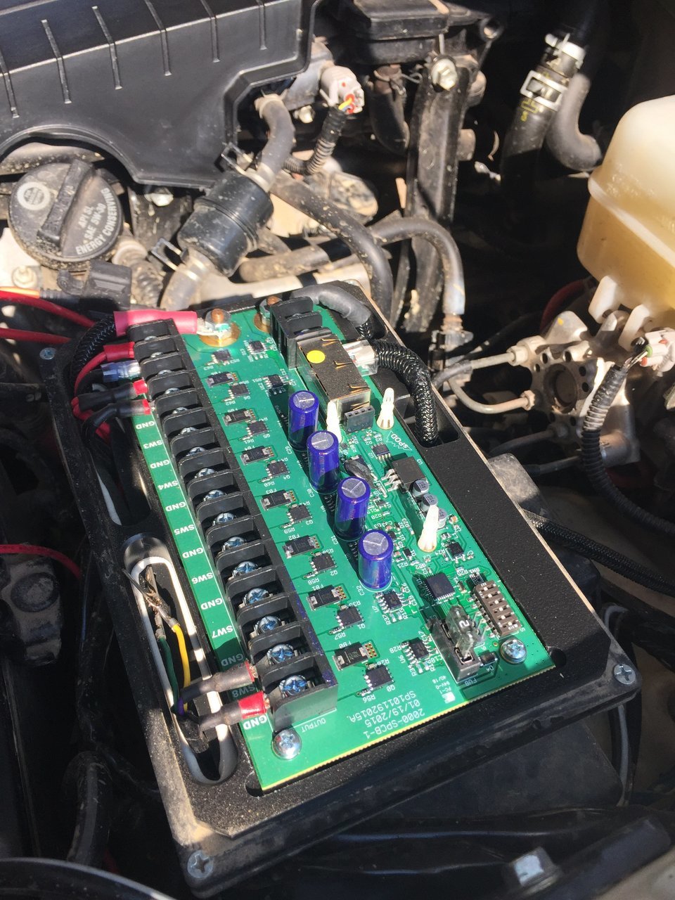

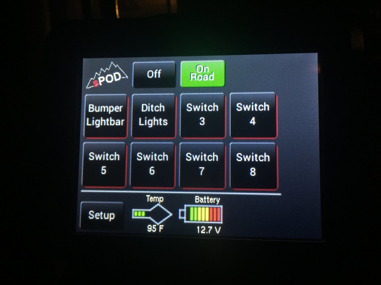

    The regular sPod has 6 spaces, and is 350.
    The touch screen has 8, and is 750.
