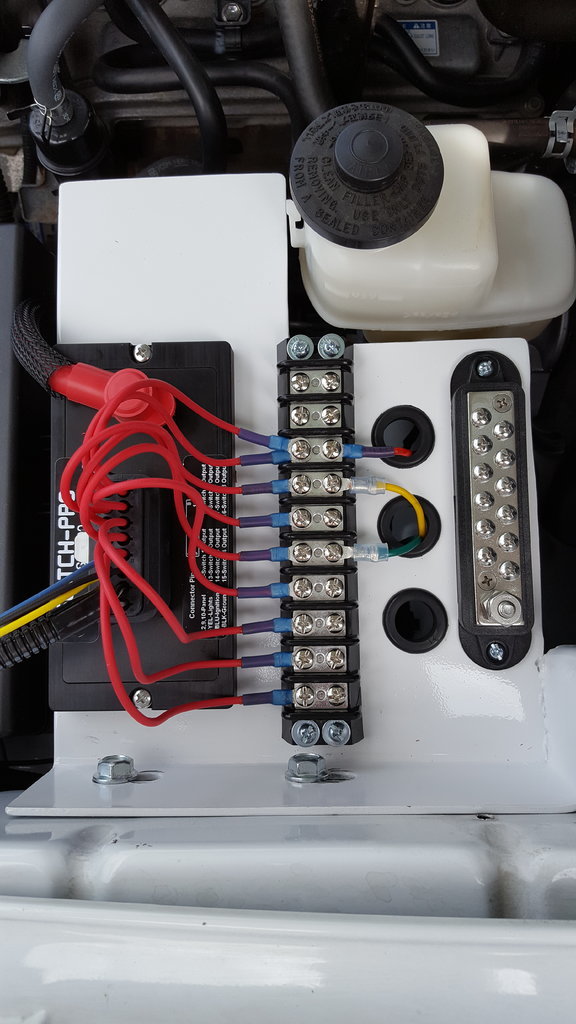

    Got this installed today. Didnt get to mount the switch panel itself yet, the kids and wife wanted to go swimming and after sweating my butt off all day I said lets go.20170715_172457.jpg

    Thanks...took me a while to get it all done like i wanted. Made the mounting plate at work while I had nothing to do.

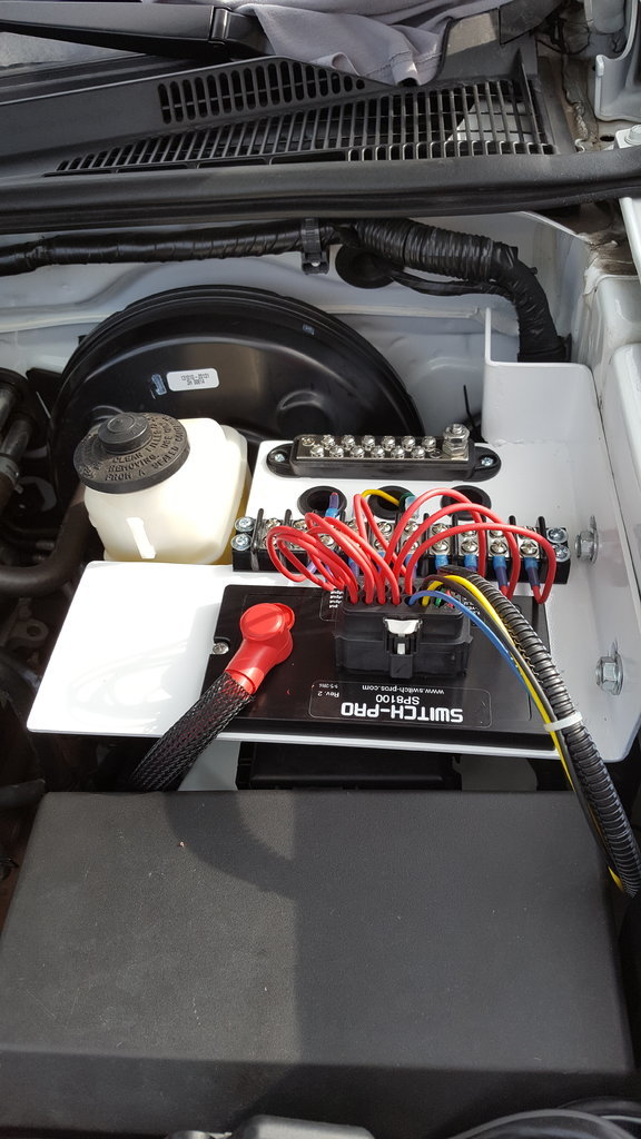

    Question for you electrical savvy guys. My Switch Pro setup that I just finished, I am using a Blue Sea 30 Amp terminal block. I have 2 extra spaces that I have nothing running too and it just so happens I have to more accessories that I am mounting in the bed. I have wiring harness's for both of these with inline fuses. I was wondering if it is safe for me to run a jumper wire from my power supply on the switch pro to each of these terminals and then just connect the wiring harness to these instead of having to connect to the battery? Hopefully I have not made this to complicated or confusing in what I am asking. Just don't know if a 14 awg wire will be heavy enough to use as a power wire and if the 30 amp terminal block can withstand straight juice from a battery supply.

    Here is a better pic to show the terminals I am talking about above. 20170715_172504.jpg

    What's the current draw of the bed accessories that you want to add? In the picture, most of you switch pro channels are empty. What about just wiring them to a couple of the unused channels? If you've got things planned for the unused switch pro channels, than adding a jumper from the switch pro battery terminal to the two empty strip locations will be fine. Wire gauge needed all depends on the power requirements of what you're hooking up.
