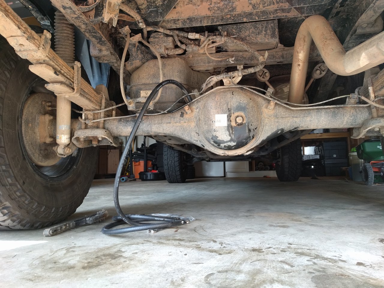

    Time for some mods!
    And preventative maintenance which is decidedly less fun but necessary. I'm happy to report that after 80k without a fluid change (sorry gears) and many a dunk in the water without a raised breather, my rear diff fluid looked great.
    These are the 4x innovation weld on sliders made with DOM tubing. Stout, inexpensive, cheap and fast shipping.

    difficult to do the extended diff breather?

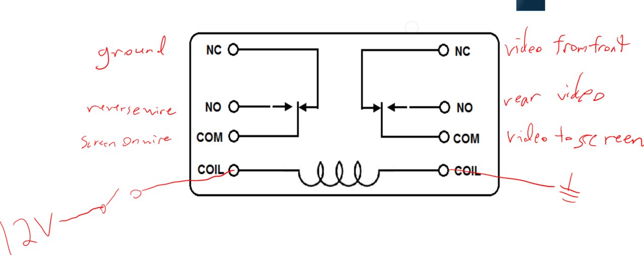

    I could make it go to the stock display. A switch would turn on the front camera video, rear would operate as normal.

    Im thinking some simple relay work would make this easier, use the stock display, and be much cheaper than $100.

    Here we go. Setup like this would do what you want. Too easy.

    Nope, supper easy mod.
    Just need the parts and some hose.

    Yeah, i gotta do the rear diff breather also. Probably route it to one of the storage cubbies in the bed.

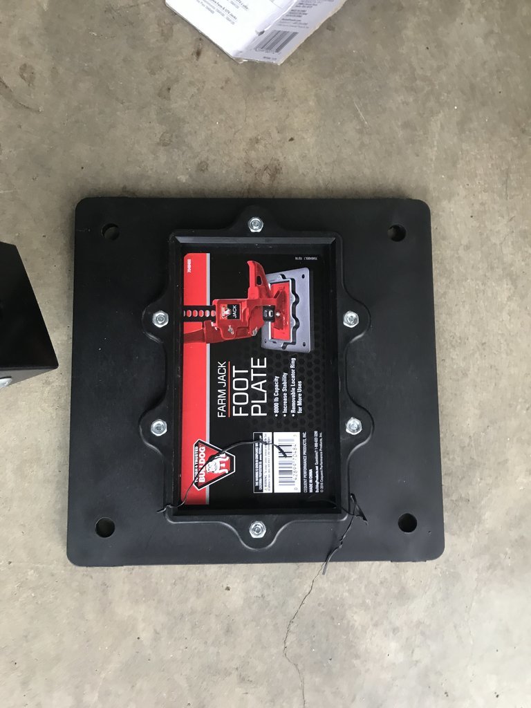

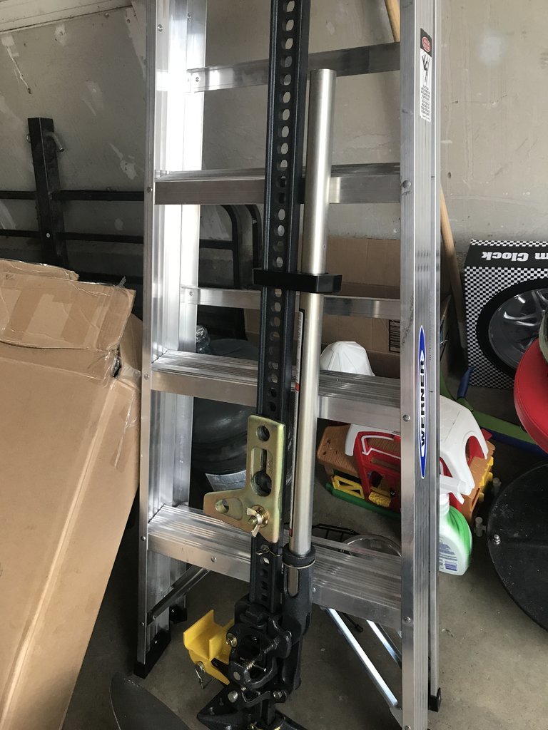

    I went up to Tractor Supply today and bought a handle saver and a base for the hi lift!
    Also... since I'm picking up my mower tomorrow, I went ahead and took the rack off...

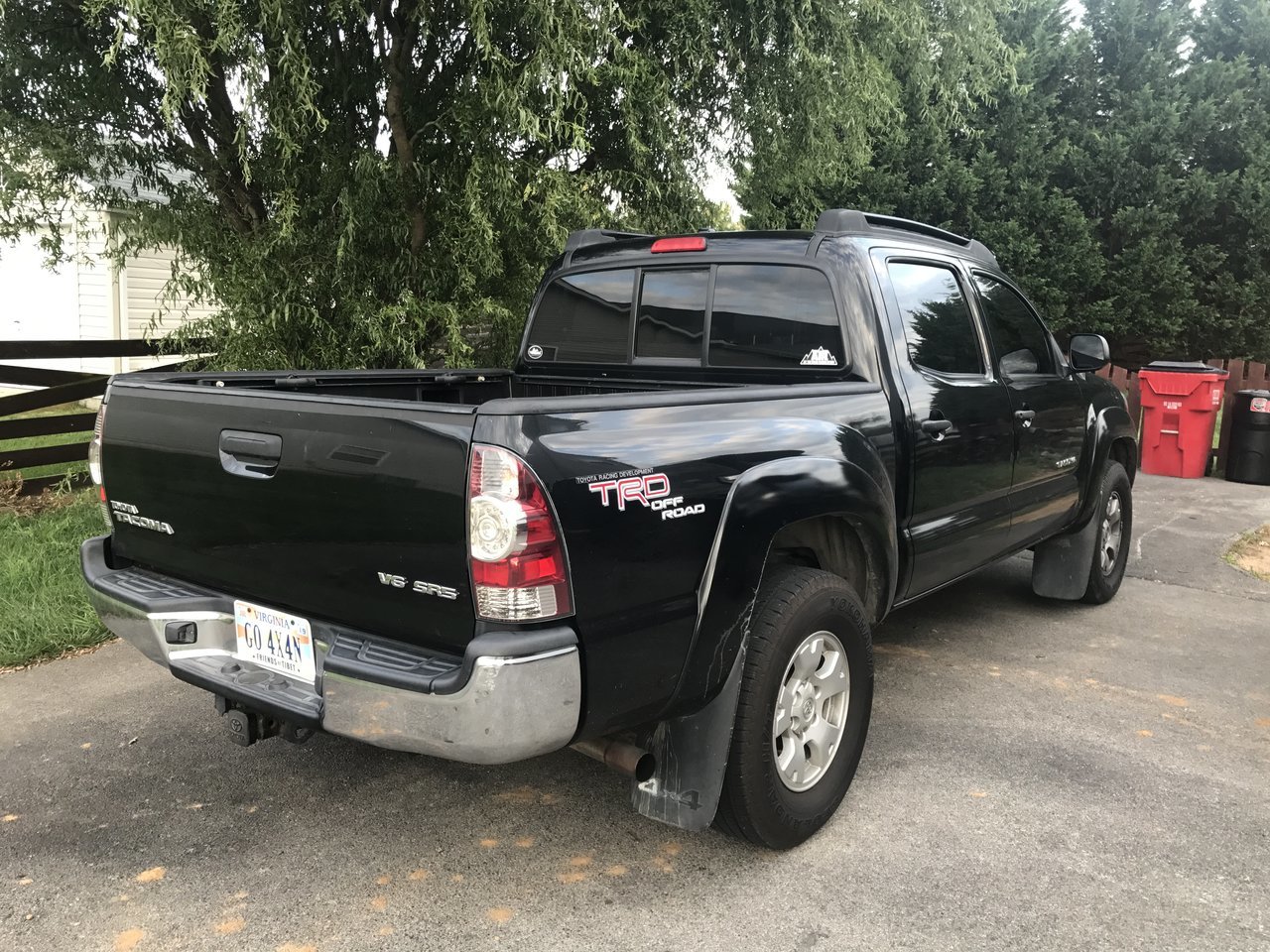

    What does the front camera look like? I don't think I would be able to do it with my front end though. =(
    This was when I lived in SLC ... Notice the VA inspection stickers!!

    Man that was so easy. Takes about 10minutes. Cheap too. I ran mine to the gas cap area.

    I just wire tied mine in the taillight housing way up high. Worked great.
