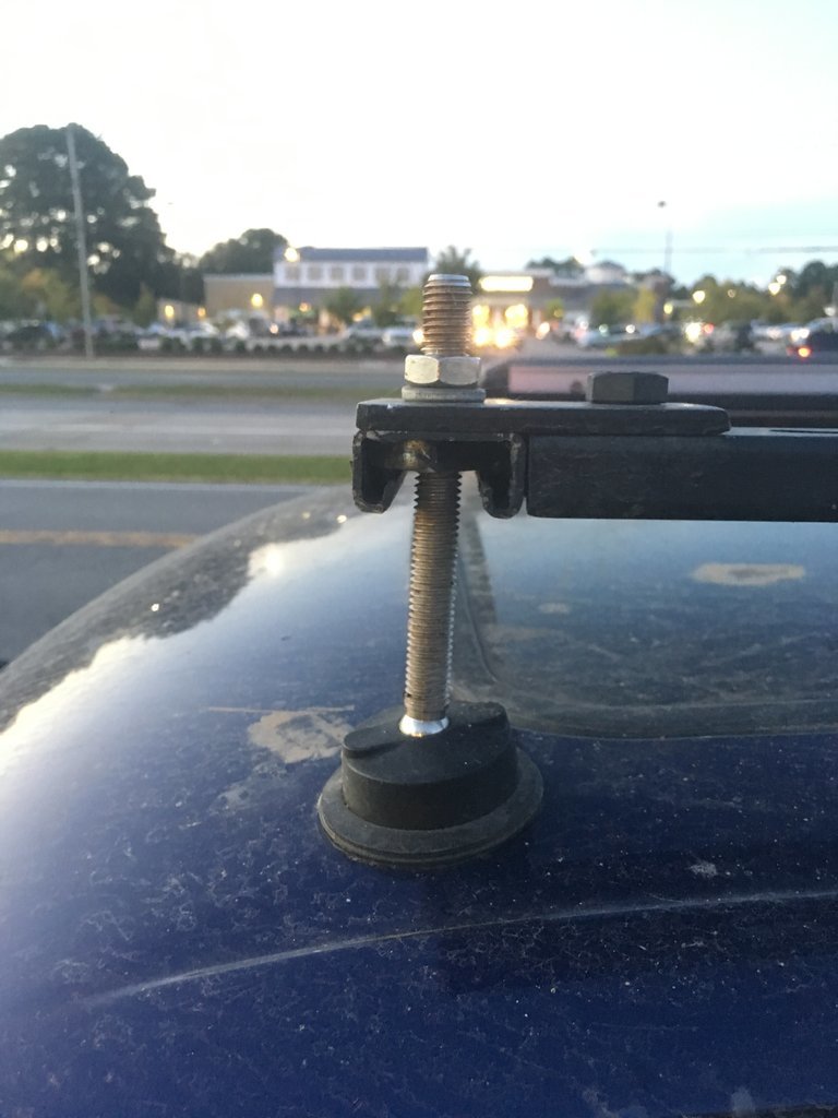

    One of these in each the front two corner. Then added a furniture pad underneath to stop vibrations. Works perfectly.

    Nice thats good to know it holds up. How is it mounted to the factory rails?

    The feet? It's just through the unistrut with a washer above and below. Lock but on top as well
    Excuse the dirt. Was at Uwharrie this past weekend and still haven't hosed it down

    Nice thats how I figured those feet attached. I was actually wondering how its attached to the factory rails on the roof of the 4Runner to keep it fixed to the roof.

    I used another set of unistrut bolted to the actual rack as a bracket. Then I slid t-nuts into the factory track and ran a bolt through the brackets and into the t-nuts
