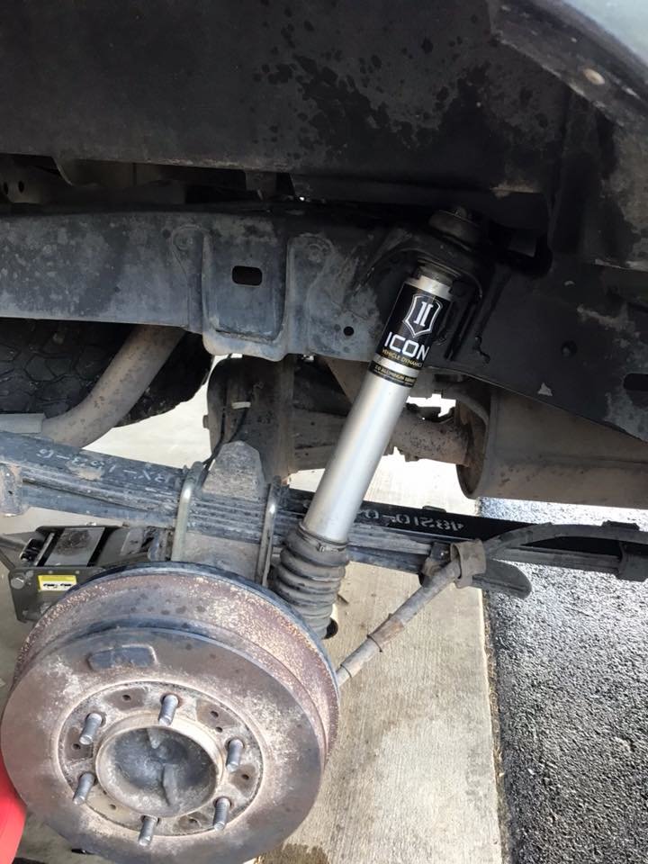

    Removing the old shocks:
    24067799_1468321029955834_36105716077807_c39fcc2fc1c3bb934ca9060c7bdb8ada99855989.jpg
    Finally got the new shocks in!
    23915964_1468322969955640_47471542610972_1b83a9d80752a61b180f6e218386965ed6bc81a5.jpg

    I've had to break out the andle grinder on a few sets of rear shocks. Those things are a pain! I usually just flatten the sides though to better grab it with some channel locks.
    Also WTF happened to that screwdriver.

    that worked on the drivers side.... flatten out 2 ends and grabbed it w/ channel locks..... the pass side wouldnt budge
    and the screwdriver snapped while lining up the pass side bottom shock into the shock mount.... it was like 15 years old haha but I was still a little "shocked." haha

    :rimshot: Yeah for some reason the lower shock mounts seem to be too narrow, making it a little tough to get them in there. Usually takes some persuasion with channel locks and a hammer.

    yep, I just grabbed my large pry bar and pulled it a bit and they went in with some coaxing
