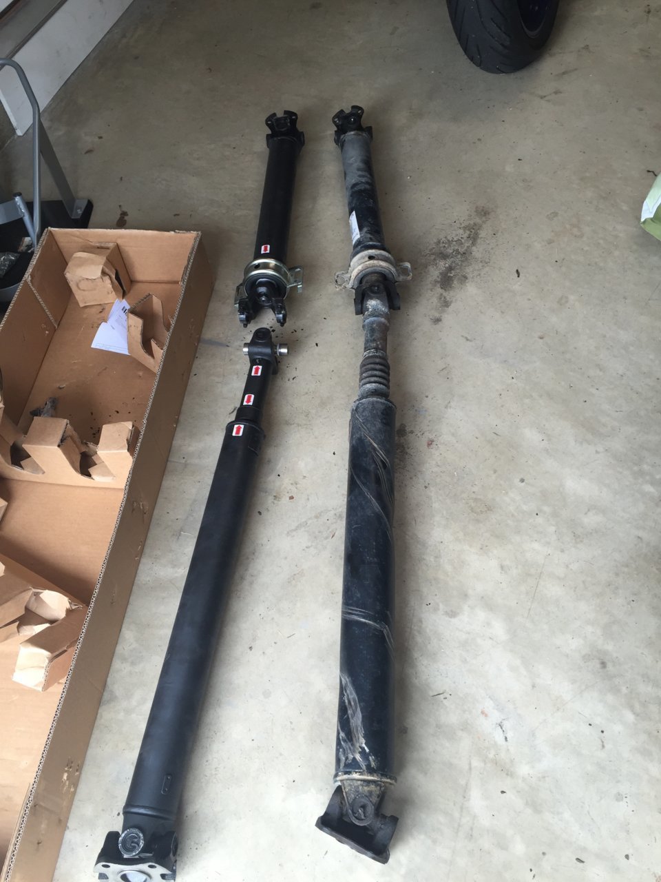

    So replaced my clamshell bushing still have a front vibration. Drive shaft rebalance?

    The ECGS bushing

    What vibe do you have? At 25?

    There’s small vibes at lower speeds then a big viberation at 65+

    Id say just visually check your driveshaft. Maybe you rubbed some wheel weights off. If you have driveshaft vibes they are going to feel like you're on a bucking horse

    It’s a very loud rhythmic front hymn. Also super anoying

    Flat spot on tires? Maybe rotate them? Are you rubbing anywhere? What tires do you have?

    I have a master craft MTX. The vibration seems to come Front The center of the truck

    Then i have no idea. Have you greased all of your driveshaft zerks? Check air pressure, wheel weights? Check wheel hub/bearings? Tie rods? Lower ball joints?
    Im just throwing stuff out there now. How many miles do you have? The front wheel bearings last for about 70k miles

    76k

    Jack the front of truck up, grab wheel at 9 and 3 (like on a clock) and push/pull, then do same at 12 and 6. If there is play, you need new hubs/bearings. There are several people on here that built them already pressed together. The NJ guy's name is blanking right now for me. But its a very good price. Get 2, because Murphy's law..
    Show pics of lower ball joints and tie rod ends.
