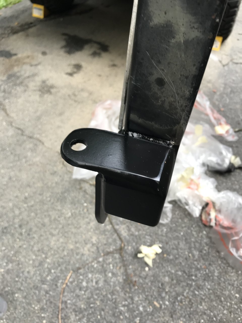

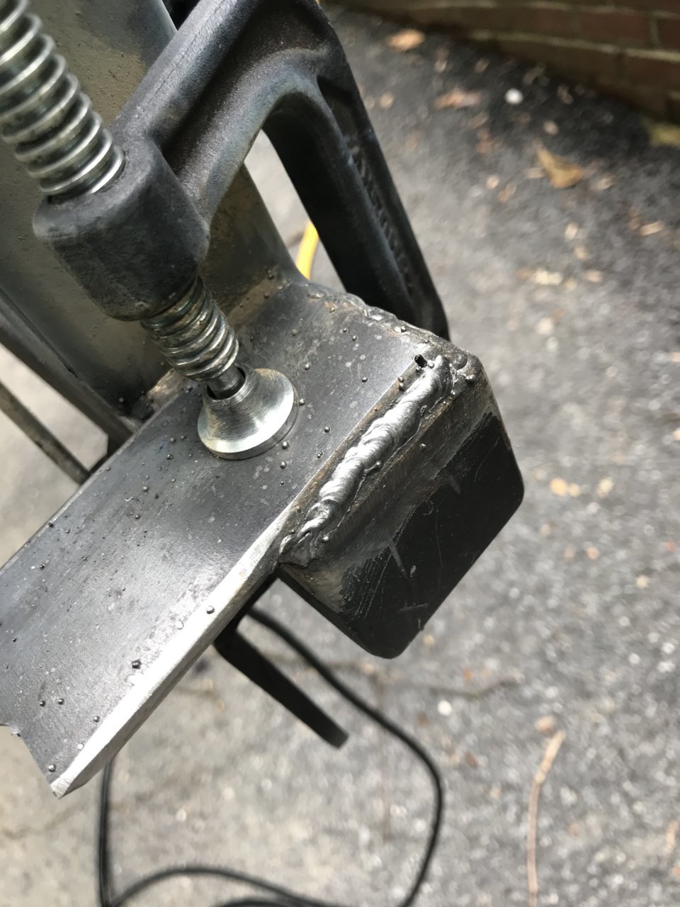

    I’m about to! Spent the afternoon doing a couple little projects. Welded on some 3/16” tabs so I can lock my swingout with a padlock.

    You need to turn your welder up bro

    You can hardly see my welds in this pic

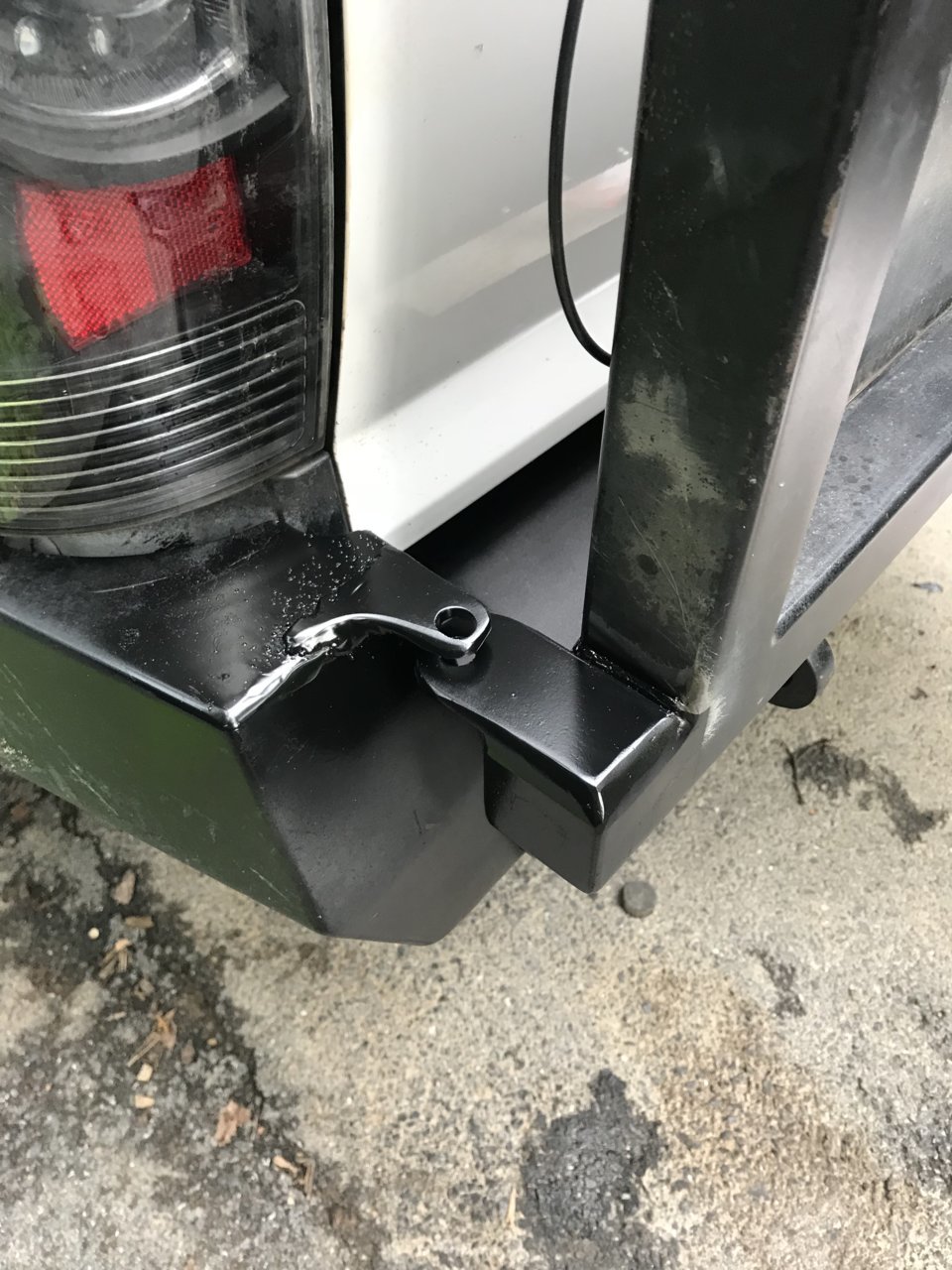

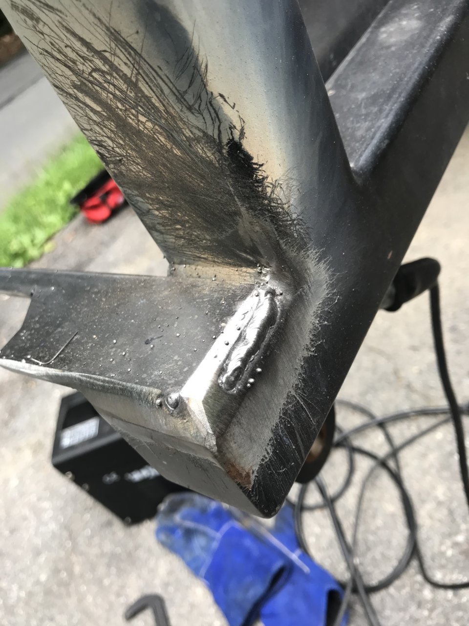

    I know I can use practice, but I’m getting better. I have a cheap little flux welder with only 4 power settings. Can only make it so pretty.

    Zoom in the pic...you can see them. And I can tell from all the spatter that it lacked some heat too. Not being critical. Just giving you a pointer

    Those DO look a little better. Yeah flux welders, meh
