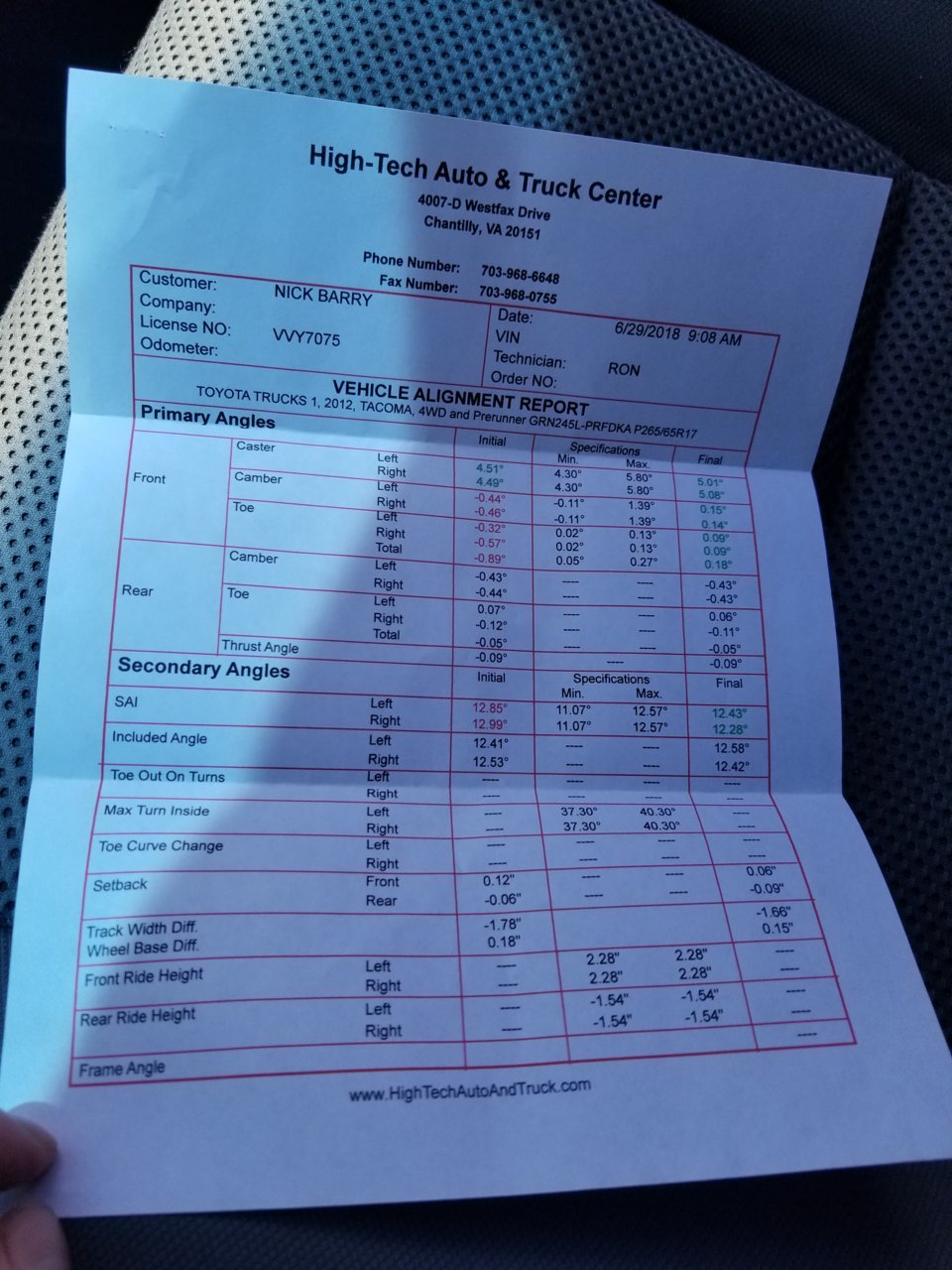

    I mean If high tech did it then it should be good but i thought it was supposed to be closer to 3 or you could get death wobble? I have Similar numbers
    Now after i added The dirt king UCAs but i need To fix my LCA and get the numbers back down. It rides great though and i rub A little on driver side and it sits at 3.5, with no rub on passenger side but sits at 5.6?

    I stopped going there because they were putting my Caster at 5*. I go to the place near @EatSleepTacos . Its very nice to have a straight steering wheel.

    Should it be less? My steering wheel is just a little crocked.

    should be 3. Did they tell you it was because of road crowning?

    Yes??

    that exists, but have never heard it from another shop..

    What does it do the placement of the wheel in the wheel well?

    road crown is for the draining of water from road ways. Its their reason why your wheel is crooked on a straight road. After I went to the Maryland shop, no more crooked wheel and 3* of caster
