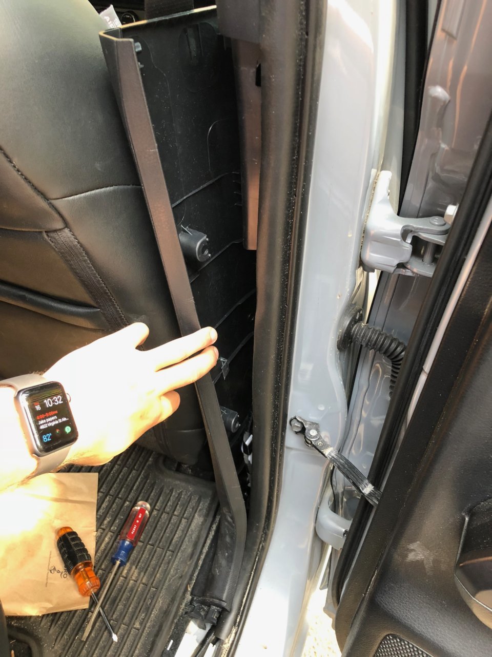

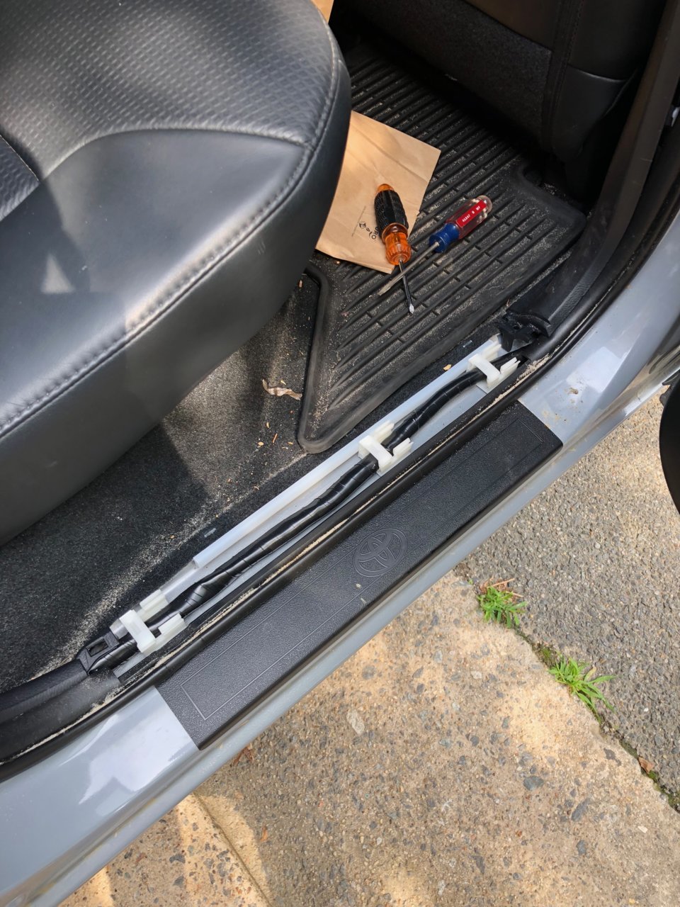

    Can anyone help me out with this? I have my CB radio attached in the cabin, and I have the antenna mounted on the bed, but I cant seem to figure out how to get the side T panel open on the passenger side where the seatbelt is. I was able to get the floor panels out on the doors, but I cant find where I can run the wire from inside the car to under the car.

    I just ran mine along my frame and brought it up through the rubber grommet under the drivers seat.

    Below the driver and passenger seat there is a grommet that you can run it through. It’s underneath the carpet but if you look under the truck you can see it.

    vvvvv what these guys said. There should be a grommet under the passenger side front seat as well as under drivers front seat. Unless something changed on third gens, thats the way the second gens were.
