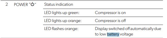

    So I have both but mine is shutting off completely and flashing orange witch my owners Manuel says nothing about. But when I start the truck it’ll run again. I’ve got my shut off setting on 10.4. But my battery will be at 12.4 when it shuts off.

    Flashing orange means it shut off from the battery cut off. How are you measuring the 12.4?
