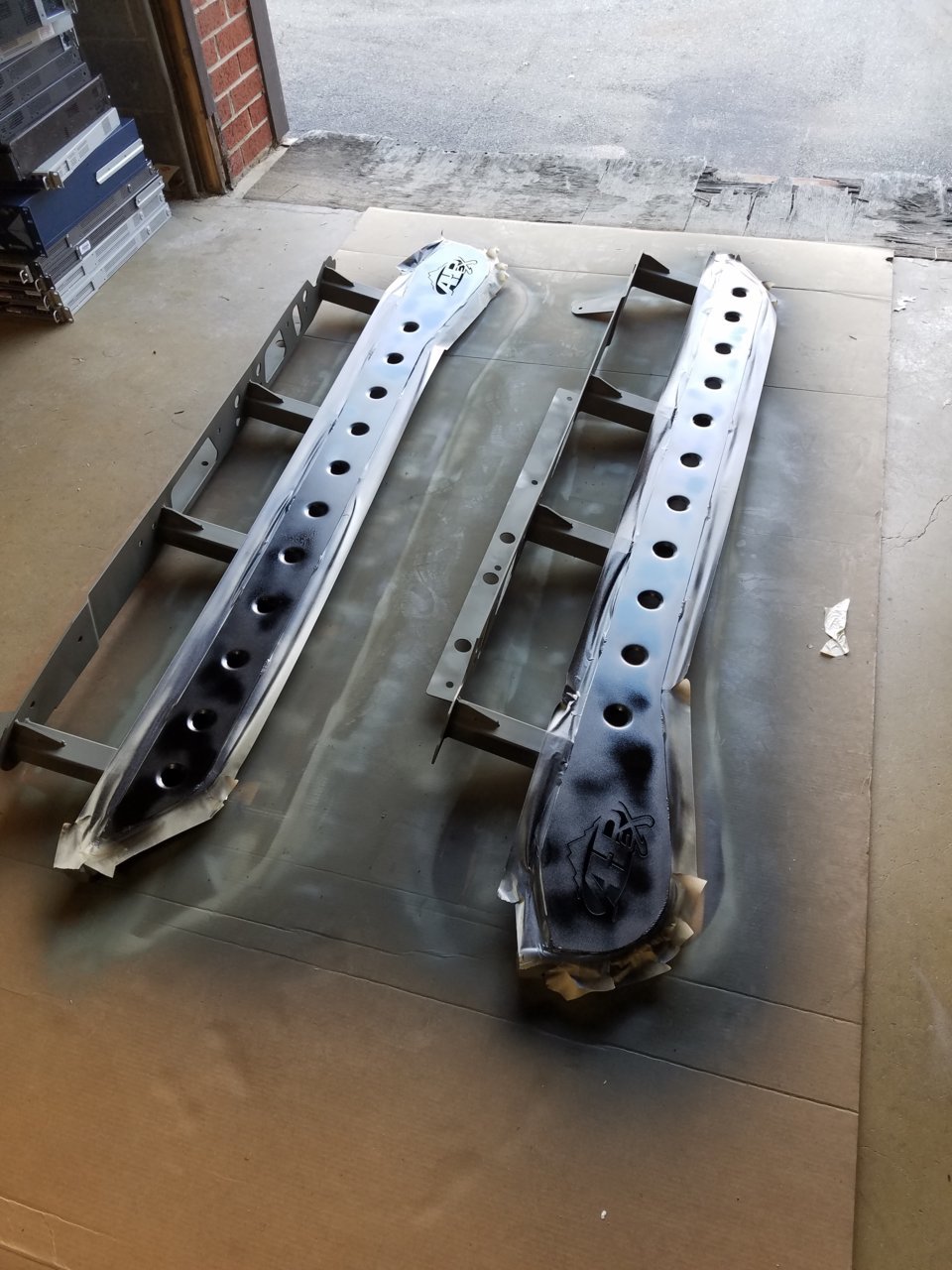

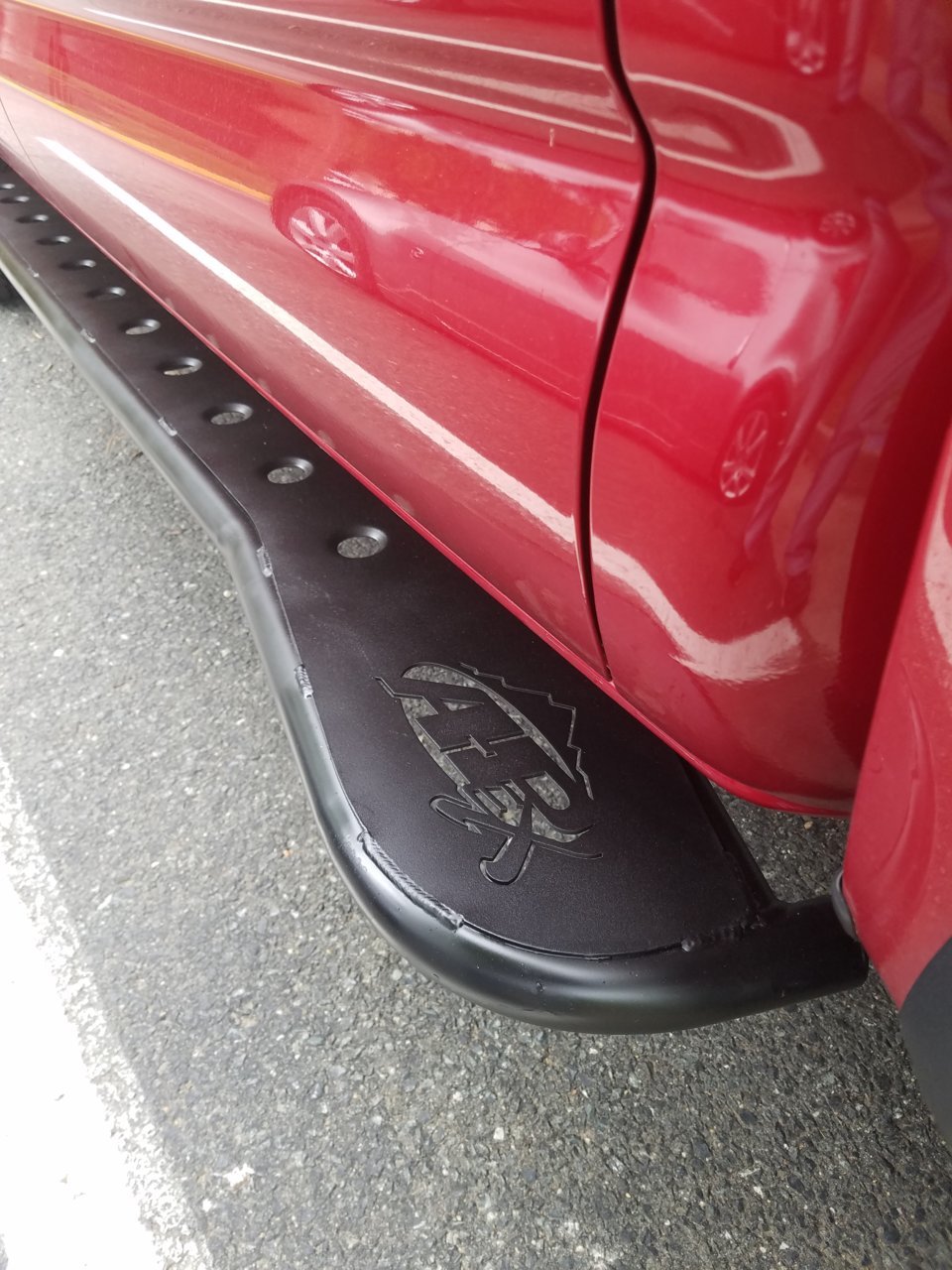

    I used the self etching primer then taped off the plate and used truck bed liner. Then I used a simple krylon matte black over the whole thing. Gave the texture my wife needs for a step and the smooth easy to fix texture of the slider. 20170601_170708.jpg 20170605_124514.jpg
