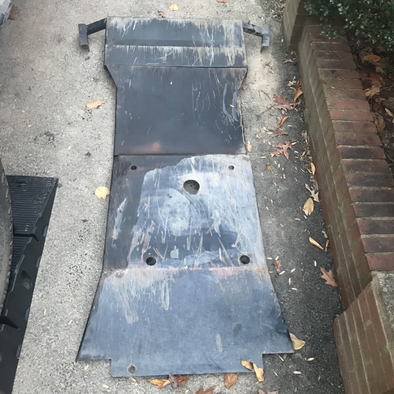

    @EatSleepTacos does Mobtown only sell skid plates for the 3rd Gen armor? And what does IFS mean? I also saw some other acronym but can't recall it. Thanks.

    For third gens they offer front and rear bumpers, rock sliders and the main three skid plates in terms of armor.
    Fuel tank skid is almost available. I’m running the prototype right now.
    IFS means independent front suspension. So in regards to a skid, that’s the front skid plate. The main, big one. Behind that is the transmission skid and behind that the transfer case skid. Here’s all my three so you can kinda see what I’m talking about.

    So the skids for 2nd and 3rd gens are identical with the only difference being the oil filter cut out on the ifs. If you notice, the transmission and t case skid say “2005-current” so that’s the one you’d buy.

    :anonymous: Sorry, but I'm full of questions this morning...any idea weight savings aluminum vs. steel? I can see the cost savings...
    Do you know if adding the front and transmission skids will be so heavy that I may need to upgrade shocks? I currently have Billie 5100's all around.

    I don’t know exact numbers but it’s aboit half the weight, maybe 60%. A full set of steel with reinforcements maybe weights 150 lbs and a full set of aluminum 80? These are rough guesses. It also comes down to how you’ll use them. Quite a few people end up buying aluminum and switching to steel because the aluminum wasn’t quite what they needed. For someone who has no intention to do any hard off roading, aluminum is the way to go.
    Also imo the skids aren’t a place to save weight. With the weight so low and distributed, you don’t even know it’s there.
