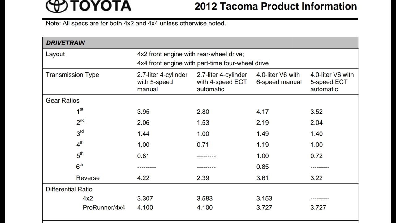

    Do all 4x4s come with 3.73 gears? The ecgs rep today said that it could be one of many gears in my truck from the factory

    3.73 or 4.10. The trd sport from what I've been told has a Limited slip from the factory although a very week one from what I've seen if it really has one.

    A thing or two...

    4 cyl has 4:10's I know that. Same rear different ratio. This is the 6 luggers not 5

    Factory LSD was only available until 2009. After that it was simulated LSD with the ABS, aka ATRACS.
    Edit: The LSD was available on non-TRD trucks as an option.

    Any idea how that will interact with my atrac? His is an 05

    Won't have any effect. The later trucks with ATRACS have a standard open diff like in the pre-ATRACS non-LSD trucks.

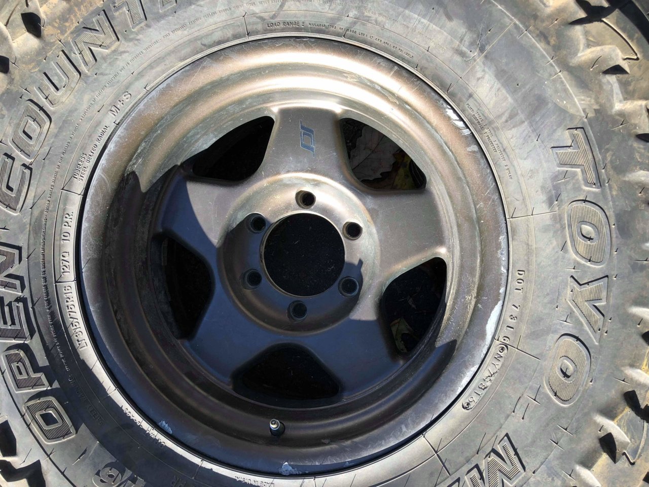

    He also has these wheels and tires for 1500. He says tread is 90%. Wheels look like they have rash

    buy em!

    That's a little too close to new price, especially if there's much rock rash on the wheels.

    Those aren’t 22’s

    Are they 35s? You need to get rid of your bro wheels. Those are exactly the same as mine.

    They're 315/75R16. If you zoom in, you can see the size.

    I think thats a good deal. Ive seen them go for more
