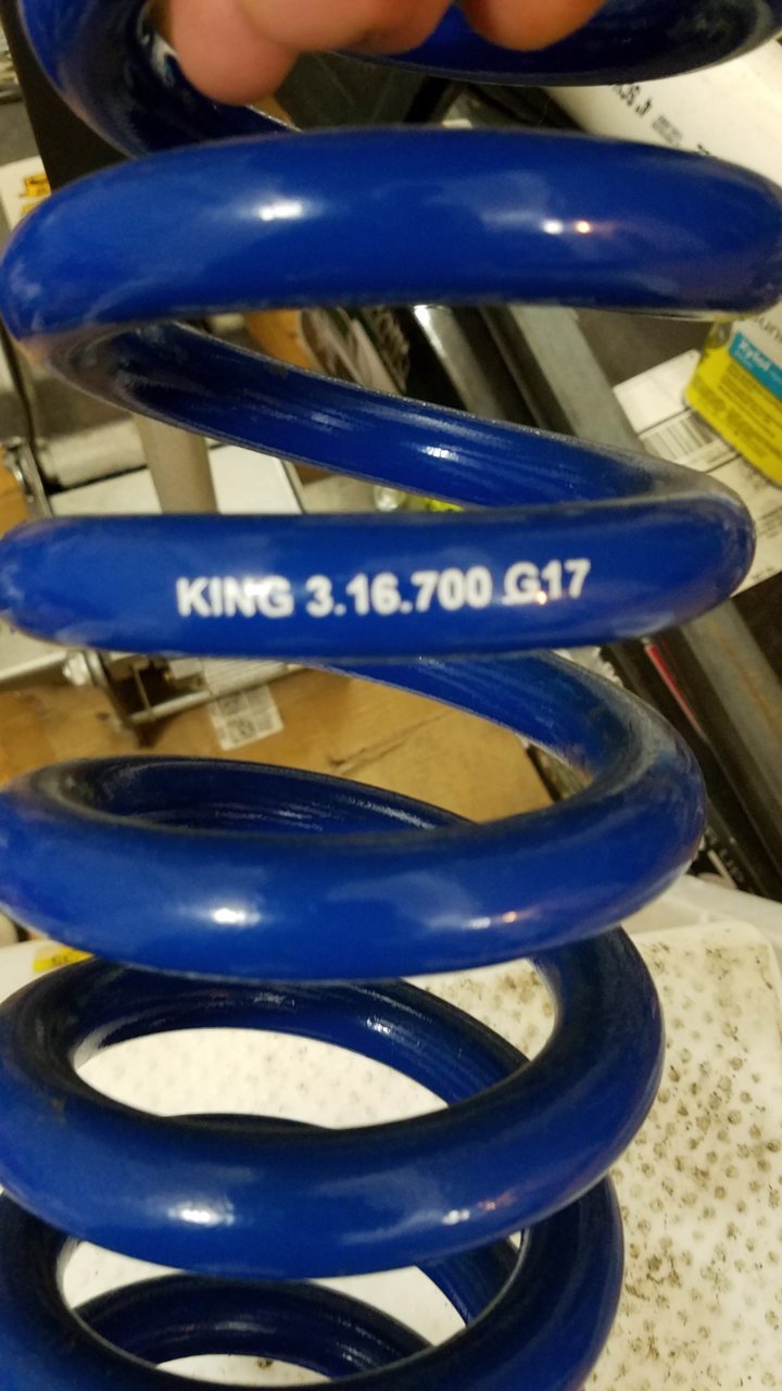

    Kings come with 600# springs from everything I've seen. Fox or Icon come with 650# springs I think. I bought an used set of Kings before I started buying LT stuff, and they had 600# springs if I remember right.
    The ID, length, and weight is printed on the springs. Example:
    For a 2.5" shock, you need 3 inch ID springs. OE Kings use 14" length springs.
