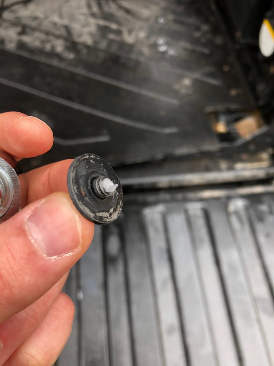

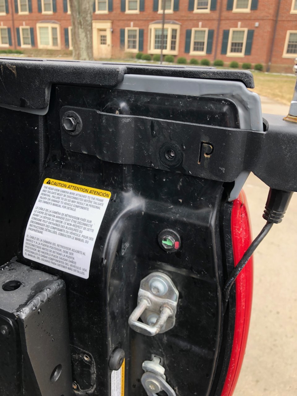

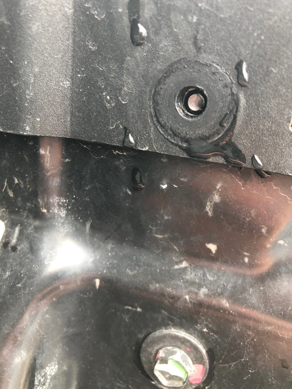

    Okay guys... So I have my CB radio mounted on the bed near the tail light, and one of the bolts decided to snap... Already picked up an extractor bit for it, so thatll be a fun first, but does anyone know if a Toyota dealership will have these bolts? Or where I can get them online, preferably stronger ones. Ace & Home Depot do not have the right size :mad: :boink:

    probably hunting or camping

    I broke one of those...But i just left it.

    Yeah but my issue is that its holding the mount for the CB antenna, and its super wobbly so I had to take the antenna off. But I could always take one off from the other side and leave that side without it

    Dealer should have them. Or you can figure out the thread and stuff and get one from hardware store. If you get one from hardware be sure it's stainless.

    Fastenal

    Part number should be 90119-A0079. It's an M6-1.0 bolt.
