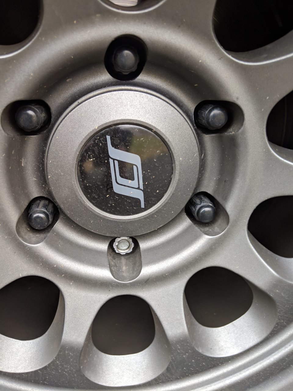

    Just have @ilubtimmyhos help you. I heard he can sheer off lug nuts with his teeth.
  13. Apr 29, 2019 at 9:16 AM
    Minimag95
    Minimag95 Well-Known Member
    Nov 8, 2017
    #235456
    1,655
    Niles
    Annapolis, MD
    2009 Pyrite Mica V6 SR5 4x4
    OME's w/ 887 Coils, SPC UCA's, 285 ST Maxx. Mobtown sliders & skid
    @ilubtimmyhos can you bite off my cam bolts? :rofl:

    Shouldn't be a problem for him...

    It legit looks like he bit that off....
