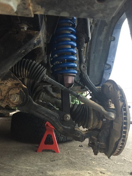

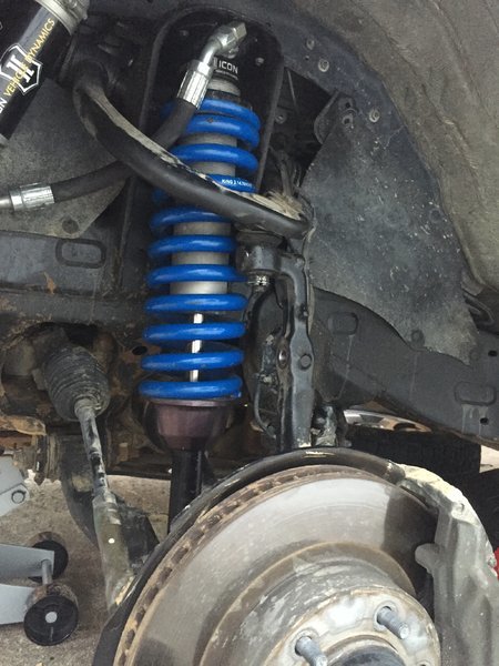

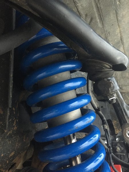

    Will my Coilovers settle and allow the UCA to move up with the weight of the truck. Right now the stock UCA is binding image.jpgimage.jpgimage.jpg

    Extended travel coilovers?

    With extended travel coils, shock manufactures say you must run an aftermarket uca for that reason

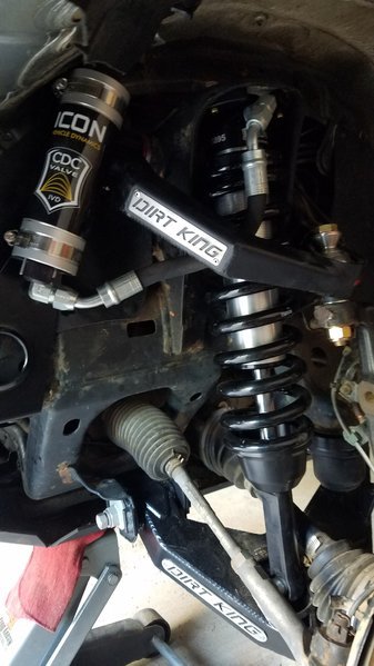

    Yup, and sometimes limit straps are still needed. I may have to look into that for mine as I have a lot more downtravel now. And more bumpstop spacers....
    In other news... so pretty......

    Dirt king:spy:. I've been eyeing their uca's. Since everyone runs tc or icon

    Those are looking good Patrick! I might need new UCAs! I wish I had your set up! I still have the other side of your passenger side set up!

    Is this your setup?

    Yup, took two days to get all the old crap out and get the new stuff in. This is why I couldn't make it yesterday.

    Quite the impressive setup. Need some spindle gussets to finish it out.
    You could have brought the truck down here and we could have helped
