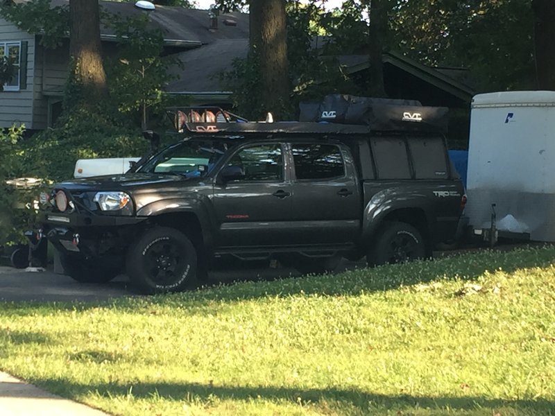

    Who are you???

    Dudes got a nice rack!

    I was just pointing out a nice truck!!

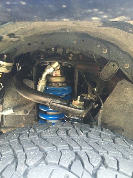

    Is the binding gone with the new UCA's?

    Absolutely. They don't bind at full drop and the stock ones were close to binding even at ride height. Ride is also much better. Top is Light Racing and bottom is stock, huge differenceimage.jpgimage.jpg

    Did you have to cut the old uca bolts, or did you have enough room to slide them past the fender wall?

    I took a pair of lock pliers and just pulled on the pinch weld, it took a few pulls and then you can slowly slide it out/ tap it with a hammer. It was really simple and not as destructive as I thought it would be
