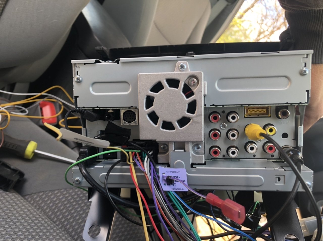

    So I’m still trying to get cameras installed on my wife’s truck and I’m not having any luck. There are red wires that require 12v power coming off of every connector, are they really necessary? I bought a “controller” And I can’t get that to work either.
    These wires are coming off the front camera. A yellow av with a pos and net wrapped together and then a separate pos, and then It has another pos and neg on a separate connector DDB4B77D-4053-4A12-AAD7-A19DAF0F37EA.jpg
    Here’s the front camera av cable on the inside that has another loose pos hanging off of it. And the camera controller and has a loose pos and neg separate from the av pos and neg.
    032C4BCC-66E0-4E59-B640-B96BC23E2BAA.jpg 066FCEE5-50B0-4B67-B80D-FBABC3EF8637.jpg
    I could use any insight as the instructions are in mandarin or something and I suck at electrical stuff

    All the positives and negative leads coming off the cameras? You can run them all together. And then back to a switched 12v spot. There's one right behind the headunit. A ground, too. This is what I did for mine. Works perfectly. There's a reason they split them up like that, but I don't want to confuse you. Anyway, I'm looking at the controller and some of it doesn't make sense to me. Is there a wiring diagram with it? Let me see if I can find something online.

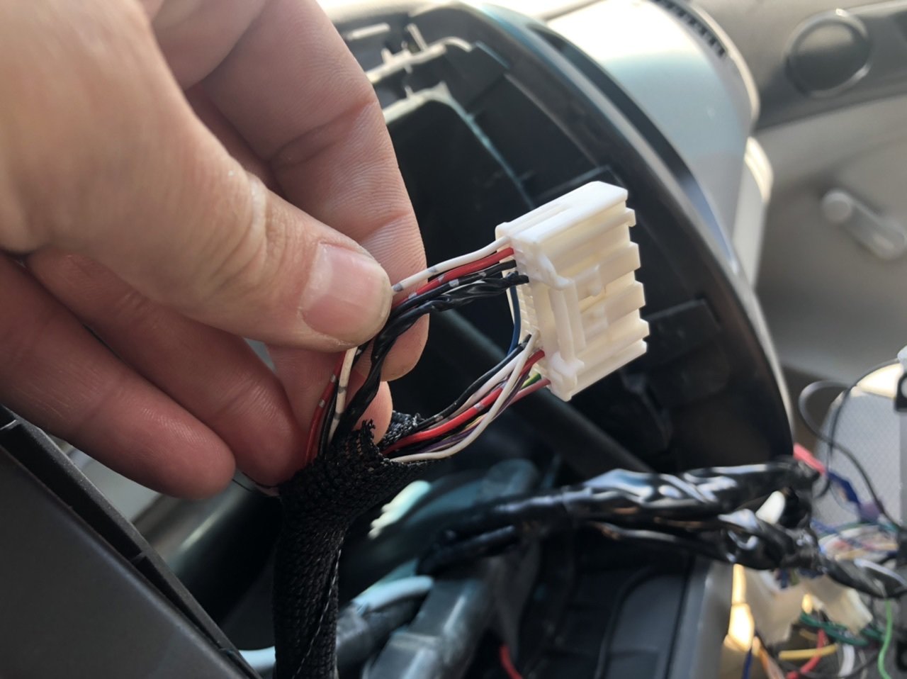

    I also installed a pioneer head unit. I guess I need to splice this rear camera harness?BE781592-0D34-4151-B00A-B1E08494CB28.jpg
    and the controller plugs into the “video in” on the back of the hu right?B468216C-A9B9-4C18-9468-52B31C1573FB.jpg

    Round two. I still have question marks. Let me rework my first answer. All the positves and negatives from the cameras? Run them back to their respective wires on the controller. You'll have the two sides left over. Then the RCAs the same way.
    On the other harness: black to ground, red to switched 12v. Does the controller have a switch for it? I'm assuming that's what goes in the other plug? Either the DVD or DVR RCA will go to the back of the headunit where you indicated.
    The headunit will need some kind of trigger to switch over to the camera input. I will make a guess that's what the monitor, left, right, and rear wires are. I'll make another guess and say you only need one of those. Why not start with monitor? If my thinking is right it would go to the reverse trigger wire on the headunit. You could test this through trial and error after you get everything else hooked up.

    Just noticed something else. The camera RCA? I'm going to say plug it into the brown RCA input on the back of the headunit. A Pioneer headunit I had was like that and it took me forever to figure out why I didn't have video.
