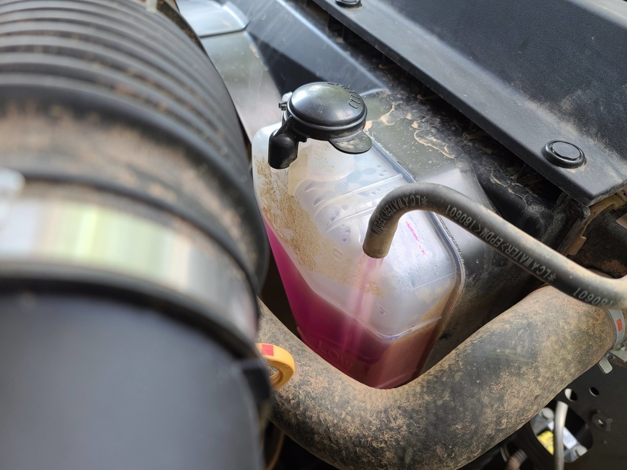

    Got a question for you all, I got a problem with my truck.
    While i was in ATL i drove an hour to grab some food. While i was sitting in the parking lot with my car idling, i noticed my ac start to get warmer. The temperature gauge was hot. So of course when i noticed that i the heat on to lower the temperature of the engine and that worked fine. I started to drive and the temperature started to go down. i drove home perfectly fine with ac on.
    I drove home yesterday from ATL to NOVA perfectly fine.
    Another instance happen today. I was driving perfectly fine. but while i was sitting in traffic the temperature gauge was slowly jumping higher and higher. but when i pressed the gas and started to move with traffic it went back down.
    Has anyone experienced this? And have any solutions?

    Have you cleaned your temp sensor since you went wheeling, and how does your coolant level look?

    I would start by checking your coolant level. Hopefully that's the fix.

    That happened to @UntamedTaco and can happen to cars in general in this heat. If you experience it again, put the truck in neutral and rev the engine to about 2.5k and hold it. That spins the fan and gets air flowing, and you’ll see the needle start to drop.
    Check your coolant level and see if your radiator is dirty as well.

    No, i dont know how. LOL
    Coolant Levels are full.
    Radiator probably needs a spray down. Coolant says full, but looks lower than it was on friday.

    After seeing that picture I would just spray down the radiator, just watch your TSS logo, My truck was throwing check brake and check sensor codes after I dosed it in water the other day. They are gone now. But yeah, spray off your radiator, because your motor doesnt look dirty at all

    Thanks gentleman, seems simple enough

    For shits and giggles, and photos beat text, do you have any photos of the sensor or its location in the engine bay?
