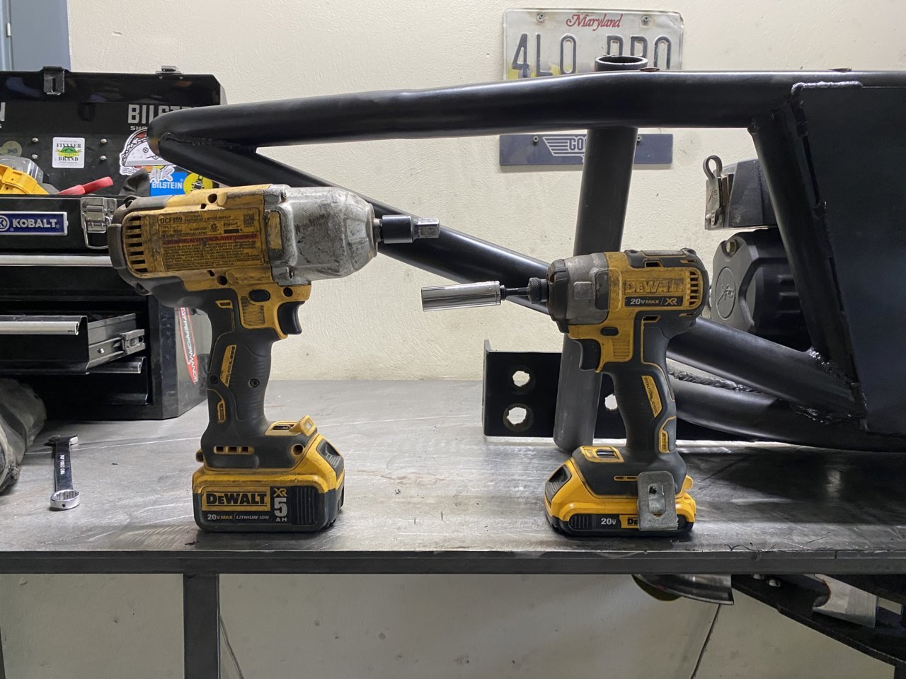

    Is it 1/4” drive? I would say the 3/8” or smaller 1/2” drive would be better for a truck one. I have a 1/4” and it’s great, but it is limited.

    Its the 1/2 inch drive iirc

    If it’s 1/2” it’ll be great. Even the 3/8” is handy. They might not be the strongest thing on the block but will cover most of what you’ll be using it for as a truck impact.

    Biggest issue Ive found is that I cant find dewalt impact bits locally. I purchased craftsman because thats all i could find
