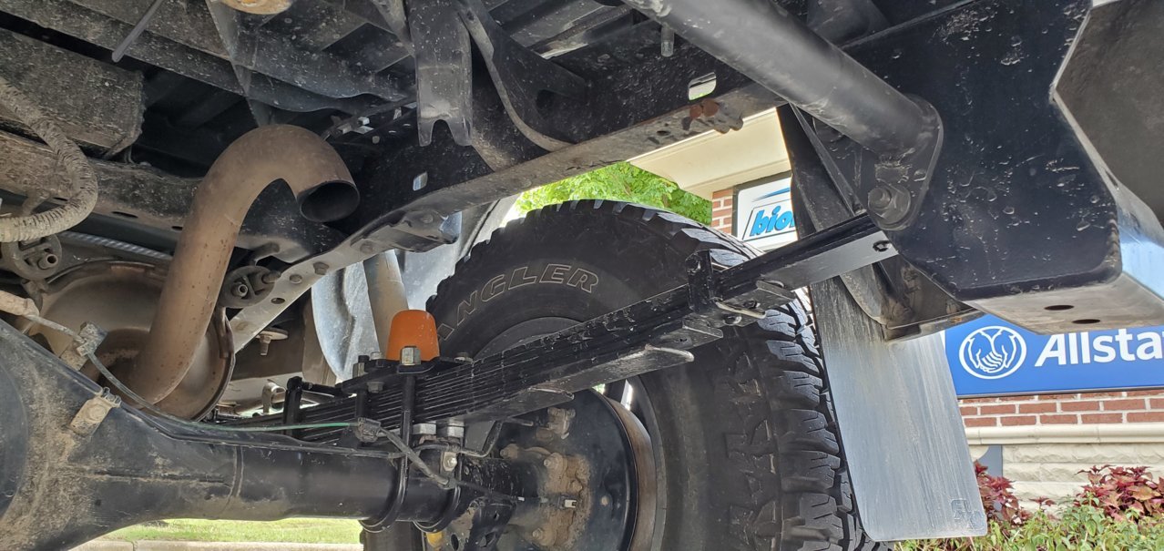

    Free and clear with the Dobinsons Heavy Leafs

    It's only an issue when you get them really drooped out, because the dakars fan out and the second leaf gets bound up in the shackle. I was delighted when I finally trimmed it back and the popping and clunking stopped offroad. I think the dobinsons are a good alternative according to eric.

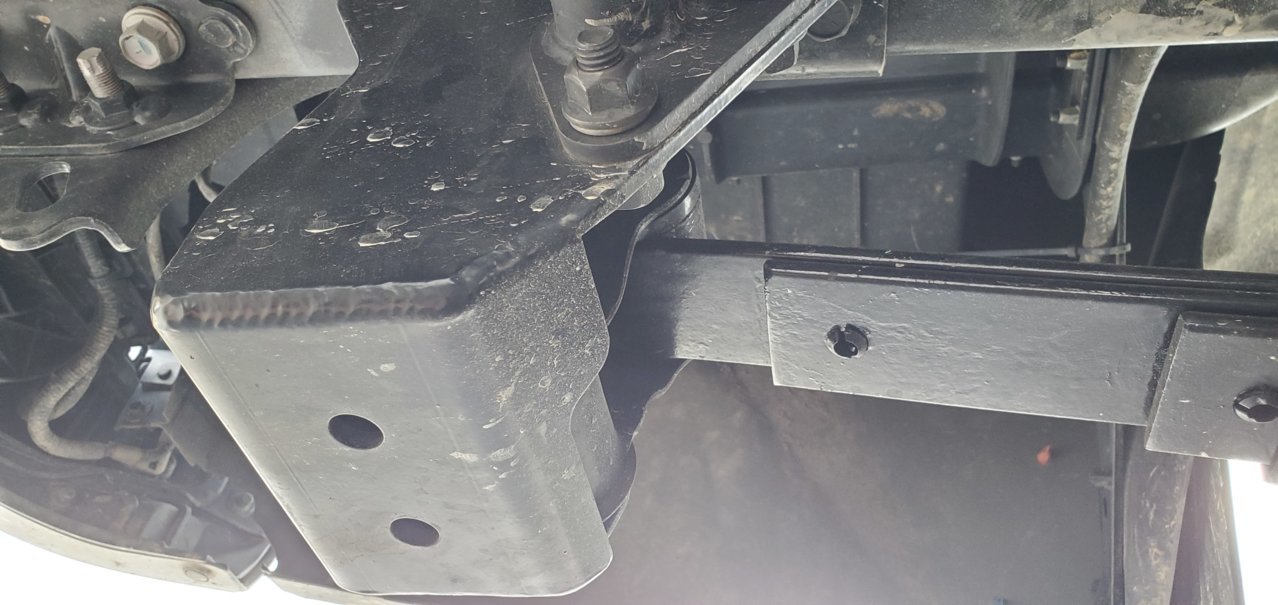

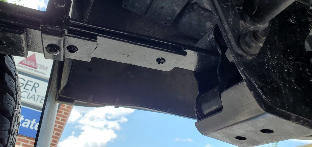

    20200710_123409.jpg sorry no full droop ability at the office parking lot!

    Much much better than dakars. Dakars second leaf would be back in the shackle in that pic.
