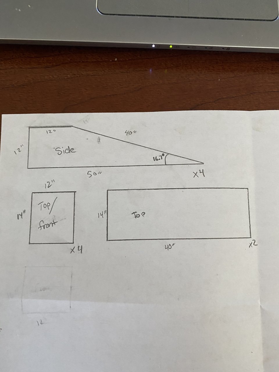

    Pic of said design. Curious mind, here.

    I just drew this up (to scale) to see if I could get it to nest on my sheet. Doesn’t show the internal support I would’ve added.

    Cool.
    What are you thoughts for internal support. The same Side panels, inside? Single or double? Thought of using tube?

    I would’ve made an X in the front cube. On the ramp, probably just add some angle iron to act as a spine so it doesn’t deflect.
    It would be easier to make one of these out of angle iron, or a mix of both but was going to see if I could make one with what I had on hand. Since I can’t model it in cad and see it’s strength, I would just overbuild it so I know it would support the truck with no drama.

    Looks suspiciously like a jump ramp....

    Last thing you want is drama when dealing with ramps or floor jacks!
