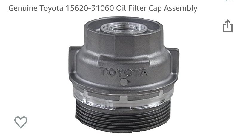

    I appreciate it @2016Taco4Me, I’m gonna order the wrench (and metal housing) then do another oil change when I get it in. I’ll call it a 45$ learning experience. @ilubtimmyhos a huge socket might work but I don’t have one big enough for it. This one is almost identical, but ours have more fins and are plastic. I tried using a hammer/extension to knock it loose and broke one fin so decided to stop before I cracked the housing and was out a truck waiting for the part. The drain plug was almost hand loose but it seems like super glue was used on the housing haha. 0A3C3CF0-B6DE-421A-8844-CFAAD9AB6E49.jpg

    This is certainly not a cheap option, but I just ordered one of these for each of my Toyotas. One more overtight drain plug in the filter housing and I think I'd loose it :wink:

    There are torque specs for both the oil filter drain plug and oil filter housing. The torque spec is also stamped on the bottom of the filter housing.
    Oil filter cap torque:
    25 Nm / 18 ft lbs
    Oil filter drain plug torque: 13 Nm / 10 ft lbs

    Didn't help last time on the Wife's Truck. Torqued to spec and after a few months, I couldn't get the drain plug out even once I removed the Filter Cover. Didn't want to crack the plastic filter cover in the vice, so just left it alone and ordered up the replacement. Should be here in a few more days, so I'll only have one more really sloppy change.

    Do your self right and get the aluminum housing and the wrench. Even with the tool I ended up breaking a tab and had to learn the hard way through a second oil and filter change once the housing arrived. Folks in the dealership shop either used an impact or just uggadugga'd way hard. Here's the one I got.[​IMG]
