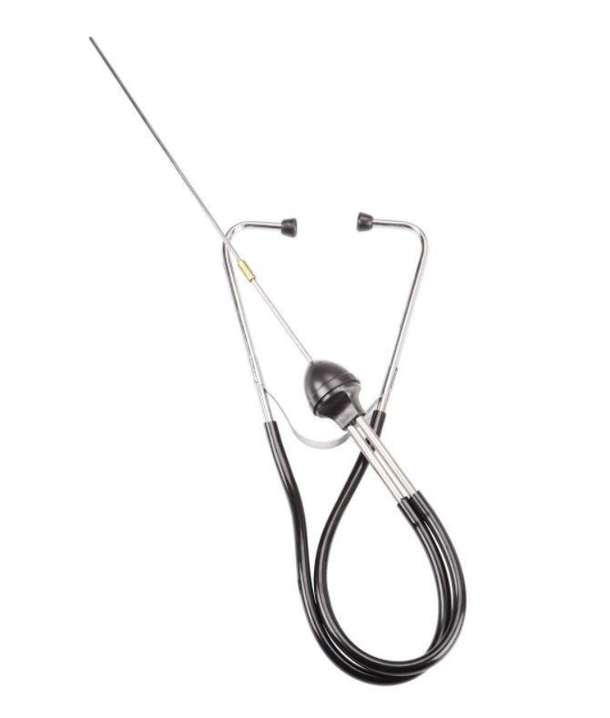

    Yeah an O2 failure is typically caught as a short/open by the ECM now and you'll get the relevant code. If you want to check for exhaust leaks, get a cheap stethoscope from Harbor Freight and a 3' section of brake tubing. I like to add a ~60 degree to one end and insert the other end in the rubber tube of the stethoscope. Then just point the end around the joint with the truck cold before the exhaust has had a chance to expand and you'll hear pretty obvious popping when you find a leak. It's a super accurate method and you'll know where a leak is within about a quarter inch.
    Those clamps are typically good to go for exhaust but if you do get a leak, I've definitely shored some up with the high temp redish RTV... just pull it loose, hit it with alcohol and a brush to clean it up nicely, then apply it to the pipe and reassemble. Be sure to get it nice and tight and let it sit to cure a little before you fire it up.

    Thanks for the info. I like the idea about the stethoscope, I'll pick one up. Trying to visualize what you are describing with the screenshot below of the HF scope, would I just add the brake hose to the end of the metal tube?

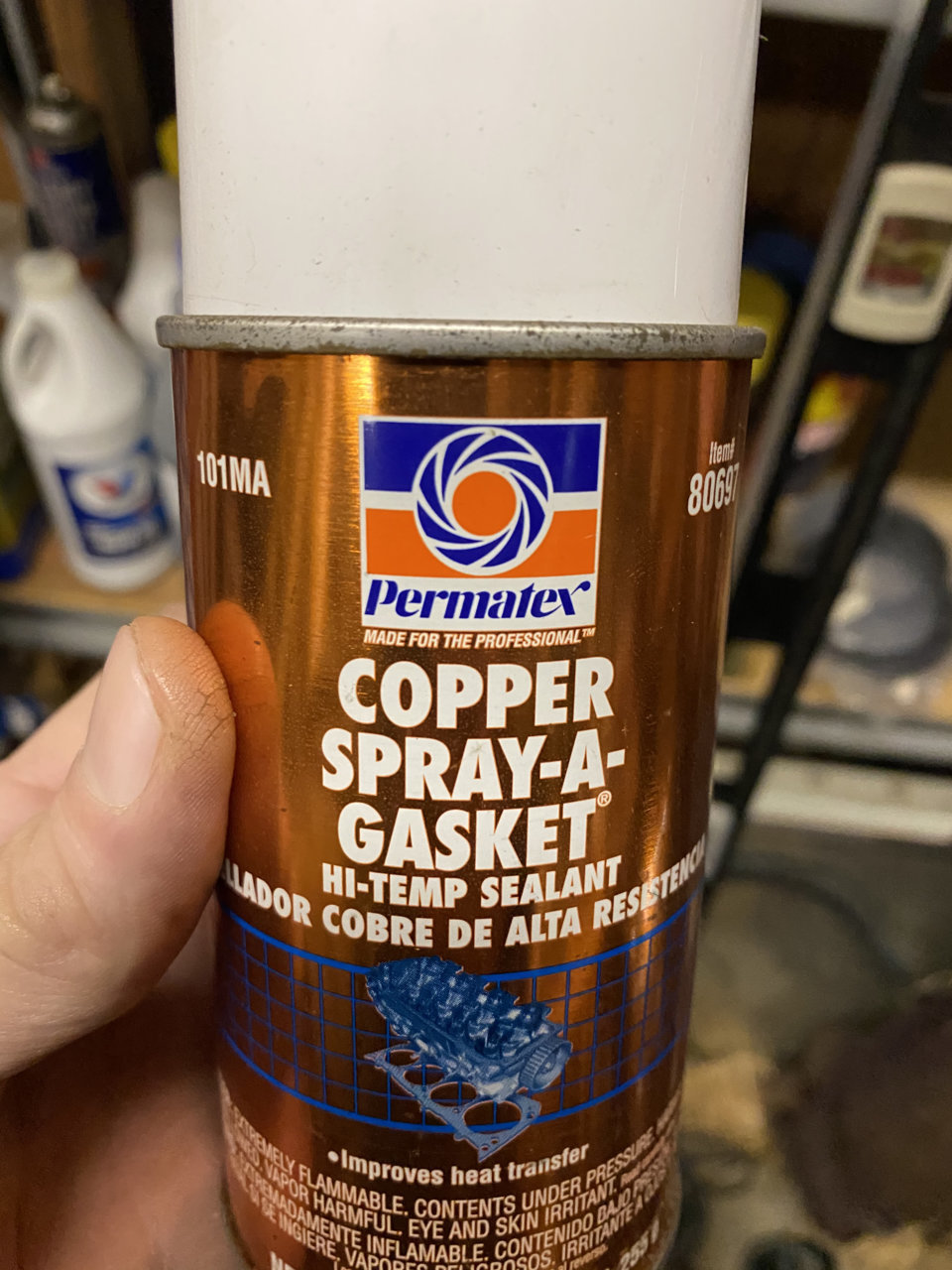

    Skimming thru and checking in..
    I had good luck chasing very small exhaust leaks with this stuff over the many years of messing around with exhaust systems.
    This is good for the real small minor imperfections in exhaust pipe mating surface and pipe ends. manifold gaskets and even the old doughnut that went between the collector and down pipe. Hell, do they even use those anymore?.
    just throwing it out there.

    Ah yeah you'd need one more like this one from Lisle on Amazon. Just remove the entire black end piece and slip the tube inside. If it slips out, even better because the metal feeler is good for picking up noises inside parts (like which lifter is ticking) by just holding it to them.
