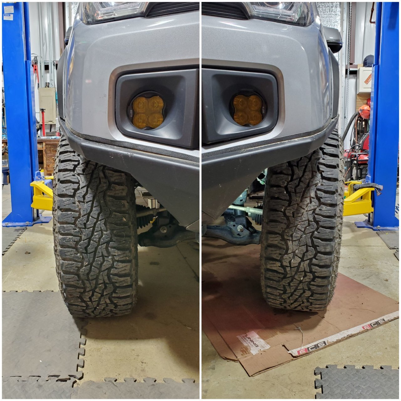

    Between the SPC uca setting and trying to keep as much positive/forward caster.
    This is how it compared to the untouched passenger after reseating the ball joint. 20210227_144503.jpg
    I went ahead and maxed camber on uca since I couldn't get the lca ones to budge/need a bigger cheater bar.
    Just trying to do the Taco extra before doing the
    firestone lifetime jam
    . I'm removing the leaf shims tomorrow morning and will try again to break the lca bolts free

    Was this right after coming down off the lift? When getting lowered off of a jack/lift, the tires are gonna be \——-/ until you go drive around and load the suspension up by hitting some bumps and making some turns.

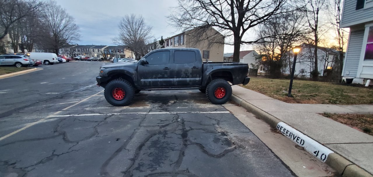

    Speaking of suspension, this stance feels...right

    Yes for initial photo, drove around, readjusted uca ball joint max inward, then it was better, but obviously off, center of steering wheel is at about 10 o'clock for driving straight.
    I'll mess with it a bit tomorrow and then take it in for the free fine tuning.

    Looking good there

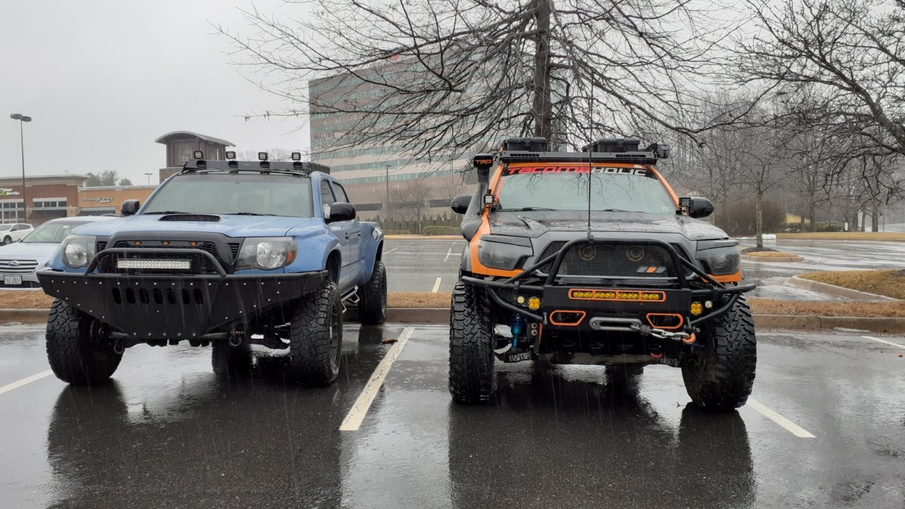

    Cavalry Blue wide body 2nd Gen spotted in Fair Lakes. Anyone on here?

    Is it just me, or does that bumper look like it is straight out of Mad Max?

    Nope. Same thought crossed my mind.

    Looks like it's about to eat something.
