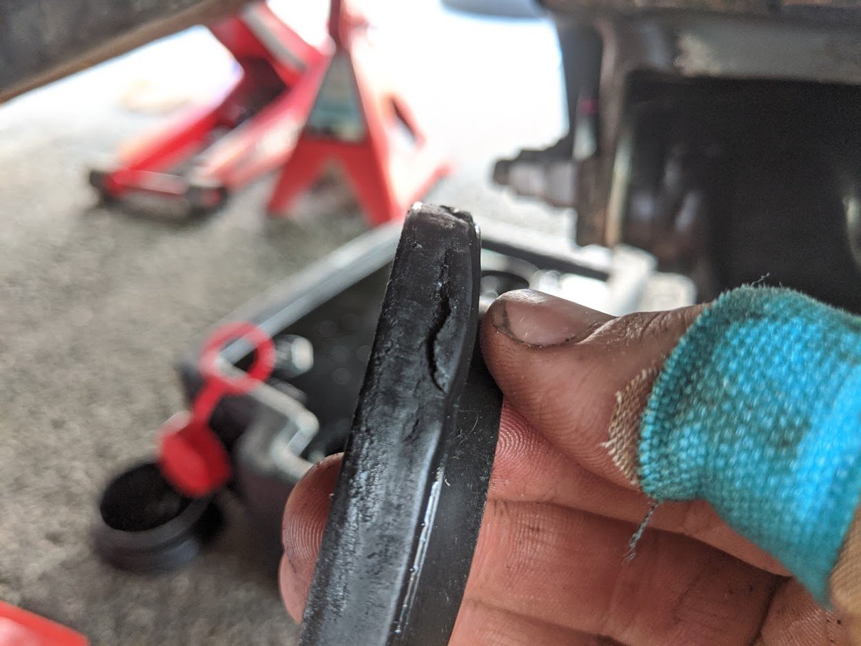

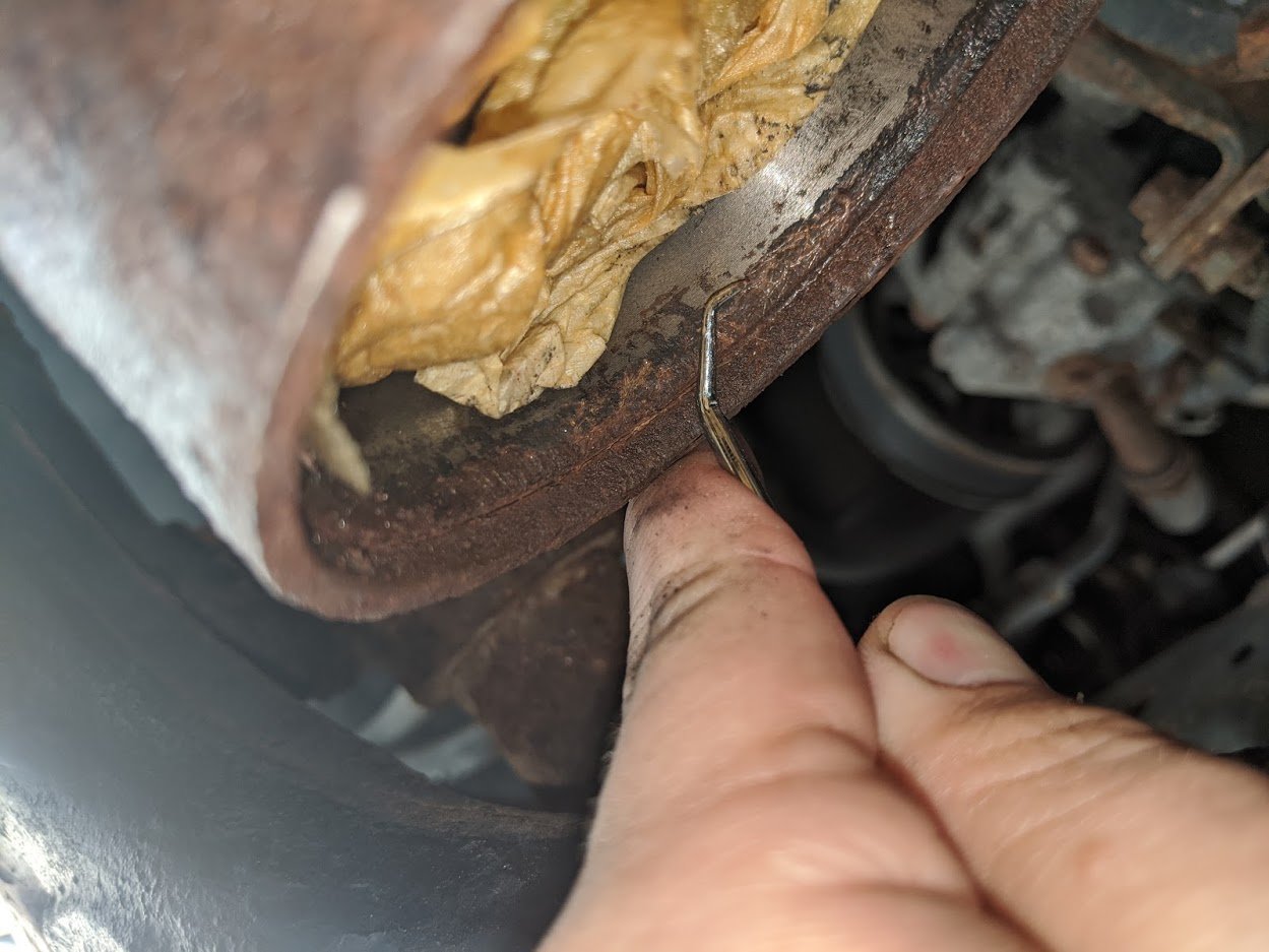

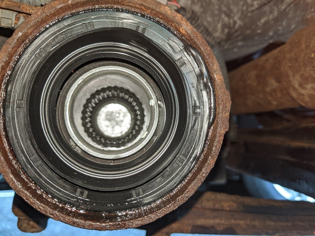

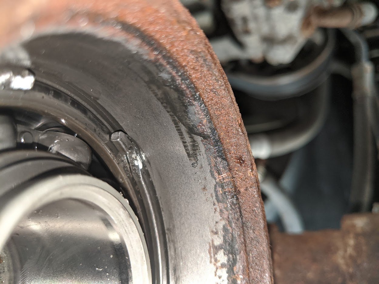

    Yeah lol they were not fun. My main issue was not actually with them sealing around the CV, but when I drove them in, they kept tearing on the outside edge. Found out there was a crusty rusty ring of garbage that kept tearing them in that one area, so I spend 3-4 hours scaping it carefully with a pic. Can see where the rubber was getting scraped on the housing. If I regear in the future, I'm just gonna buy a whole new front diff lmao

    That looks horribly tedious. Mad props to you

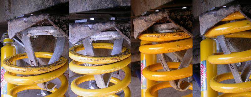

    MC has come a long way in the last several years with their stuff. You'll have to dm me some pix when you install it. I have a set of RK triple rates and prefer the linear myself. That said, Before progressive springs hit the market years ago, Land Rovers would run dislocation cones for the linear. this allowed the spring to unseat the spring bucket for max articulation. Then guide/reseat the spring back into normal position when compression came back in. The shock it's self would be the final limiting factor. Some ran the cones, and lot did not, because of the loud bang when the spring reset it's self.
    Pic below is of one brand that had a hook built in to catch the spring when the arc (left to right) of the rear axle maxed out if the shock was built for more down travel than up travel. or just plain broke.
