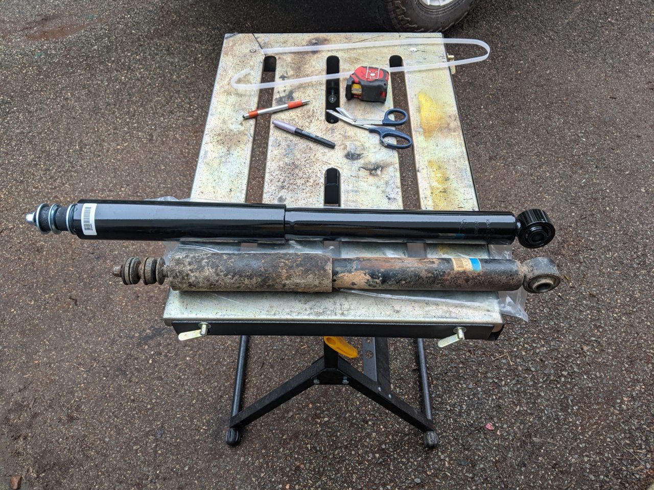

    It's 3" lift. It's the dobinsons "long travel" rear for the 4runner, so they're 12" shocks in the back. Stock is like 6" or something

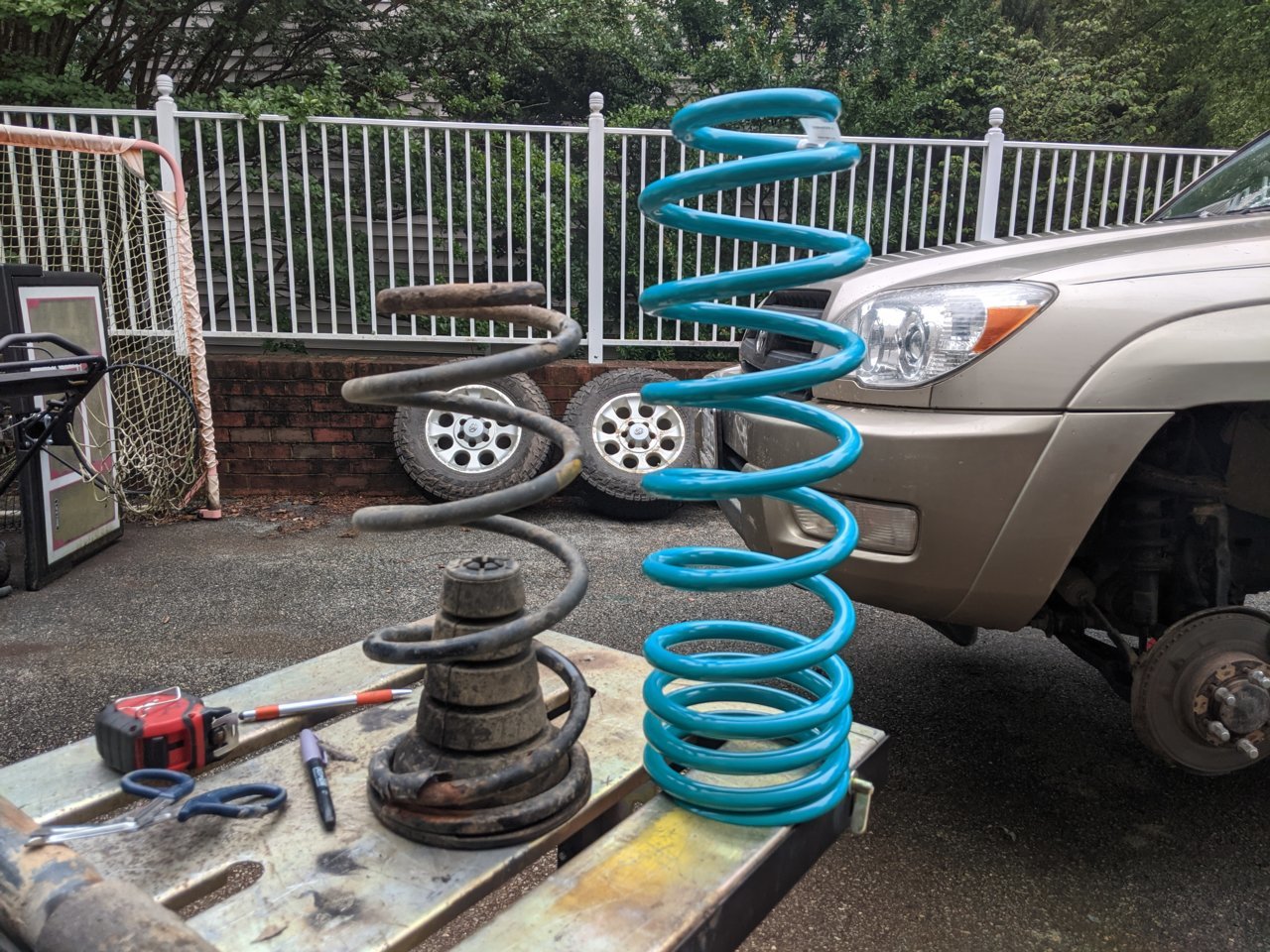

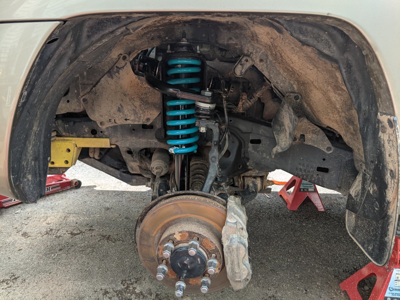

    Coming along. Hopefully it's ready for me to go to work tomorrow lmaoPXL_20210613_150656283.jpg
    Edit: got both fronts done. Was easy once I figured out which bushings to use from the shocks and new tophats

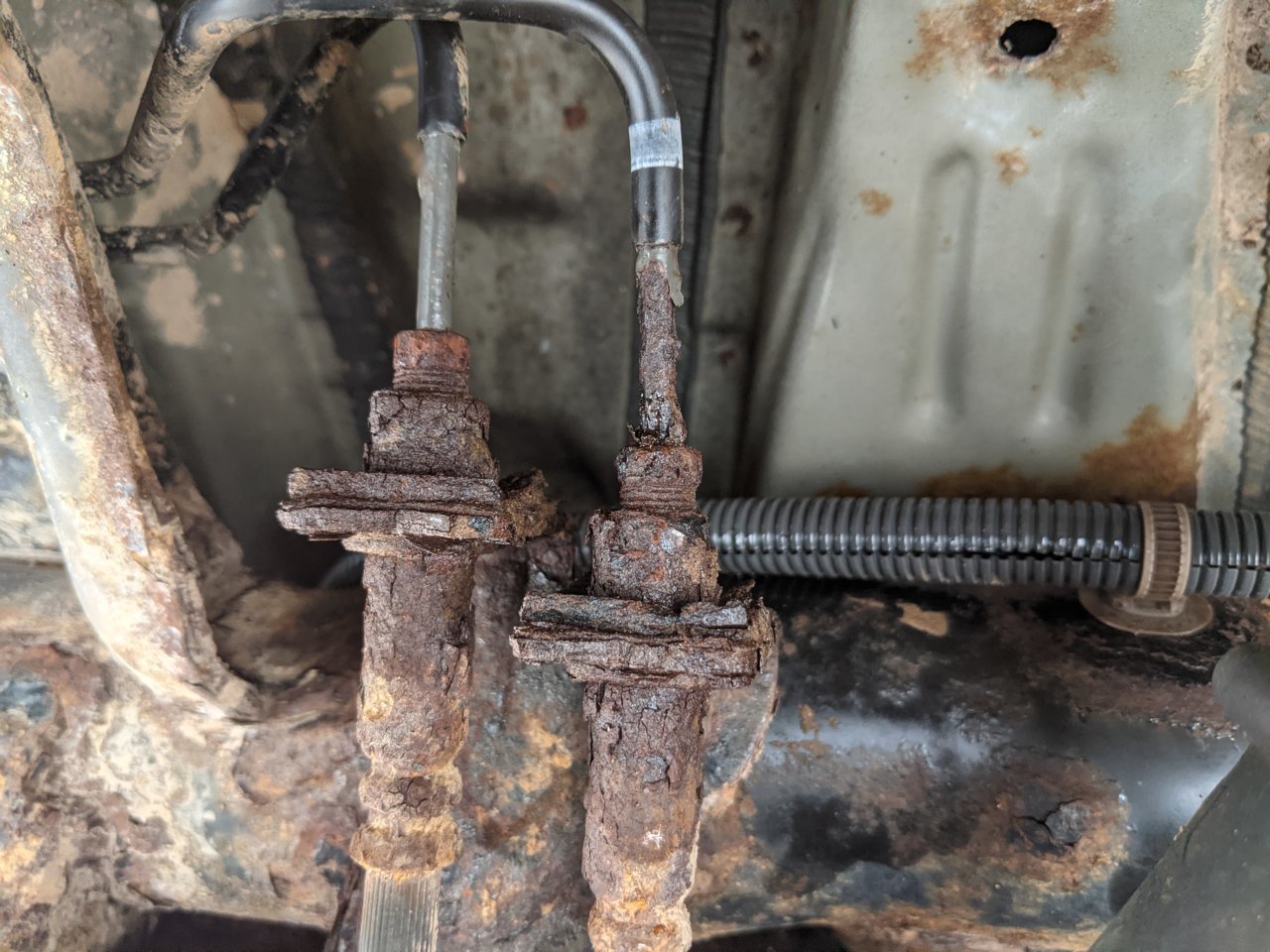

    Well crap, rear brake hard lines were kinda crusty where it goes into the soft lines over the axle, and need to replace soft lines with longer lines (which I do have) for the dobinsons. I'd feel better just ordering the hard lines that run along the frame and probably the axle ones so it's all fresh. I traced the lines back to the booster and they all looked okay, so just need the rear section that disconnects halfway down the frame.
    This 4runner has some places of the frame that are really good, and some that are really bad. Beyond the rear axle is one of the rough spots, so the lines were right in the bad stuff. Where lines connect halfway up frame, everything is mint and factory paint all there no rust.
    I've got alternate transport to work, so I'm all okay there
    They're wet from pb blaster soaking, not from leaking fluid but here's a crustnado pic
    edit: Brake lines can be had in at fredricksburg toyota for $120 for all lines going to the rear, the lines along the axle, and the flex line brackets. I already have the longer flex lines, so now will have all fresh lines to the rear
