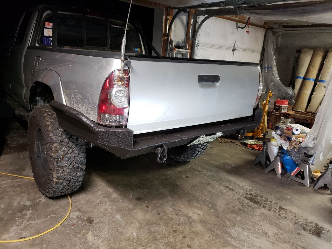

    Yeah I had those on my old bumper, but the current bumper won't work for them unless I drill a bunch more holes:
    fatfurious2[QUOTED] likes this.

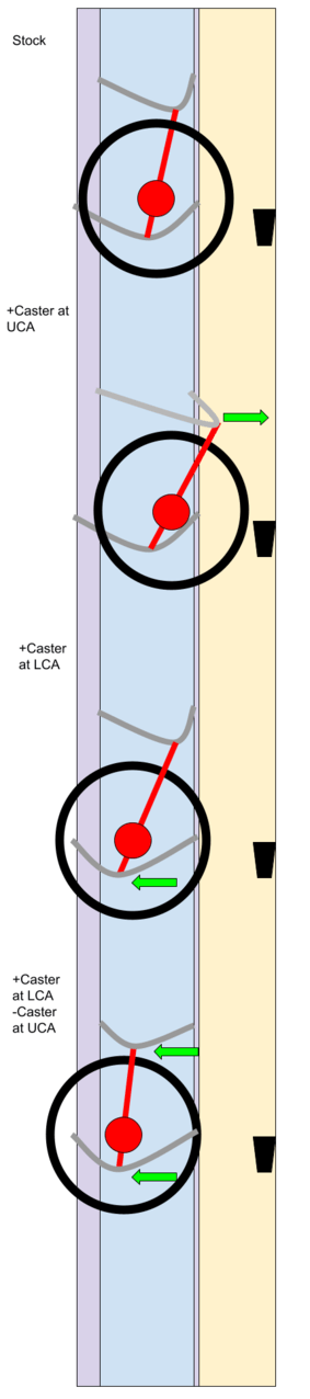

    I have SPCs and will admit they're kind of a pain to make small adjustments to the UBJ slider, but not terrible. They did move on me a tad the first time I set them up because I didn't tighten the nut satisfactorily, but that was user error. The ball joints are pretty expensive to replace, but I do have a set of BNIB Tacoma SPC UBJs I need to offload if you find some nice used arms or something lol
    Caster is kind of a loose term that gets thrown around and associated with body mount clearance, although the caster figure itself isn't the whole story. Caster is really just the angle of the spindle floating in space, and doesn't necessarily describe the wheel position without knowing whether its coming from the LCA or UCA
    JBA and similar fixed arms add caster at the UCA, which can bring the wheel back in the wheel well to get the 3-4* caster target. Then the user can either set the LCA to stock neutral position, or forward for even more caster from the LCA, increase in overall caster, and bringing the wheel a tad bit forward. But because the UCA is fixed, setting the LCA all the way forwards may misalign the camber and put the bushings in a bind
    With SPCs to fit larger tires, a lot of people will subtract caster at the UCA to bring the wheel more forward, and also add caster at the LCA to bring the wheel all the way forward. -caster from the UCA and +caster from the LCA will provide the most firewall and body mount clearance, but at the sacrifice of overall caster and also putting the LCA bushings in a tad bit of a bind. Of course, you can also just add caster at the UCA like the fixed arms
    Not necessarily a right or wrong way to do it, just food for thought
    a kind of exaggerated/not to any scale picture, but may explain added or subtracted caster at LCA vs UCA better than just words.
