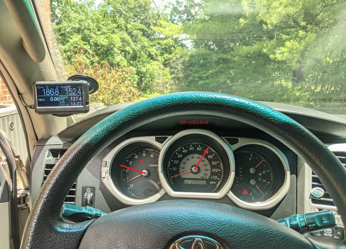

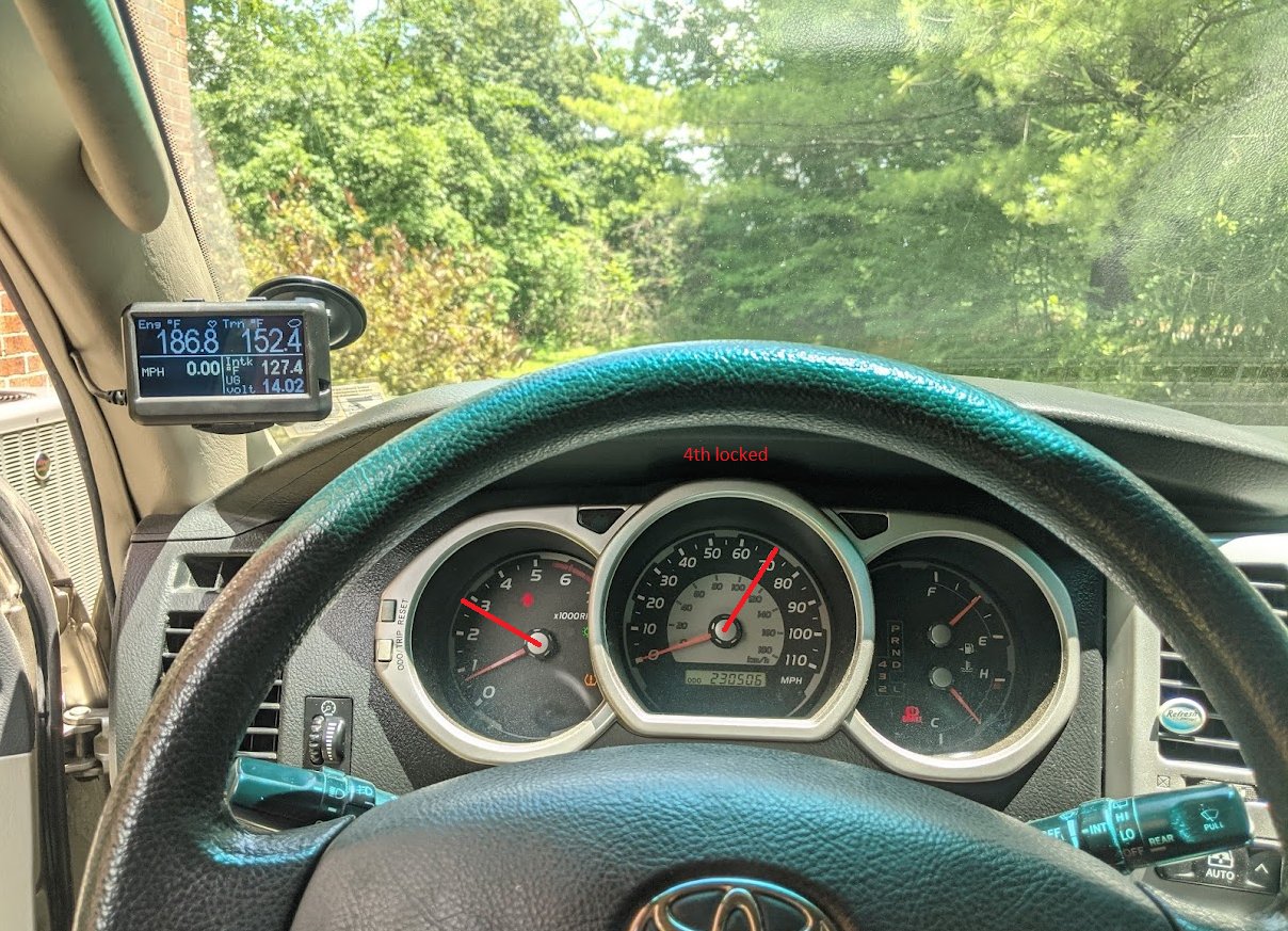

    Like other mentioned, keeping under 200 is ideal. I have my alarm set to 205 (4th gen 4runner, so a750f like the 2nd gens). on I81 past Roanoke it gets pretty hilly and it can climb above 200, which is one of the reasons I'm installing a trans cooler hopefully this weekend to bring those down. Also above 200, the shared trans cooler/radiator will bring engine temps up too and heat soak the radiator making it harder to bring both temps back down. On flat highway, it will stabilize around 185ish, but once it gets up in temp, it takes a while to get back down
    For an automatic and controlling temps, its also important to understand the converter lockup. When the converter is locked, engine output and trans input spin at the same speed. When unlocked, the engine output and trans input spin at different speeds (think not locked together). When the converter is unlocked, the speed differential inside the converter will build heat quickly. Ultragauge does have a metric for this (1=lock up, 0=unlocked), but I find it to be wildly delayed and inaccurate. Instead, I usually watch the tach and when the converter unlocks, you'll notice rpms jump 200-300 without speed changing. When it drops a gear, you'll jump usually more than 500rpm depending on speed and notice speed increase a bit. Also with the converter locked, you'll notice a more linear relationship between throttle position and speed. At least on the a750f, the converter will lock in either 4th or 5th (OD). In 5th it will unlock if you even look at a hill funny. I then usually manually down shift to 4th if its a big hill, let off pedal for a hot second for the converter to lockup, get back on it, and it will zoom on up without building too much excess heat. in 4th, it will hold lockup up even super steep hills
    Its probably a similar for the 3rd gen tacomas just with an extra overdrive in there. I think might have the +, - thingy instead of the individual gates for each gear, but should be the same deal
    example of the rpm stuff (ignore trans temp in this pic, wasn't from a really long drive):
    5th locked
    5th unlocked
    4th locked
    4th unlocked

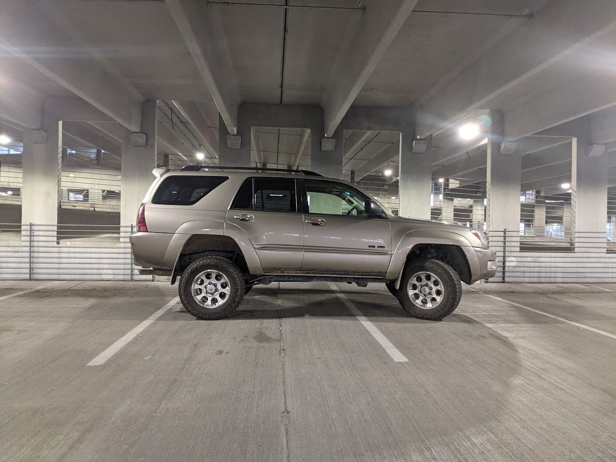

    yeah these little af tires haha

    But with those tires the truck still looks really good
