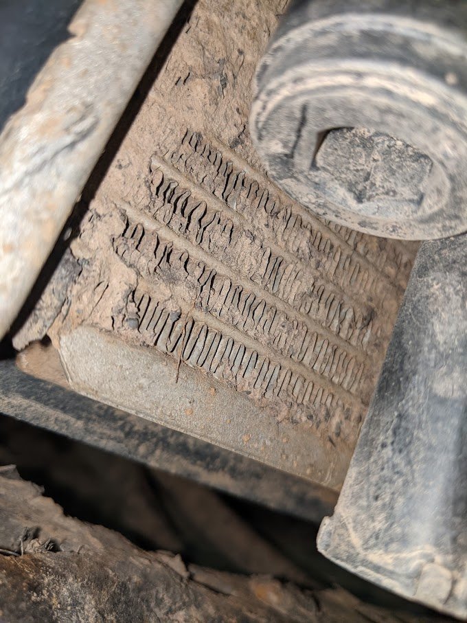

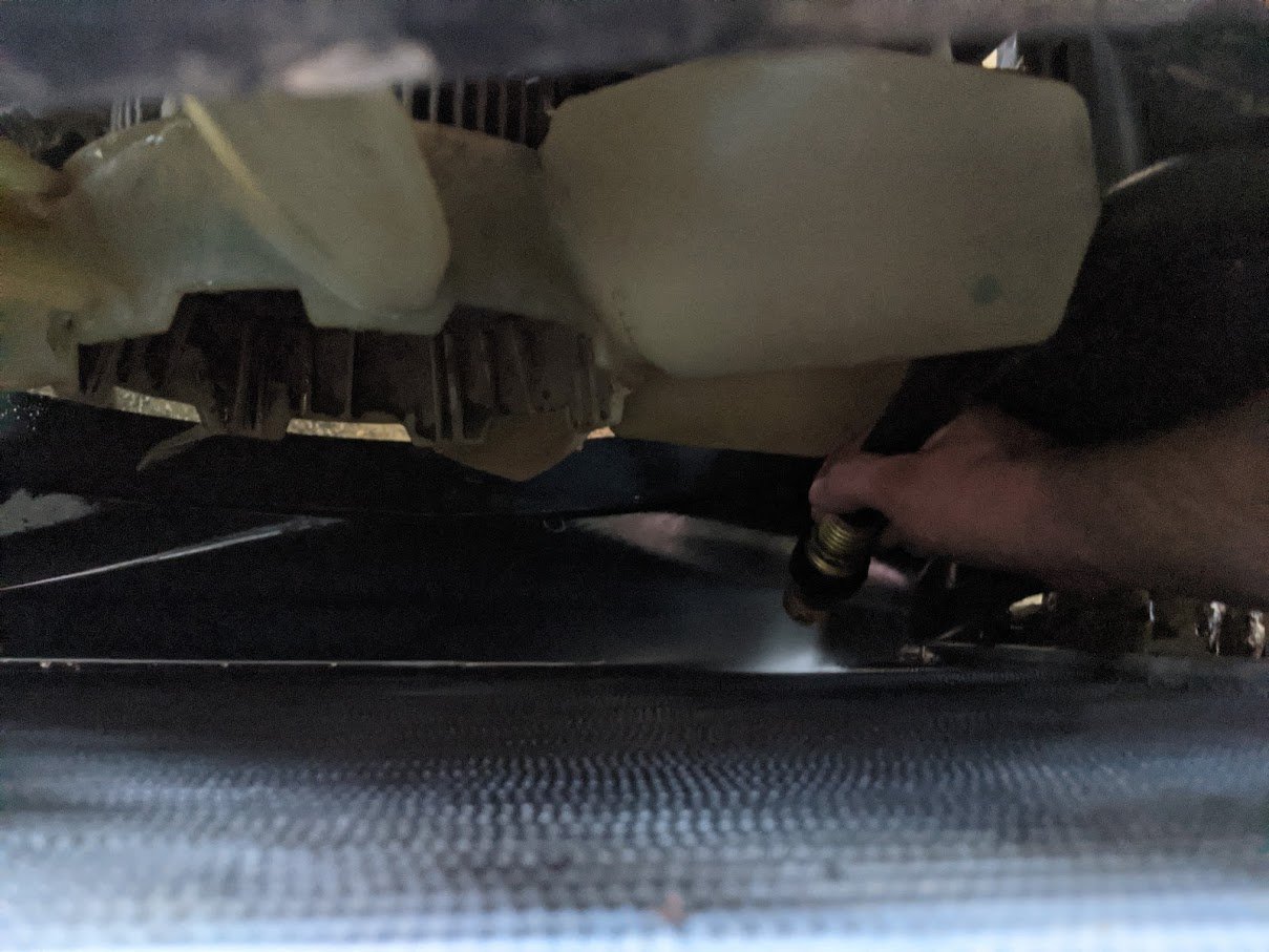

    I agree, cleaning the radiator is a good start. I dropped engine temps like 10 whole degrees and trans temp probably similar after cleaning mine. Mine was pretty caked. I removed the shroud and flushed from the backside, so it would come out the way it came in.
    Do 3rd gens have a transmission cooler? I think I read somewhere that that some do and some don't. After I installed mine, its definitely overcooled now but stays around 165 once warmed up and I can ride with converter unlocked up huge hills without even seeing 10* temp increase. I'm looking at plumping in cooler bypass with thermostat now, so it seems to be neverending haha.
    A smaller one would probably work well in addition to the one built into the radiator to bring temps down without overcooling
    gHGP1NGMecLlHoPQaglCJr55HrQ0MTHbseb1-Hur_e7331f8188b7bd58ccd3b79ea3ee298a818bbf82.jpg LSvXE1K0WlLpA_yCYIB43wdOETuoC1DXvJWDRd79_fc39139e43c78bc0f583d715c98b2d4e15702fa3.jpg

    Yeah my OR 4x4 has the towing package and trans cooler, it had a few decent sized bugs in it and a few in the main radiator fins, but not like it was caked up.
    Didn't break down the trim or front grill to spray behind, but got my littler hose nossle in and sprayed it down, figured I'd see how this does.
