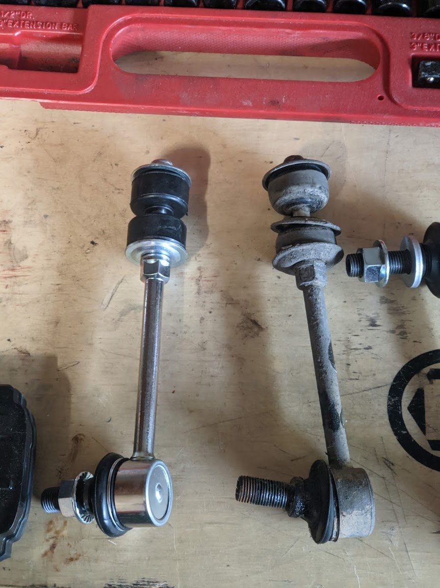

    Everyone keeps telling me to do it, I've never heard of it till recently! It's on the list. I replaced the rear sway bar links today. Old ones were oozing.

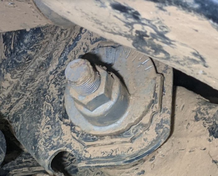

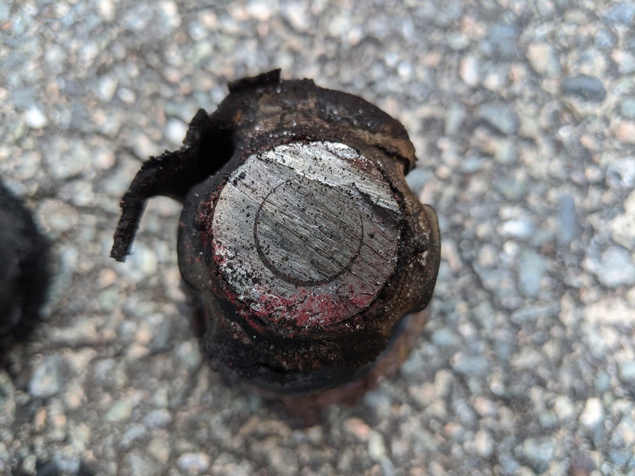

    Do you have new LCAs or bushings? The cam bolts usually seize to the inner bushing sleeve, so kinda takes them out too. I did mine last summer, so let me know if you have any questions
    If you have to cut them out, use Diablo Speed Demon Carbide Blades for Thick Metal in a sawzall. The material used for the cam bolts is really hard and will eat up any regular blade
    I've also got a little writeup on replacing my cam hardware and LCA bushings with some pictures: These are mine with 208k on them lol
    38sC_KR41JFPUDtEq3USewxQ8YXqN0cSYHPmiWik_b4d96af9401370e43a33c995968fceed529d0037.jpg
    kL7sTjsu90ci2v4V0RhcA9XPRPxfTGyKjzezsB5g_ed61bb47c1d8bf45f83d021b0fd3b4ddcd6a49b1.jpg

    Mine don't LOOK bad, but who knows. It's a fairly clean vehicle so here's hoping.

    those look mint to me. Mine were pretty crusty lol
