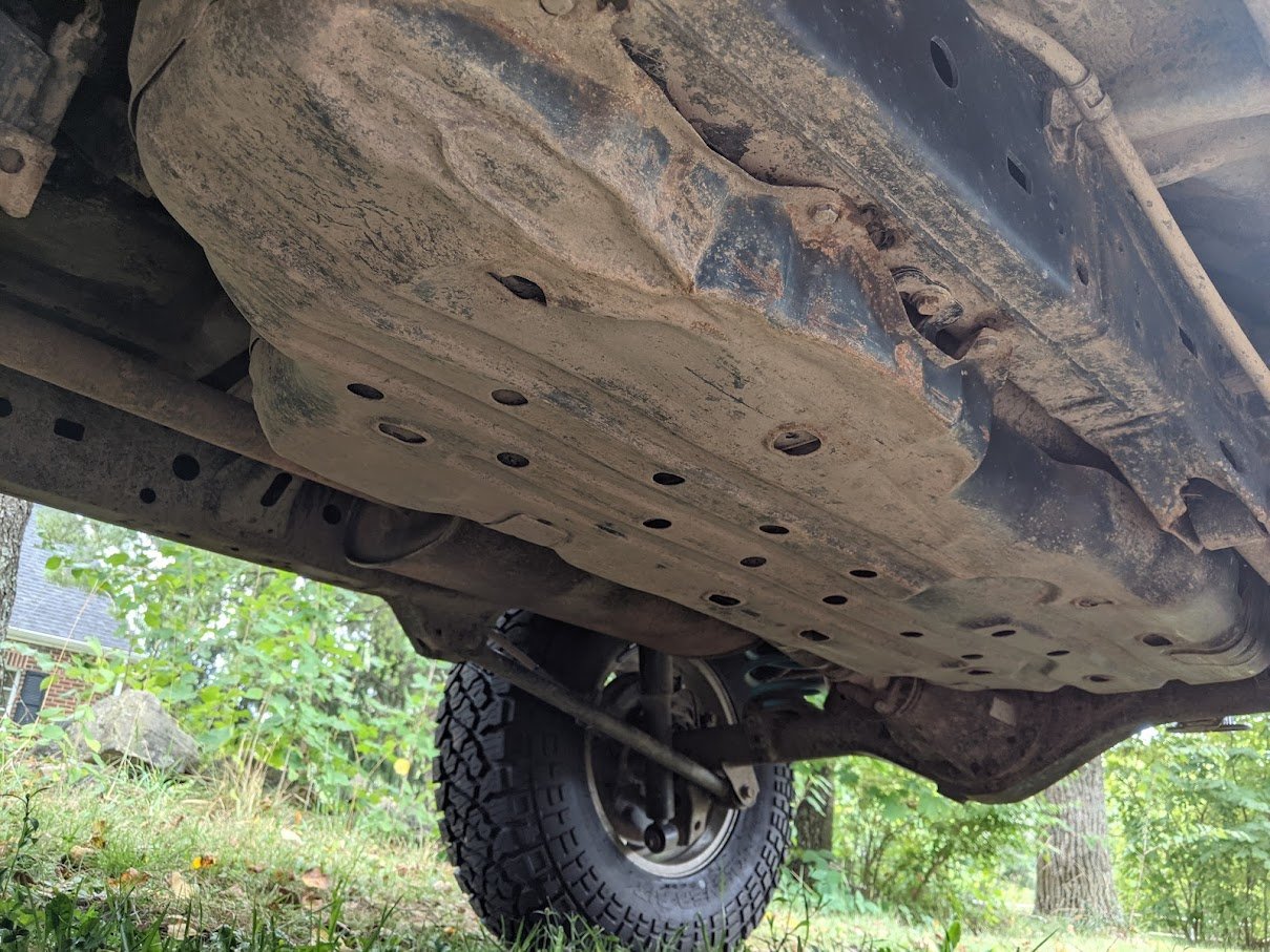

    I think my fuel tank might be a bit borked. needle was literally on/below E and it only took 16 gallons to full on a 23 gallon tank. Stock height was not nice to the tank and skid
    doesn't look hella dented though. noticed the discrepancy kinda after the flagpole trip and I did drag it once there, but not as bad as it has been before the suspension

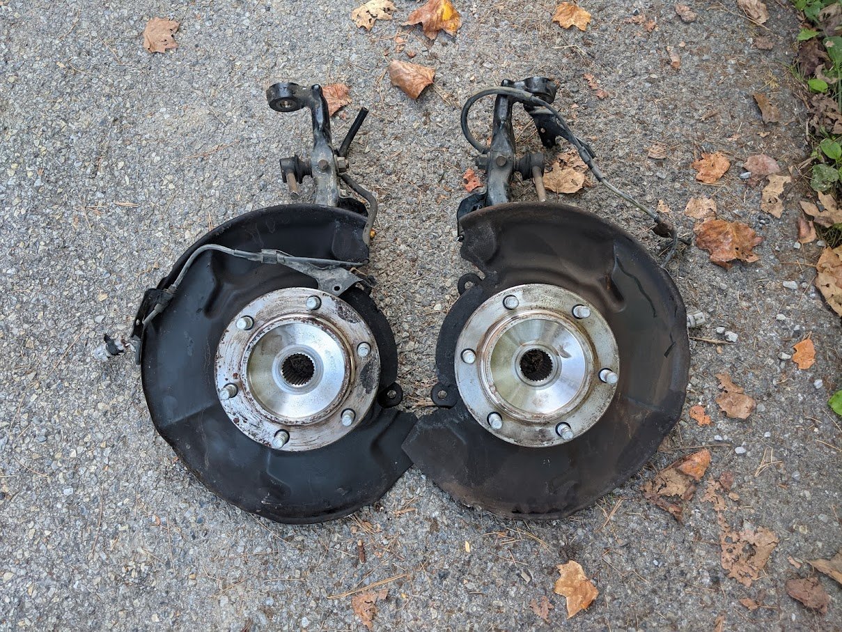

    went and got the spindles today. Was fully expecting (and kinda hoping) I'd have to pull myself, but they were already on the shelf. From an 07 FJ for my 4runner. completely forgot about the other things I was wanting to get because these came with some unexpected goodies. mirrors were really just for the thrill of the junkyard experience since there are cheap ones online, but one more OEM CV axle would be nice so I have a complete pair of replacement axles
    For $200 out the door I got
    • 2 spindles with zero rust
    • 2 wheel bearings (which I'd just keep as oh shit spares, but they are in good condition)
    • 2 dust shields in mint condition (not sure if 319 or 338mm shields, but 338 would be cool if I ever upgraded to the larger size)
    • 2 wheel speed sensors and wiring harnesses
    • All the brake line brackets with no rust
    • 2 halves of a sway bar link lol

    Dang! That's a freaking steal! Are you gonna see if the JD Fab gusset will fit on there or go with the guaranteed fit of the TC?
    y=mx+b[QUOTED] and fatfurious2 like this.

    I heard from another guy that the JD fab stuff will fit 4runners, and the taco vs 4runner spindles are really very similar in overall shape so I think they will too. I also like how they extend over the steering tab doodad. The jd fab gussets are less expensive by 80cents, so thats a win win right there
    Then I was thinking about how you mentioned it was easier to drill before they're welded for the double shear kit too, but I don't think I'm quite to the double shear stage yet lol.
