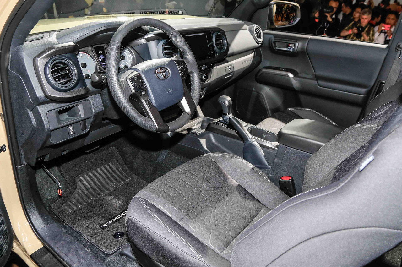

    Exactly what I want to do. My concern is getting to the back side of that panel. Shown here:

    I was able to reach up behind there and just push on it lightly and pop it out. It popped out easily. I also tested to make sure it would go back in and it was also really easy to put back in.

    That makes sense. But how did you fish the wire from the firewall to be able to get it to the switch panel?

    I pushed the hanger through the opening in the grommet and once it came through (by my feet on the driver's side), it was easily visible and I just grabbed it.
