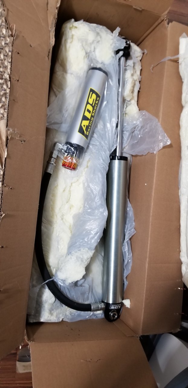

    Got the Deavers and Archive hammer hangers on this weekend, initially seeing 3" of additional lift. Coilovers are going on this weekend, and the smoothies just showed up today, so Phase 3 will be those and the shock relocation towers. The smoothies are massive, the pic doesn't do it justice.

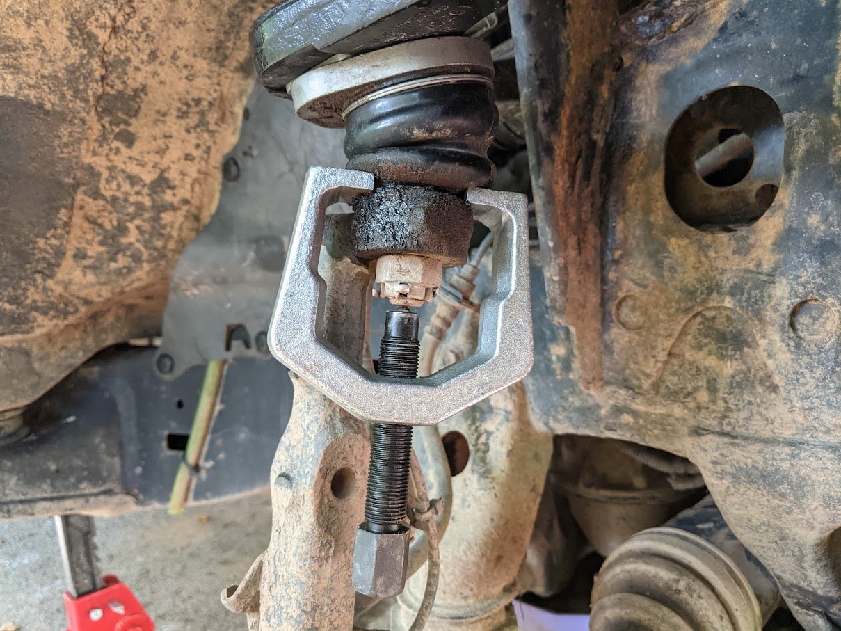

    Shouldn't really need one. If it sticks just beat on the side of the lug where it bolts into the knuckle.
    And that doesn't work there's always the redneck method. Thread the nut on a little and hammer from the stud of the tie rod.

    I used the harbor freight one to do my UCAs
    obviously the nut has to come off, not sure why I have this picture with it on there

    Because you're a nut?? Yuck yuck!
    I prefer the hammer method. Rarely failed me. I have all kinds of separating doo-dads in my tool box and they barely get used. Little knock on that lug with a BFH and pop goes the weasel!

    Problem is that I'm a caveman and I'd probably miss and booger the threads
    And after spending 10years in Pennsylvania, it needs some extra encouragement all the time lol

    The PA factor may change things. Missing does not. I have thumbs that can attest to that!

    I definitely prefer the proper tool. When I first got Betty and needed to replace the tie rod end, the tool was the only thing that got it out. It looked like the one Ryan posted a pic of.

    A hammer is the right tool for just about everything.

    It's only $14 so it's a no-brainer for me to get one. But I'll have a hammer close by just in case lol.
