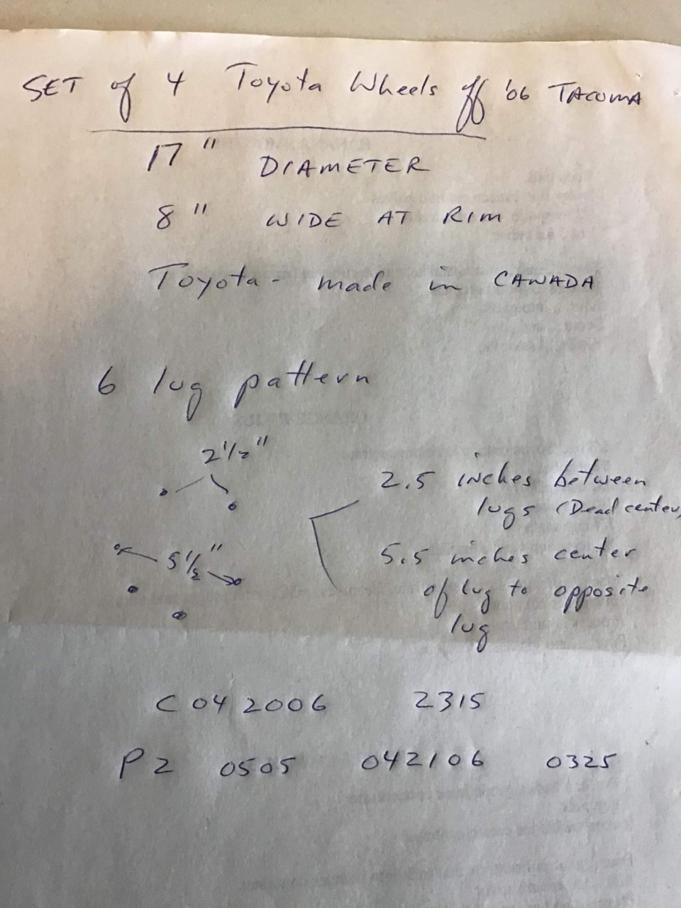

    They are stock Tacoma wheels. Found them nearby on FB. The seller has since said they had TPMS on then, but the previous owner wanted them. I plan to powder coat and use them as daily drivers with the Revo 3's and just my stocks / KO2's for off road.
    I thought the bolt pattern was the same, just wanted to make sure.

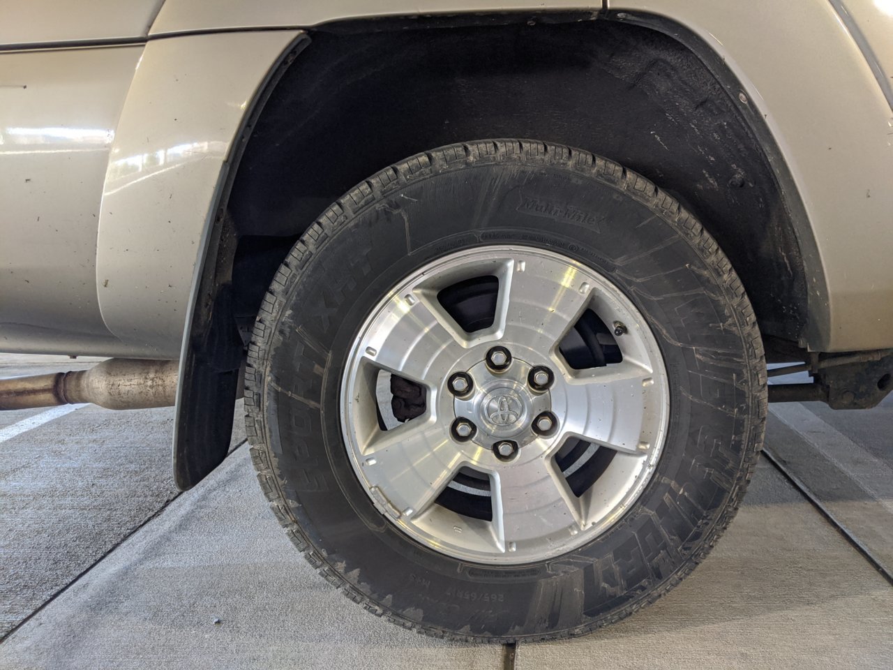

    are they these? They were the stock 17" from 2nd gen tacomas a 4th gen 4runners. New TPMS stuff should fit.
    If they're these, I've got a set you can have for free.99 with TPMS sensors. I think most or all of the sensors work, some of them new in 2016. Although not sure if the older sensors compatible with new stuff, heard different stuff from different places. I even have a set of falken wildpeaks 265/70/17s that I need to offload if you want those too

    That are similar. Can't grab a FB photo from the phone for some reason.

    I thought they'd be the above, since those are 17x7.5 which was similar to the description provided by the seller. I don't think theres a stock toyota 8" wide bead to bead wheel, but these do measure around 8" from outer face to outer face
    If its these, they're 16"s. Which isn't bad, unless you're wanting to but 17" tires on lol

    That's why I was curious on the pic, because the ones you shared earlier are the only ones I'm aware of that would've come stock on a Tacoma.

    Those are the ones, but the seller said they were 17's. I have two 17 inch tires in the basement, so I definitely don't want 16'a. I'll have to double check. Thx.

    The size and maybe offset should be cast in somewhere on the wheel.

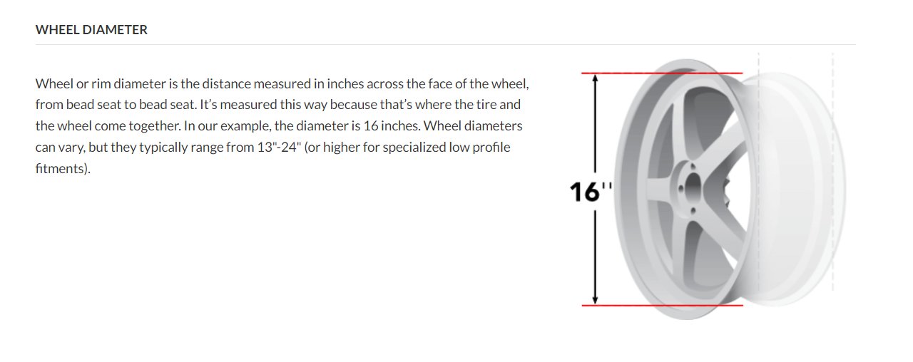

    Good thing this was caught now because those are definitely 16's. It has something to do with where on the wheel that 17" is measured. Lip to lip, a 16" wheel will be about 17". I think it's actually measured at the bead, so it's misleading.

    That's also probably where the 8" wide came from too, since they're 7.5" wide wheels

    I think that kind of seals the deal, or lack of one at this point. If I were starting from scratch on tires, I might do this, but since I still have two 17's in the basement, that doesn't make sense. I thought those would look good with some black low gloss powder coat. The search continues.
