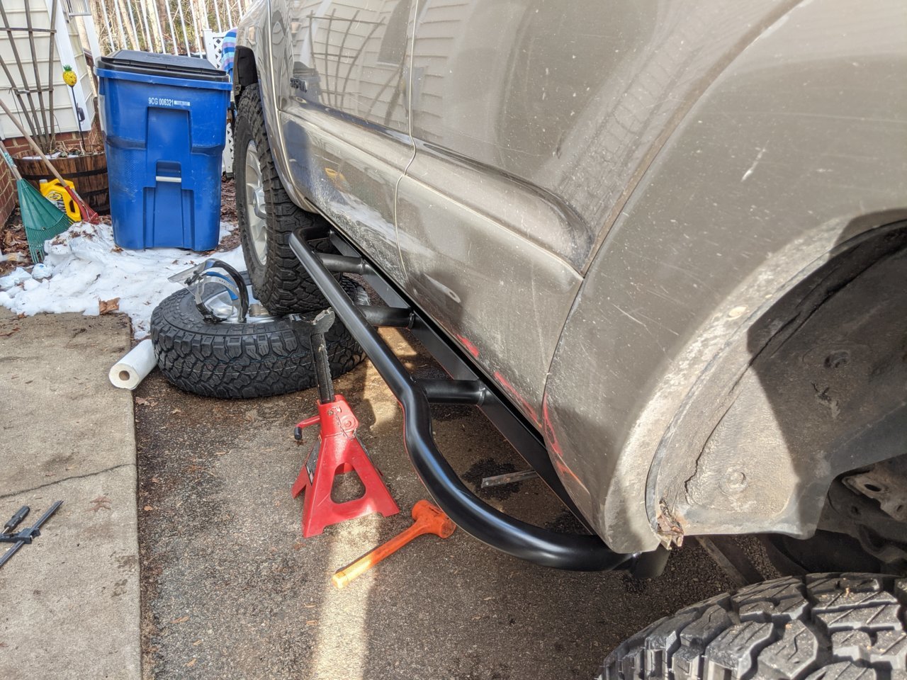

    Snow melted, back to work on the minivan

    Nice work!

    I like your flex ramp

    Thanks I made it myself
    You'll also enjoy my sliders color pallete

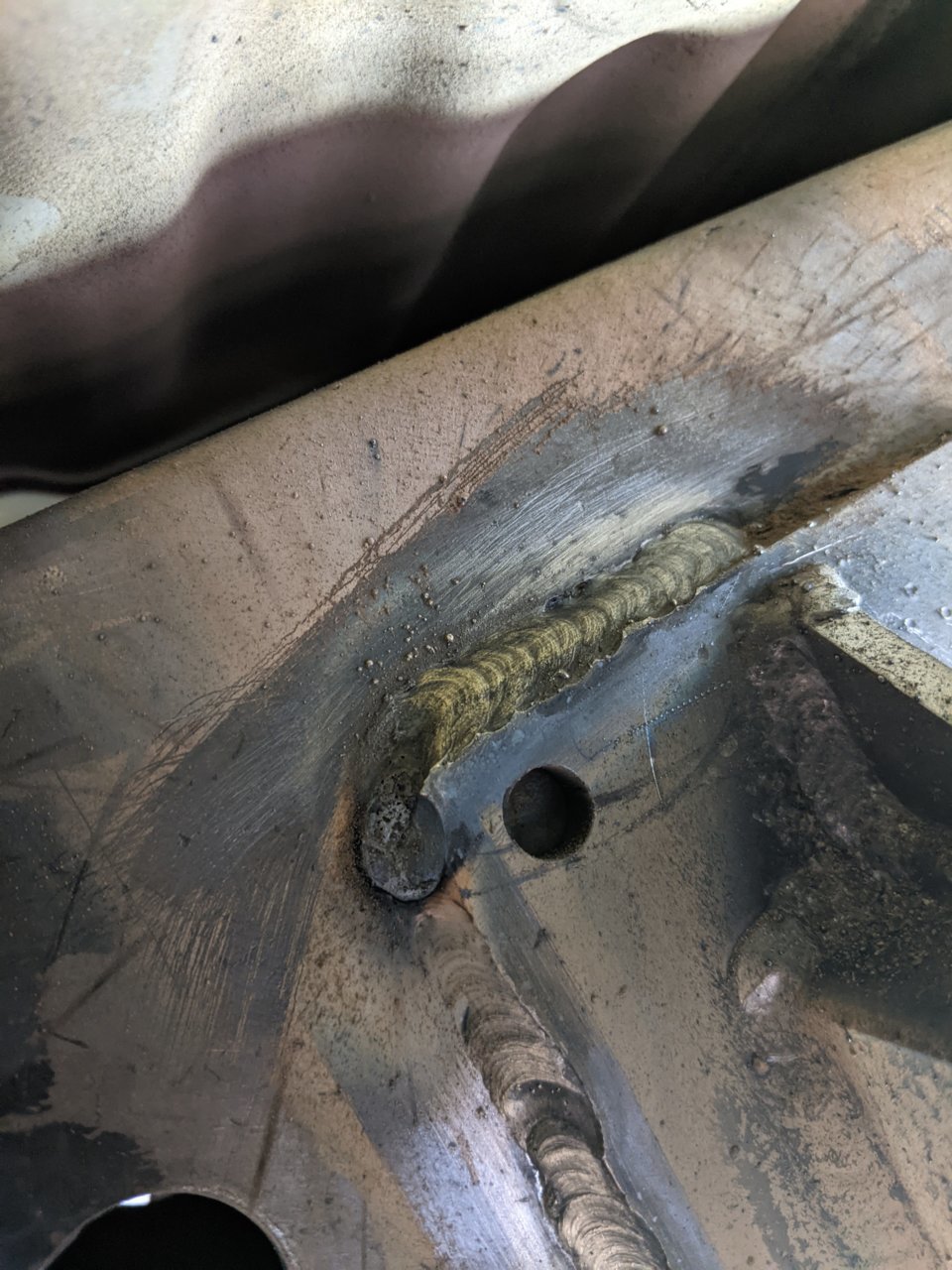

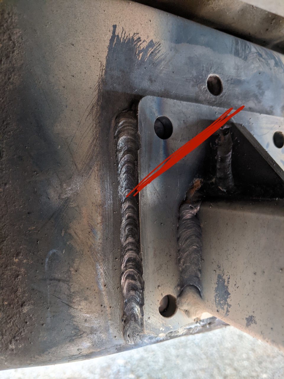

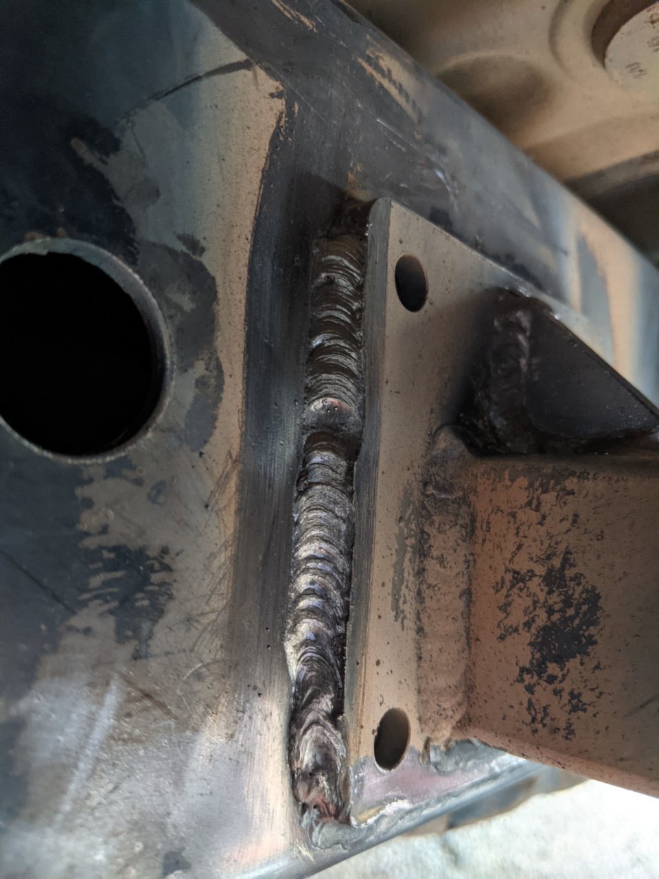

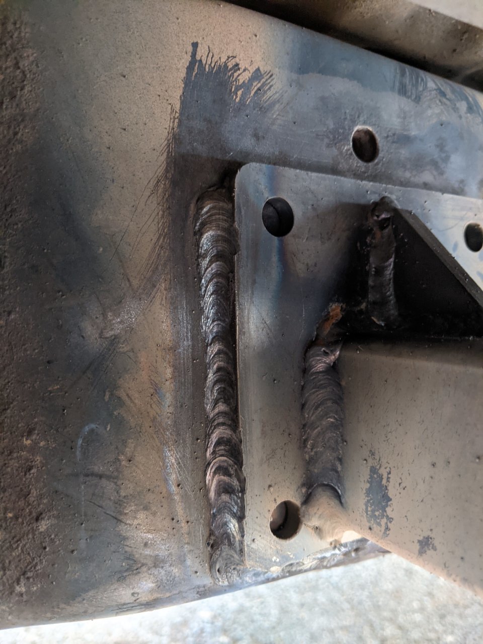

    Not the prettiest, but I think they'll hold alright. definitely cramped down there, so it was some good in position practice. took me all day to do just 1 side, and of course, tomorrow is expecting snow again ugh
    buzz buzz
    this bastard on the top of the plate was hard to get to.

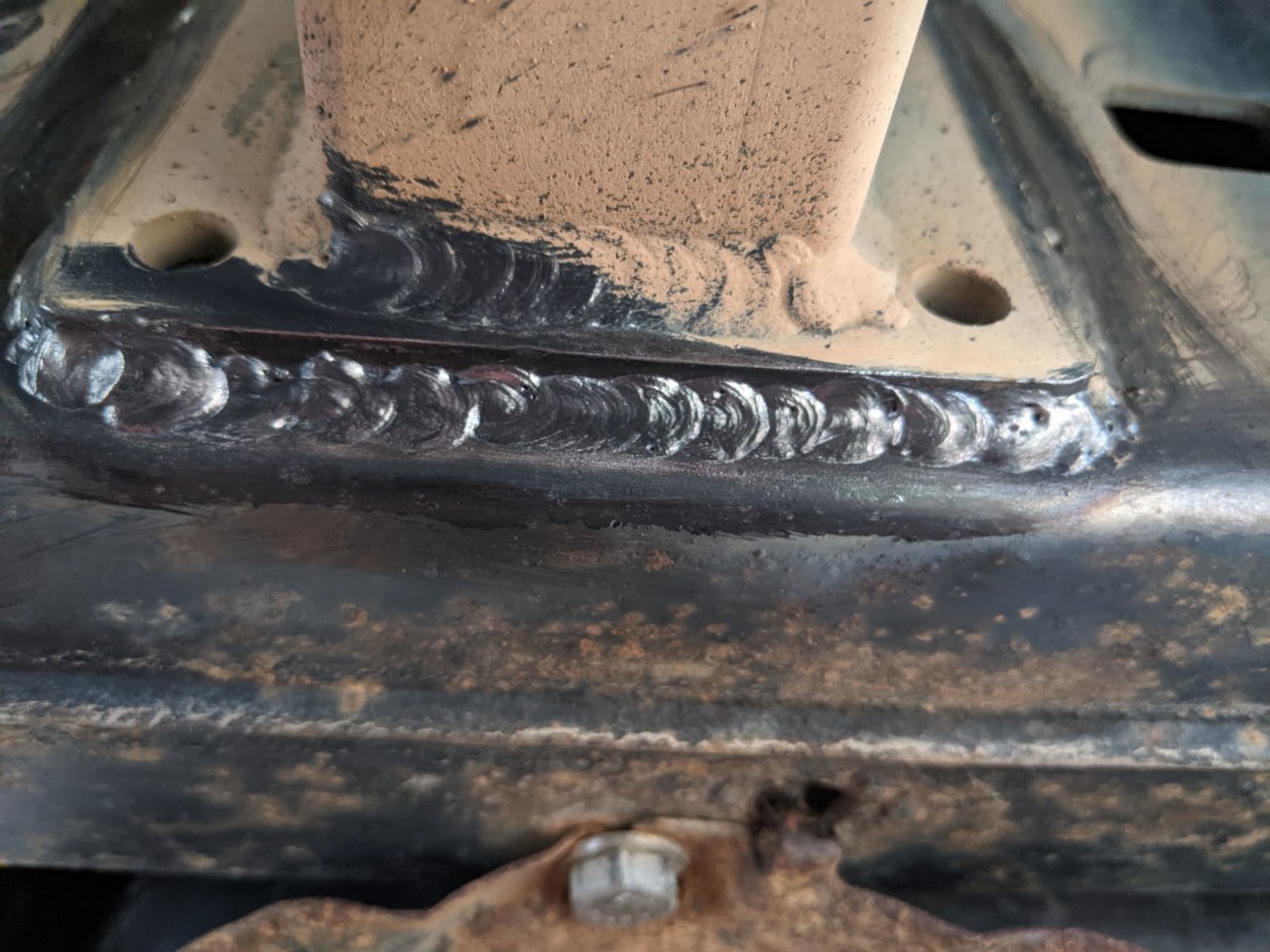

    For the other side, round off the top of each plate. It makes getting the torch in there 100x easier.

    Alright now that is a big brain play. I will have to try that

    I gotchu Holmes but I can’t take credit. My mobtown weld on are like that and it’s a brilliant design.
