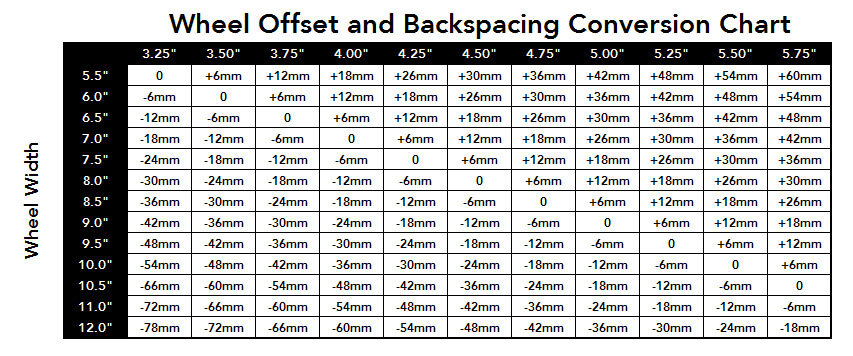

    My wheels are 7.5" wide with +13mm offset, so if my calculation is correct, 7.5" + 1" / 2 = 4.25 plus 13mm positive offset (about 1/2") is 4.75" BS. Previously I had been doing that in my head and coming up with 4.5 so I just realized I have 0.25" more backspace than I thought. That explains why Will's truck had more poke than mine (17x8.5 -10 offset, which equals 4.25 BS); his setup sticks out 0.5" more than mine (without spacers).

    Haha, math. I never do math in public. I use charts like this and say, "Close enough!" :D
    Based on that (not sure if its universal, but probably not), I think you are damn close with your 4.75" calculation.
    Edit: which explains why the -10 at 8.5 Ray10 is 4.30" for backspacing...-12 at 8.5 on that chart is 4.25 or about 2 mm off.

    And why they use millimeters for offset and inches for wheel width and BS is beyond me. Pick one or the other, I don't care which!
    Edit: thanks for the chart, I'm going to save that for reference

    You’re correct that you have 4.75 BS, which means 2.75” front space. (7.5” wide wheel - 4.75” BS)
    Will is at 4.36” BS which means 4.14” front space. (8.5” wide wheel - 4.36” BS)
    4.14” - 2.75” = 1.39” more poke from the scs wheels versus your wheels.
    So theoretically you could add a 1.39” spacer and be at the same exact poke as him.
    Greg.Brakes.Tacos and BTHawk like this.
