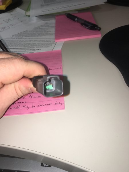

    Who knows about wiring? My fog lights came in and I need some help with some simple wiring. I've never done it before so I'm not sure exactly what to do but I think it's simple. I bought the connectors that connect the light to the stock connectors. I need help wiring the light connector to an adapter that I can wire to the connectors. If that makes sense... Or just tell me what to do too, Its whatever

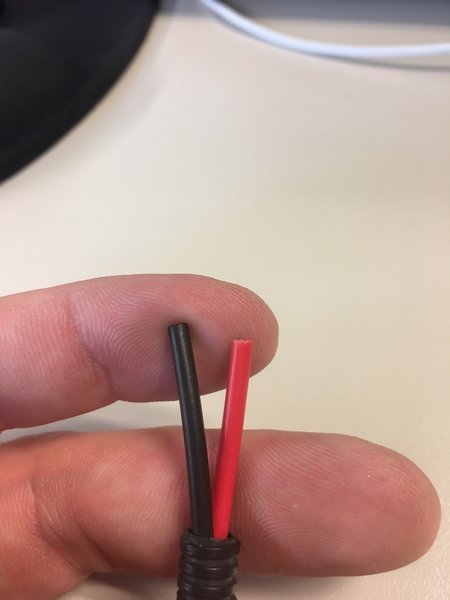

    That I can wire up to here

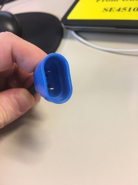

    So can plug this into the stock connection. (Other end of the wires^)

    I guess I could just get the end that plugs into the first picture and wire that up to the wires unless I need more wiring for length.

    Do you NEED to use that connector. Very simple to cut it off, and I have single wire connectors that would be very easy to crimp to the wires. You would just have to unplug two connectors.

    Just make sure if you splice them together you seal them up real good. The tires kick up a lot of water in the rain.

    Buy deutsch connector set and insert/crimp wires into connectors, or cut off existing connector and buy something like butt connectors, crimp, and heat shrink. Like John said, fog light wiring needs to be especially sealed as they are pretty exposed to weather.
