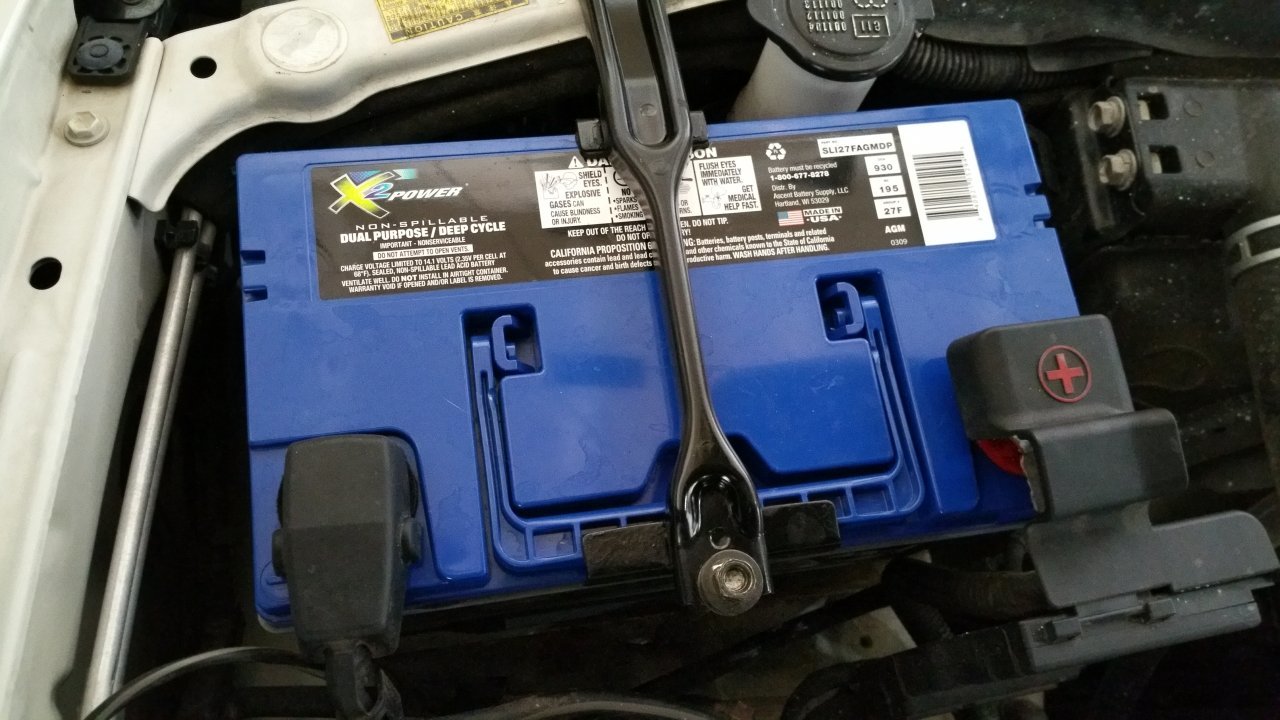

    Ugh... I'm glad you asked. These are on the wrong side... But they have the same one with the terminals on the right side, just make sure you get 27F and not just 27 like I did. I used their vehicle selector, but maybe I went back and picked the wrong one somehow. Either way, the part number for the model with negative on the left side is SLI27FAGMDP, as shown in this picture from ih8mud
    So I just talked to the guy at the store and they're ordering a the right one and I'm taking this one back later.
    I got this tray and cut the little tabs off the sides - https://smile.amazon.com/attwood-Ba...8196785&sprefix=attwood+batter,aps,227&sr=8-2
