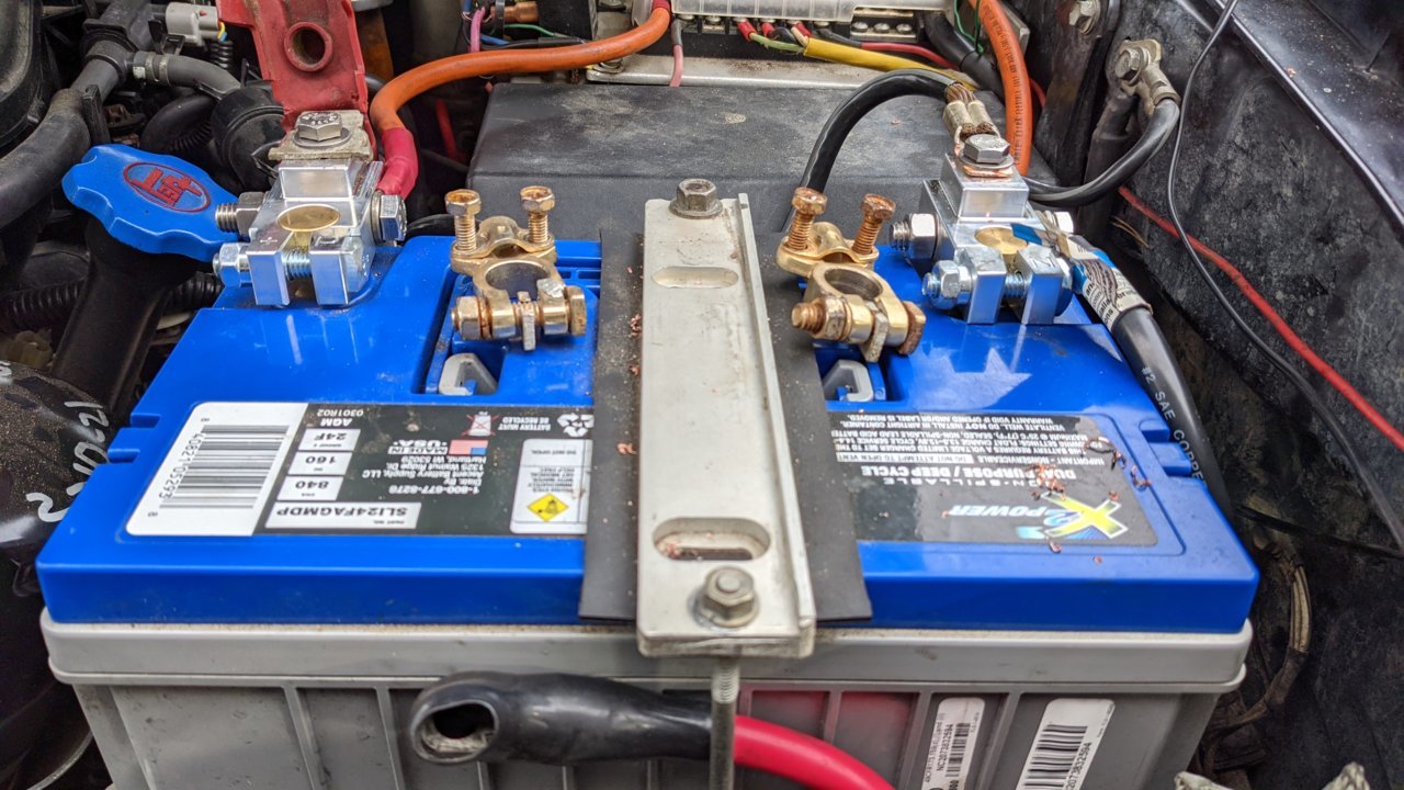

    I mean good info, and you're not wrong, I would also add that Batteries Plus line of "X2 Power" batteries are just rebranded North Stars and carry a phenomenal no questions asked free directly replacement warranty on them.
    Also if you have a 27F and want a Northstar I would advise you to get a 24F as they're still more powerful and have more Amp Hours than a factory lead acid but even the smaller Northstar 24F is heavier than the stock 27F and the Northstar 27F is even yet again heavier which can lead to tearing of the sheet metal for the battery pan, if you need a larger battery do a dual battery set up and position the second closer to the firewall on the PS side.
    Mine from when I did the SDHQ battery terminal upgrade, well worth it especially if you have accessories.
