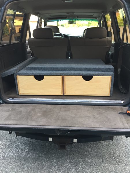

    Ripped out the rear seats since I'll never use them. Still have my drawers from when I had the canopy on my taco and what do you know, they fit like a glove. Just have to trim the side pieces and add a slide for the cooler.
