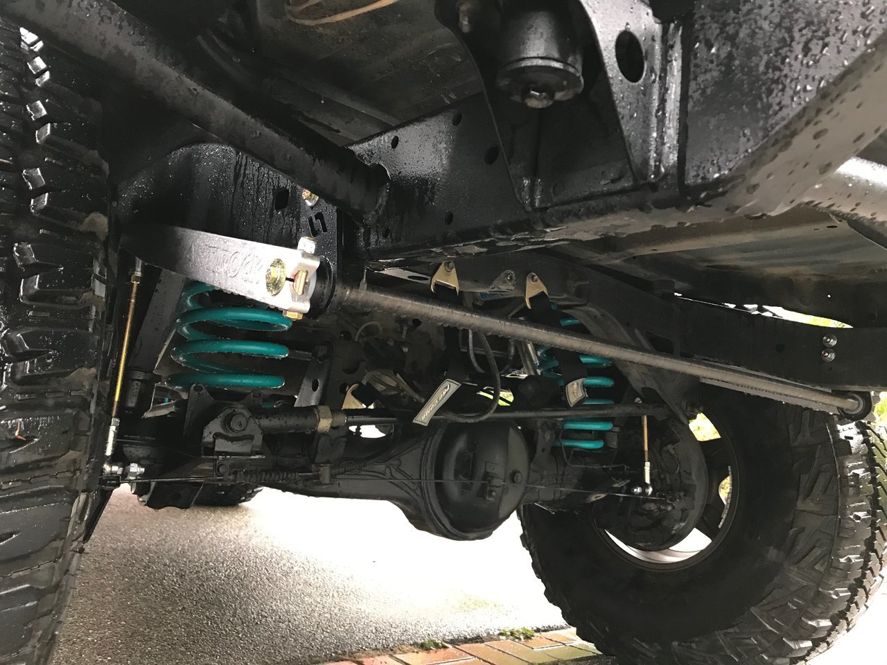

    Currie Anti Rock with Aluminum arms has been ordered. My friend got his done and said its definitely worth it. It does hang down a little but its so close to the tire that it shouldn't be a problem

    Is that a rear swaybar?
  9. Sep 20, 2017 at 5:15 PM
    #449
    NorthwestCruiser
    NorthwestCruiser [OP] Well-Known Member
    Nov 20, 2013
    #117000
    13,081
    Brian
    Snohomish, WA
    1996 Land Cruiser
    Custom 3 link, 40's etc..
    Yup. No room up front to mount one

    Is it going to be that jiggly when it's 3 linked?

    With the spring rates im running, yes lol to be street driveable you need at least one swaybar cause coil springs

    Links are very different from leaf springs.

    That's what I'm coming to understand. The panhard is kind of a no brainer. It makes sense. Rear only swaybar doesn't really make sense.

    Sure it does. The front has an engine which keeps the COG low. The rear has tons of glass and metal and a much higher COG. Not only that you are driving forwards. Inertia is at the back. Look at any race car on an auto cross track and you'll watch the rear wheel lift, not the front.
    And almost every three link has a panhard. Only triangulated three links don't.
    NorthwestCruiser[OP] likes this.

    That all makes sense as well. I've done several go fast Vw's, so I'm pretty acquainted with rear wheel lift. I just always thought rear only swaybar would increase under steer. Probably wouldn't matter that much on big ol LC on 40's.

    Sway bar in the rear keeps the ass planted with predictable oversteer rather than snap oversteer. Sway bar in the front...understeer.

    I guess I've had it backwards all these years.
