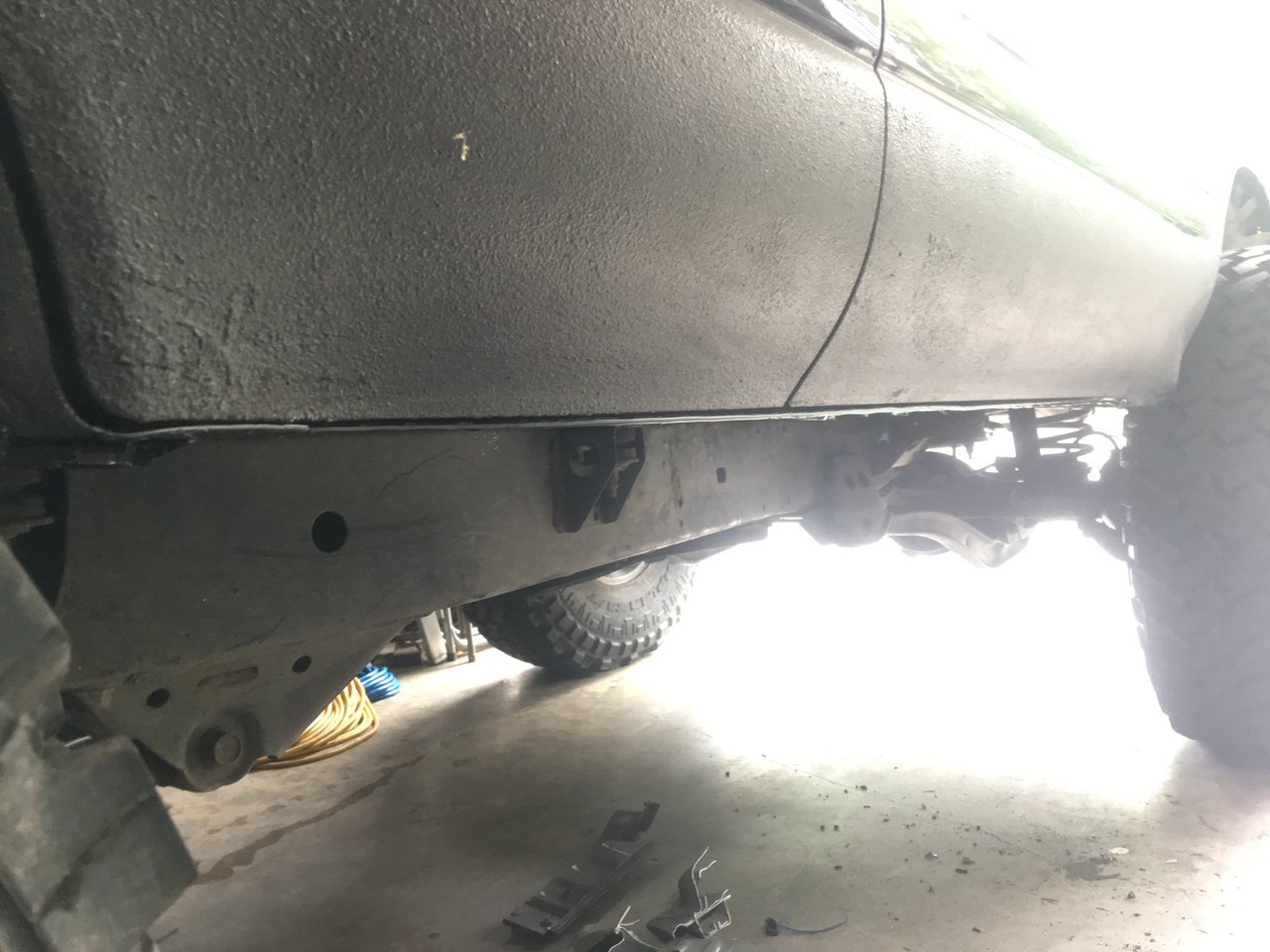

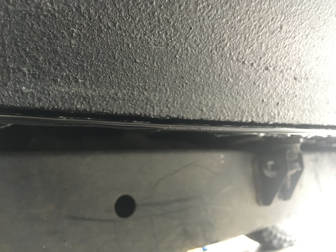

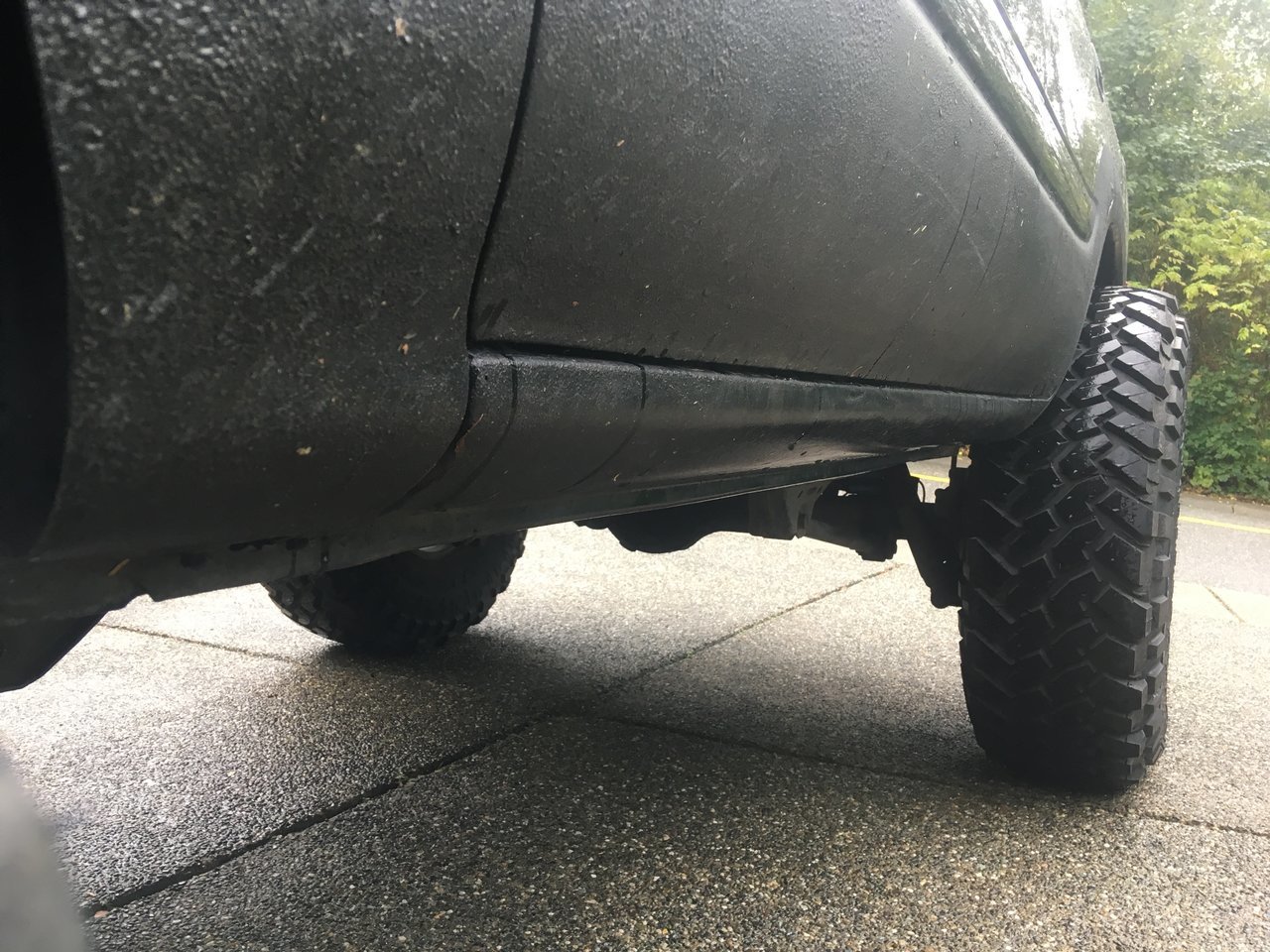

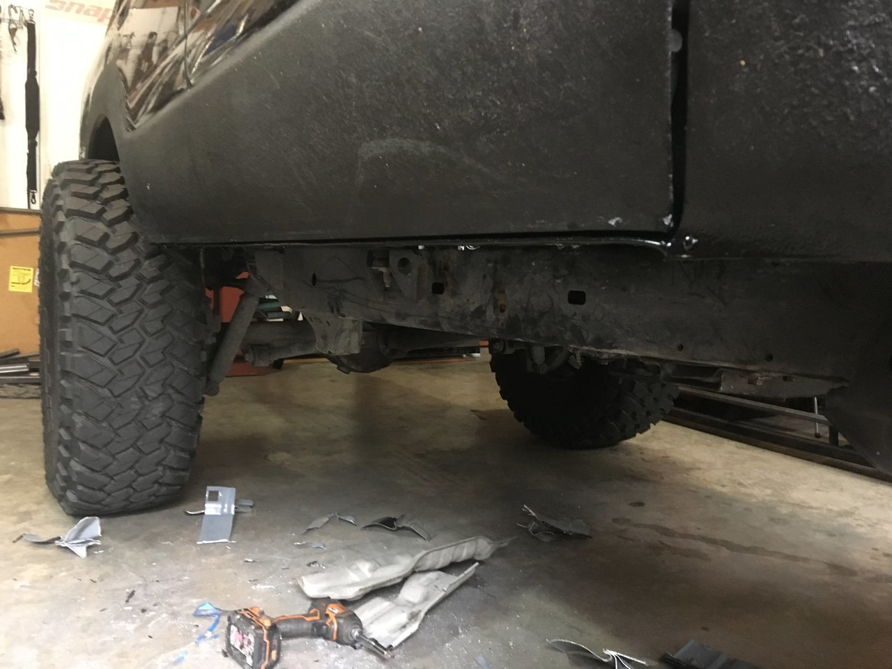

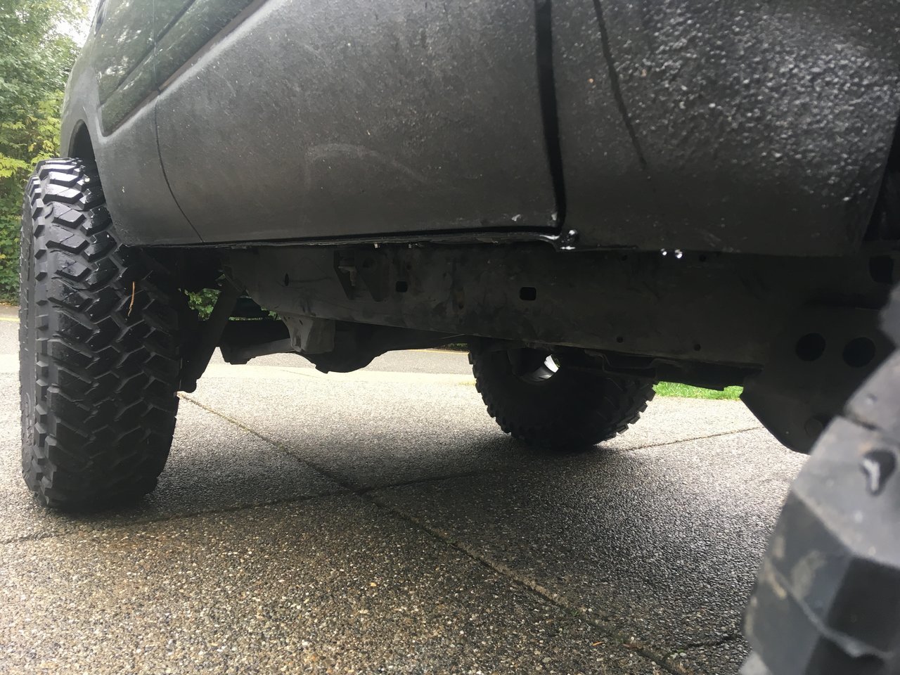

    Circumsision complete! 5" of clearance with the rocker cut

    Going with 2x4 or bigger?

    2x4 3/16" wall

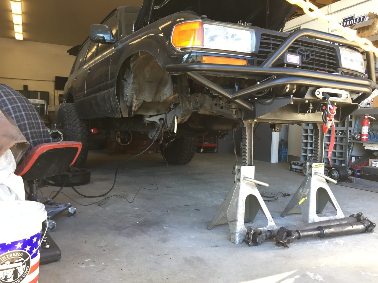

    And off we go! Heading down to Bremerton to be linked :yay:

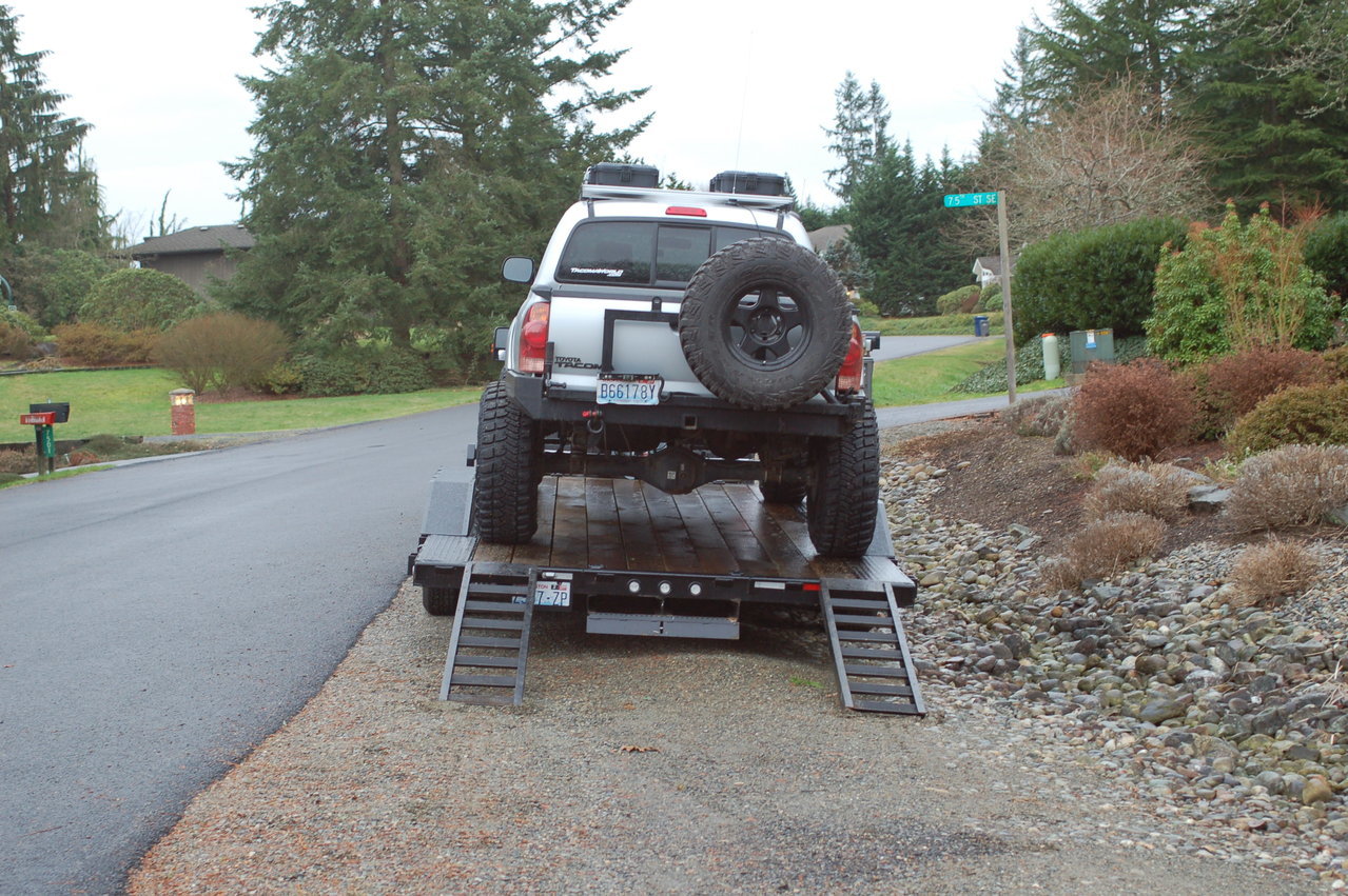

    Holy shit it does fit on your trailer. Thought it would be wider than your taco

    It is. Taco was 84" this is 86" track width. Thank god I got drive over fenders so the deck is a full 102" all the way around, normal flat bed decks are only as wide as the width between the wheel wells

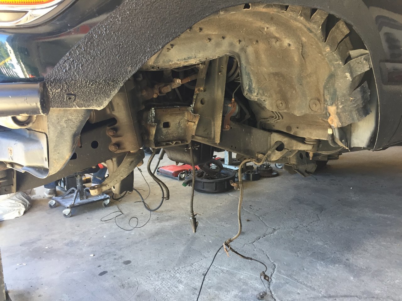

    Progress is going pretty well. They had a problem with their plasma cutter so set back a little
    Rear is done besides limit straps and bump stops

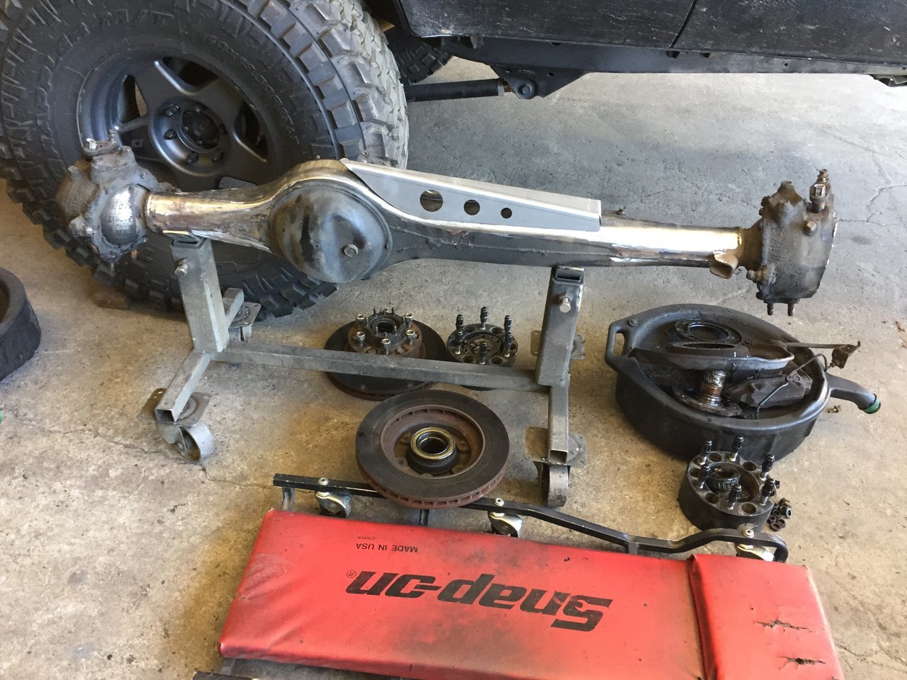

    IMG_8528-1.jpg Axle truss was advertised for an FJ80 but really is for a mini truck so slight modification to make it fit well..IMG_8527-1.jpg
    And the last bit to cut off
    So not only do 80's have fully boxed frames they are also double walled on the outer wall! Did not know that

    Diffs are dropped off to be regeared to 5.29's and ARB's. Also finally picked up my rear shocks too

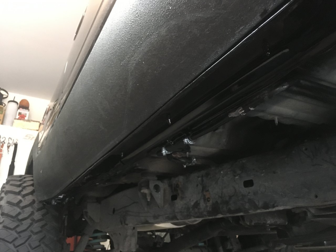

    Got any more pictures of the rocker cut?

    Sorry if this is a stupid question, but what's the reason for the rocker panel cut? More clearance?

    Are you going for a weld on -- almost integrated slider -- by chopping that much off the rocker?

    Much more clearance under the door. I probably gained about 5". This way the rock slider can be mounted higher and won't get hung up on as many rocks.

    Yup. It'll be 2x4 square main tub that'll sit right up under the body with normal 1.75" DOM outer tube

    How bout a freakin update?! What did your fab guy do with the drains that drain into the rocker panel?
