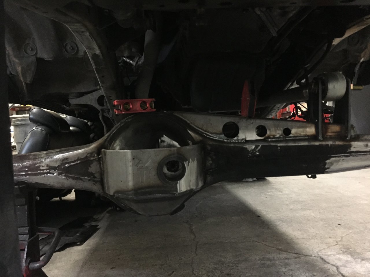

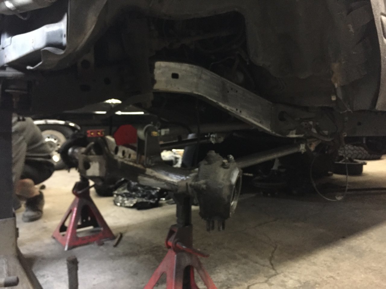

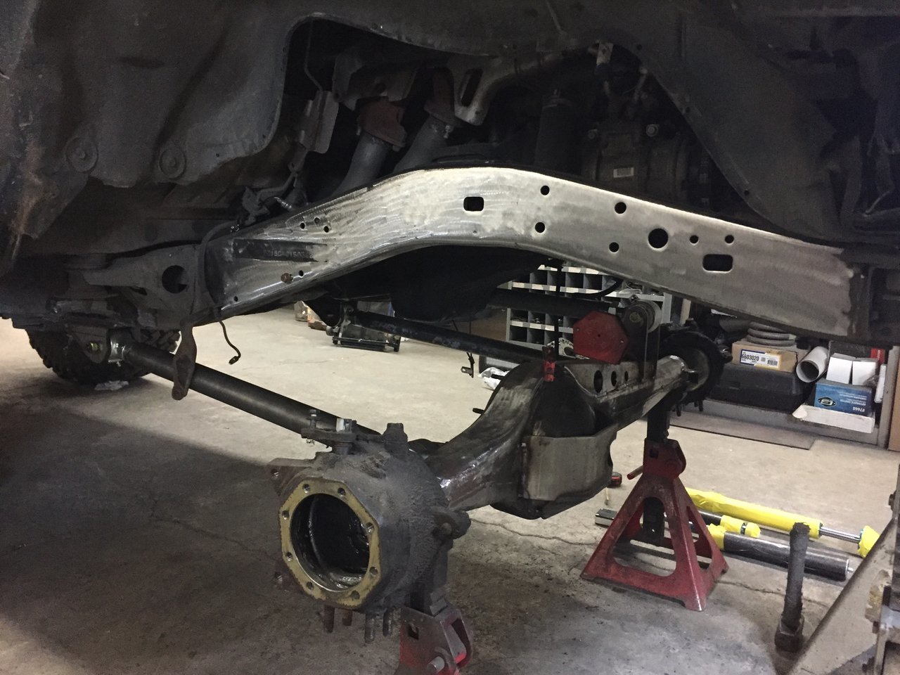

    Links, axle truss, and diff guard are all done (besides full welding some of it). Frame plating, towers and panhard are next. Then just a lot of little things are left. Probably about 1.5 weeks left until it's completely done.

    Are you having them rebuild everything too? (new bearings/seals). Just seems weird they left the knuckles on when they are all of like 8 bolts away from taking them off lol.
    I am a bit surprised they didnt at least pressure wash things before they started. Looks like a ton of dirt they could have gotten off with a few minutes of a pressure washer.
    Still looking good though!

    Yeah they will, picked up the rebuild kit from torfab. Also new wheel bearings and rotors.
    The knuckles were leaking so badly. I doused them in simple green and degreaser and pressured washed them after I bought it and they still ended up like this.

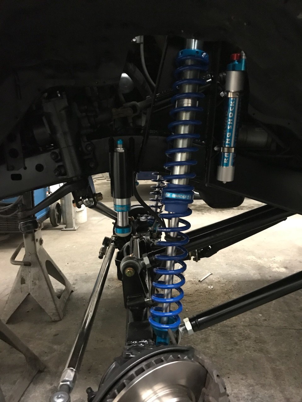

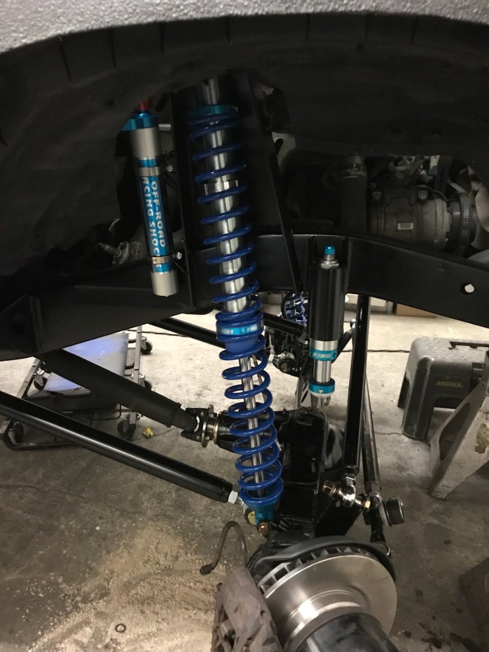

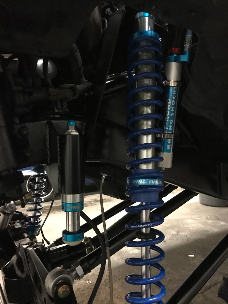

    Final assembly is happening :woot: should be on it's on weight by the end of today. Should be getting some pics once it's the coil overs/axle/links are all back in.
    Still have brake lines and a lot of small things left. Assuming PRP limit straps arrive today or tomorrow I should be picking it up Friday

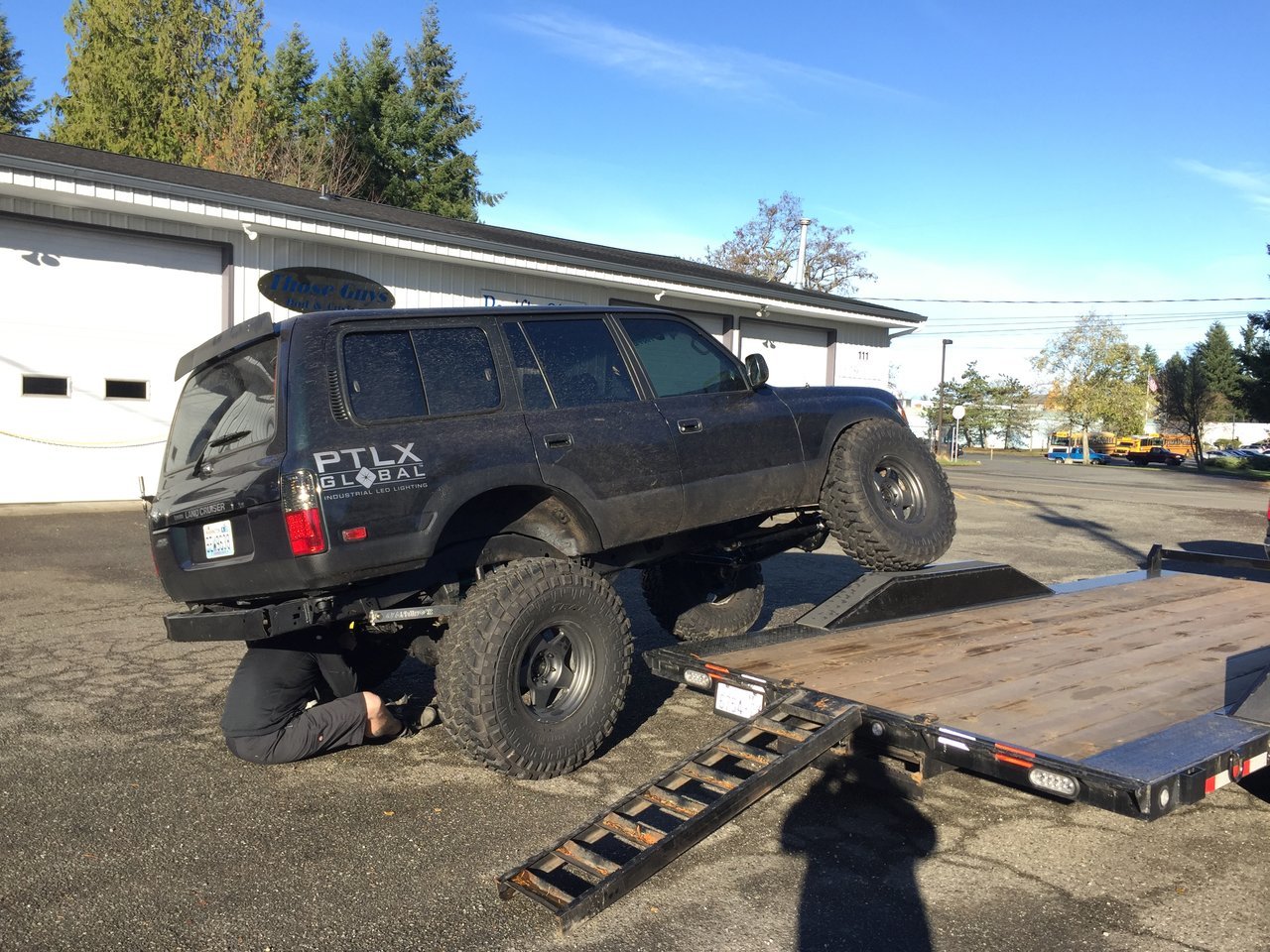

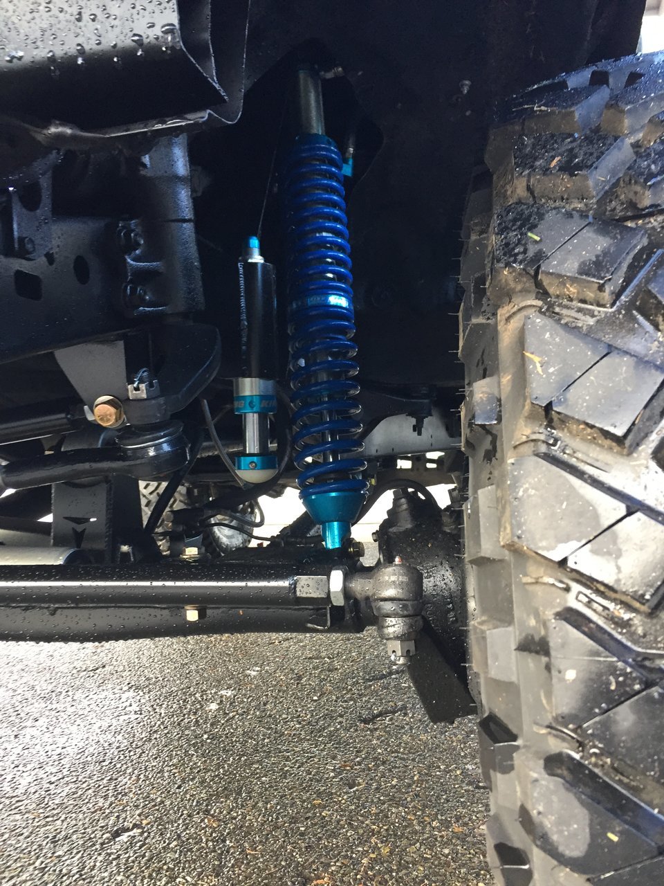

    Was too excited and had to flex it so had to use my trailer..
    And currently:

    Oh forgot to say @Acerwin its a 24" frame height on all corners

    Nice. I’m hoping to aim for that.

    So fracking awesome. Do the tire still rub like crazy?
