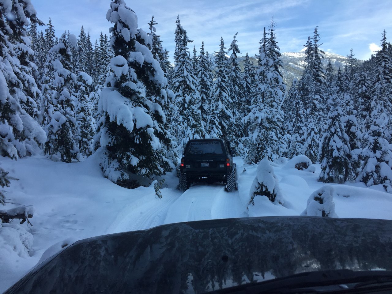

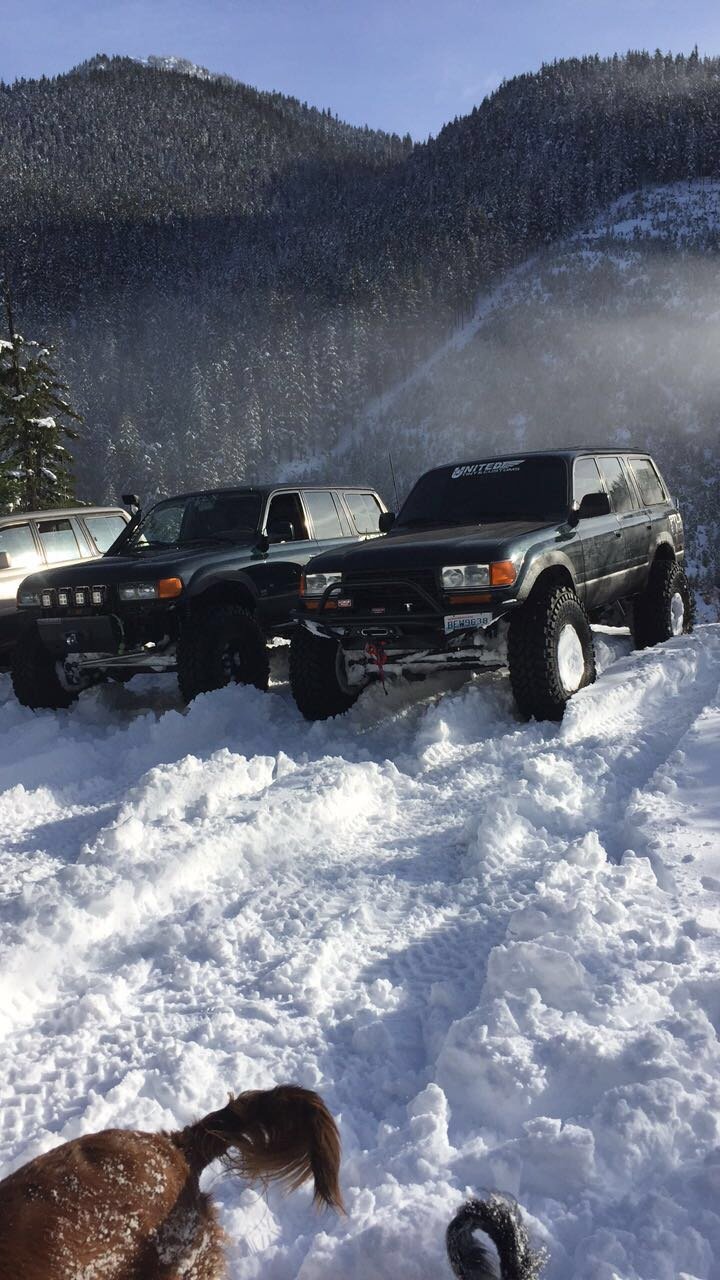

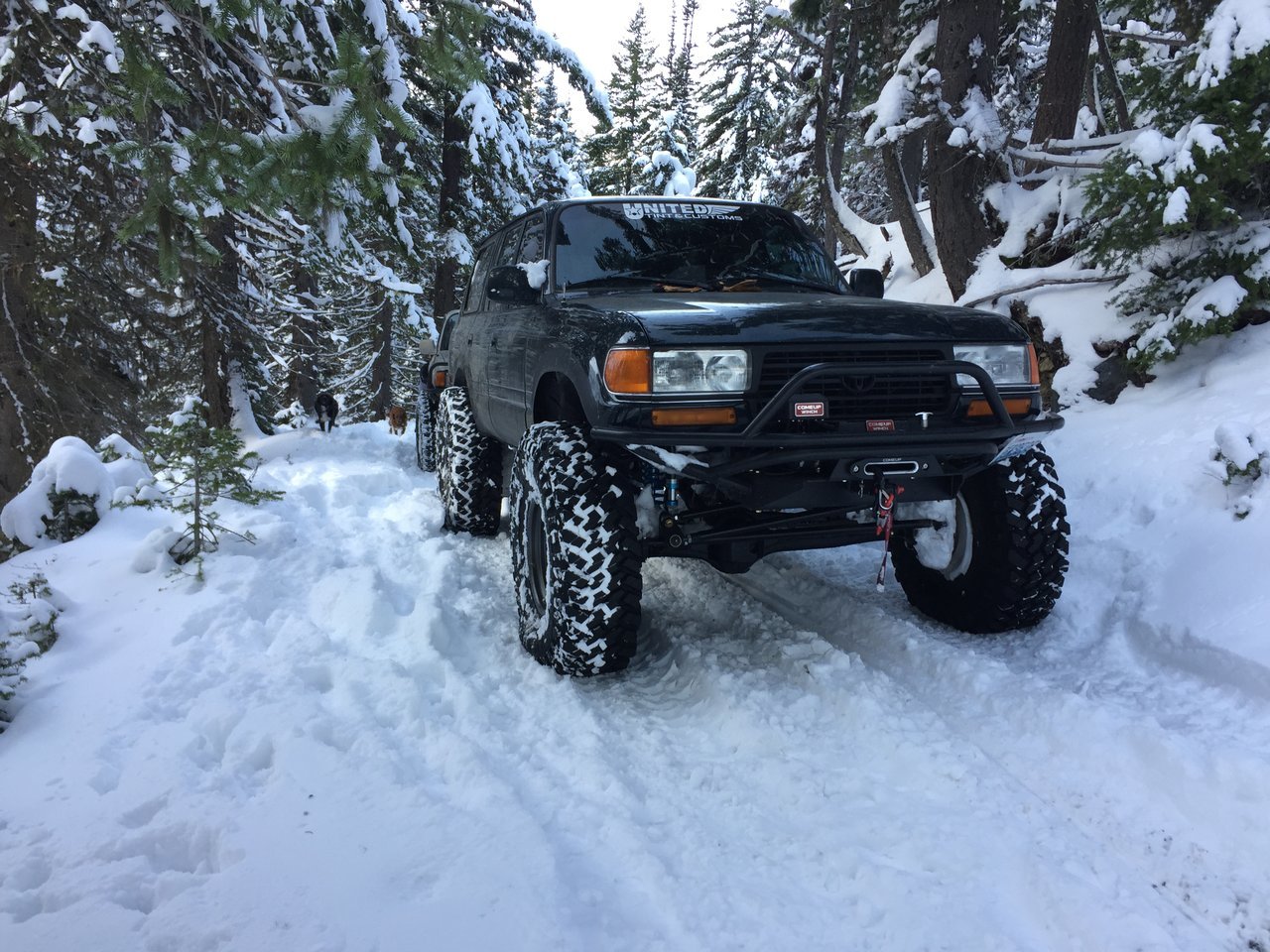

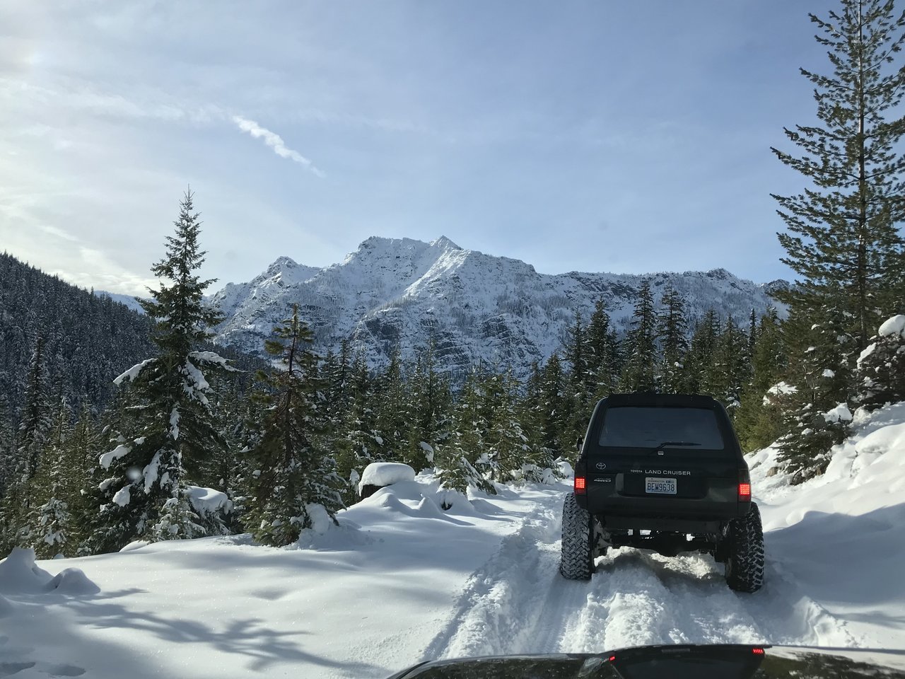

    Turned around here. Snow was about 2ft and the 2 trucks in front of me tore it up pretty bad. It all got pretty packed down from the trucks in front of me and snowmobiles

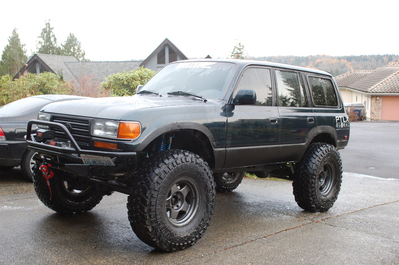

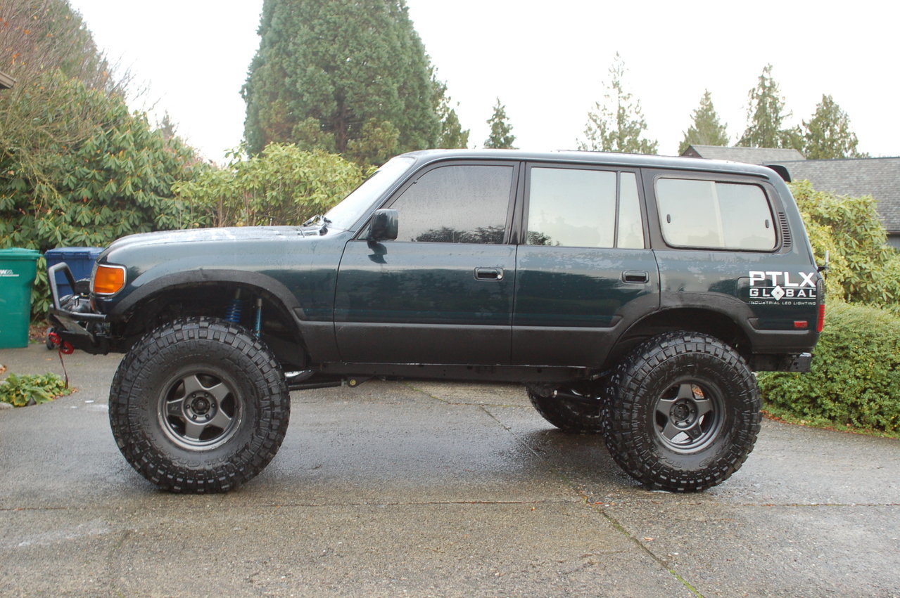

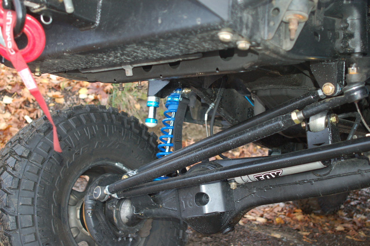

    Okay so had some things to tweak and washed it up for some pics.
    Just got done cutting another 1 3/8" out of the fenders up front. Can adjust the bumps now for some more up travel
    Front end:
    116" wheel base. Moved the axle forward 1"
    14" 2.0" King coilovers with resi/clickers custom valved
    King 2" air bumps
    Ruffstuff 1 ton Y link steering
    Fox Steering stabilizer
    High steer
    RCV axles
    Trail Gear diff guard
    Tral Gear 3" wheel spacers
    Low Range offroad axle truss
    Custom 3 link
    Complete axle rebuild
    PRP limit straps
    Slee extended brake lines
    Ballistic fab joints
    Nitro 5.29's with ARB locker
    Rear:
    Rear rockers/fenders cut/plated
    Dobinson 3" progressive coils
    14" 2.5" King's with resi custom valved
    Metal Tech rear Links
    Iron Man panhard
