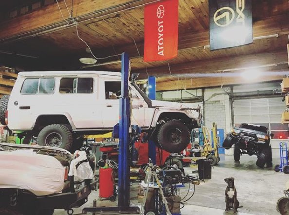

    But my friend Nick who's the lead tech at Torfab knocked out my Tcase gears early this morning and flexed it out, pretty cool pic! Featuring 70 series Troopy and Ruger
